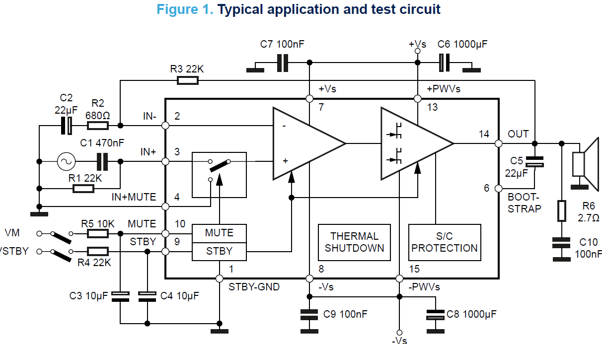

In an old active three way loudspeaker of a friend one of the TDA7294 has firmly blown a hole in itself. No apparent cause. After cleaning the board from black dust, the surrounding standard components on the standard pcb layout measure fine. The mute is not used. The loudspeaker unit of this mid channel measures ok.
After replacing the TDA7294, an offset of 0,4Vdc appears (input shorted). It can be traced back to the IN- by measuring the voltage at that input in relation to ground.
Without power supply R3 = 22k measures fine.
The other two TDA7294 on the pcb of this loudspeaker measure fine, hardly any offset at the output.
The voltages of the power supply are a stable + / - 25Vdc. The scope shows no sign of oscillation.
What may cause the offset of 0.4V ?
On the positive input no voltage to be measured. I have measured all components, including R1 and C1, with a Hameg component tester. The resistors were with measured with a BM869s multimeter. No odd outcomes.
When replacing the chipamp, all traces on the pcb were checked for shorts and cleaned from flux residues. The layout is the same for all three amps.
The new TDA9472 being bad is indeed an option. A bunch of them were ordered in order to have some spares at a reliable source, Reichelt in Germany.
Before putting in a new chip. just changing the external components may be interesting. R3 = 22k can measure ok without power on, but the resistor can be stressed when the chip blew. If so, it may show odd behaviour under power. When under power now, a voltage of 20 mV across R3 can be measured.
Would it yield additional information when simply removing R3, and have no feedback.
But, will the TDA7294 be stable without R3?

I had same issue with some TDA72XX. Where I live there is no cheap way of making sure the TDA is original and I had the high offset issue in some new and replacements I did for my self.
Similar offsets of 300mV, 400mV etc.
I added 2 resistors from a DC filtered source in the + input so as to insert a small DC bias and I could bring down the output offset to something acceptable. Just take the DC output value divide it by the voltage gain and you'll get the oposite DC signal to be inserted in the inputs to compensate.
Thanks for thinking along by sharing your viable solution. It may be the simplest way to solve the issue, as again removing the chip is not beneficial for the pcb traces. Even with using low temp chip quik solder. In first instance, a trim pot will come handy to find the right value in a voltage divider.
