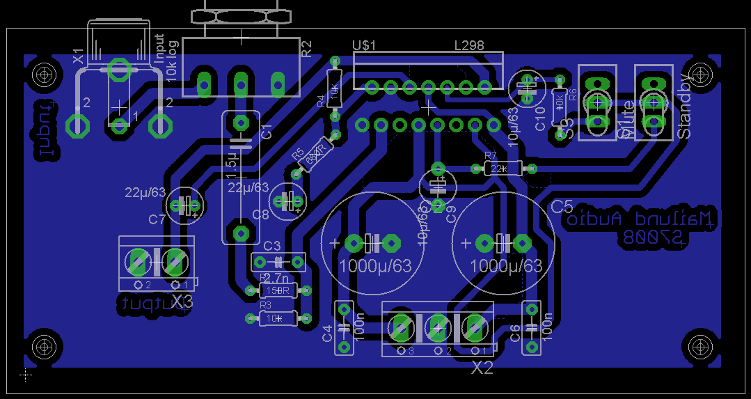

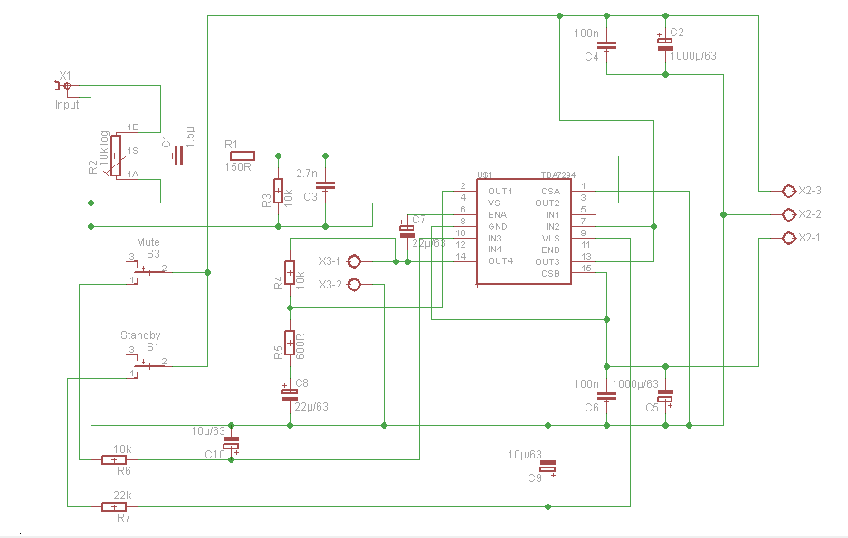

I have been building a subwoofer plateamp based on the TDA7294 chip. I have read a lot about the chip on this page and others, but haven't found the reason for my problem still.
There is simply no output from the amp! Only a vague humming noise from the speaker when i put my ear very close to it. Flipping the mute and stndby switches dosn't seem to change the humming.
Measurements:
V+ = 32.8V
V- = 32.9V
Mute/stndby pin both > 25V
No DC offset on output
So what can it be? I have attached a schematic and PCB drawing
Please help !
-Mads
