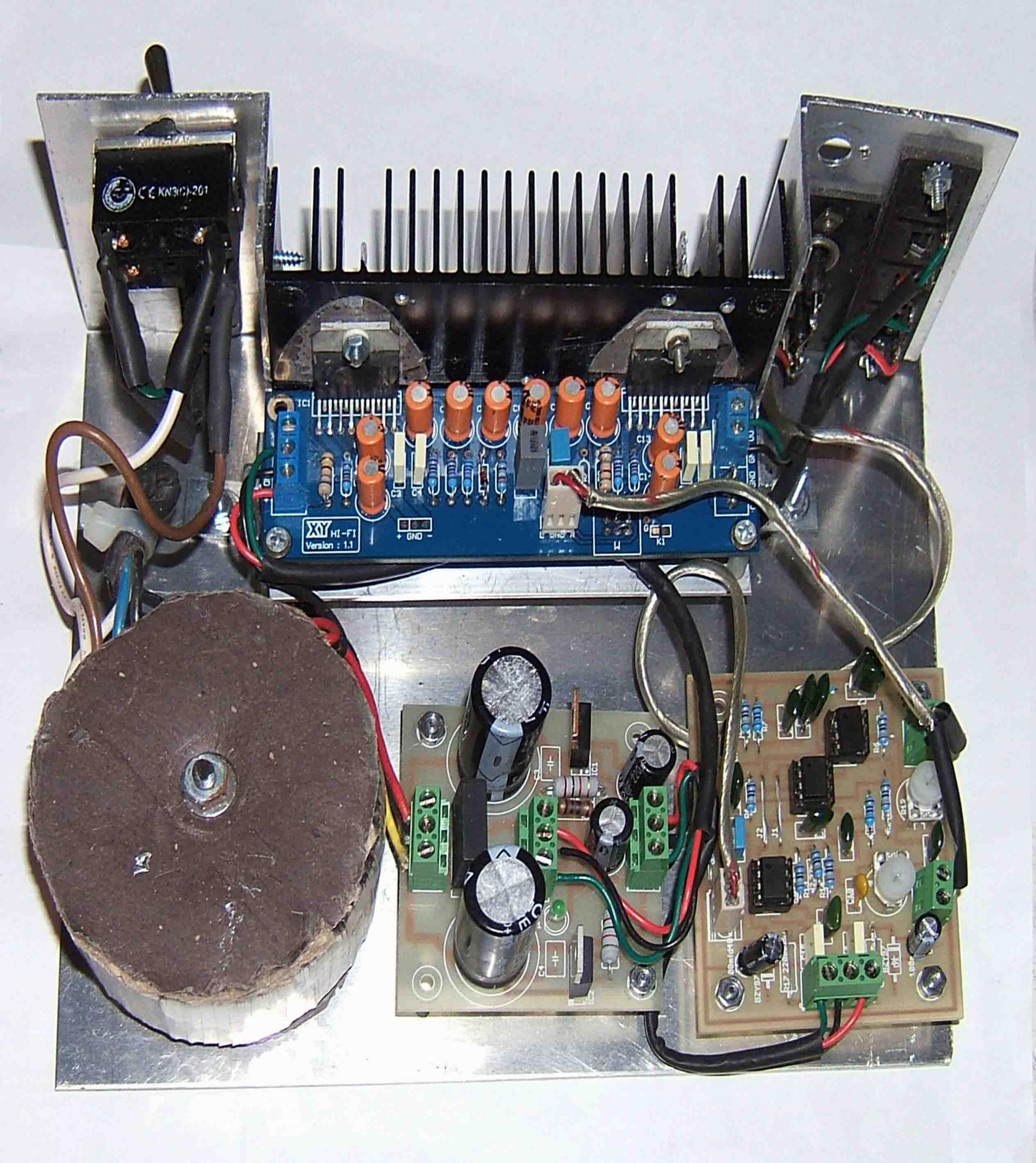

My first Bi amped amplifier
My first effort was an adaptation of a Elektor circuit for the filter a 3rd order Butter worth filter made with transistors driving TDA 2004 amps .This circuit was published in an Indian Electronics magazine
The block diagram of the Bi-amp is shown below

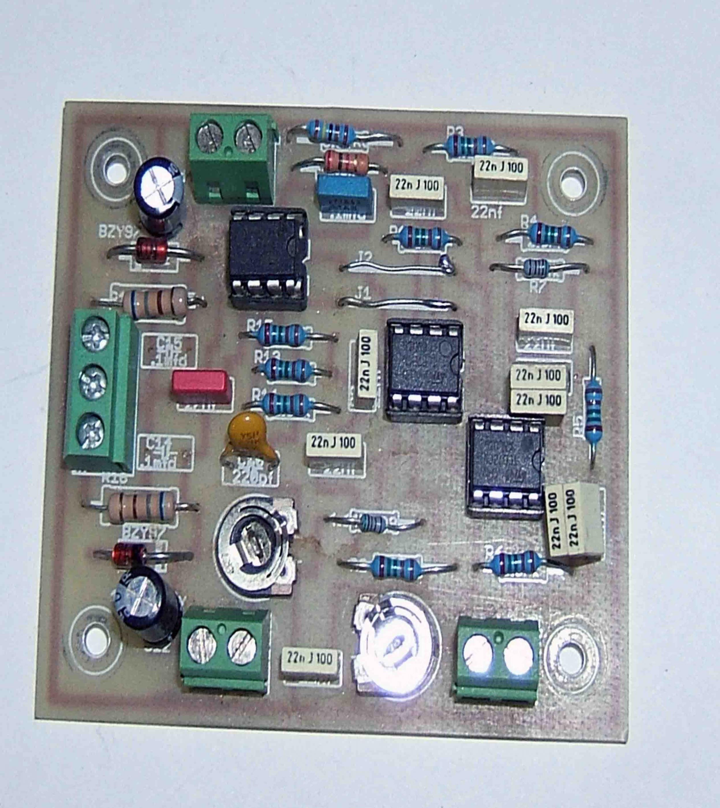

Sallen and key filter
I adapted the circuit and made the PCB shown below in it,s populated form
Details
Board size 2”X3.5”
IC-TL072
Crossover frequency- 1500 cycles
Slope- 18db/octave
Details
Board size 2”X3.5”
IC-TL072
Slope- 18db/octave
Input voltage- +- 15v to 35v DC

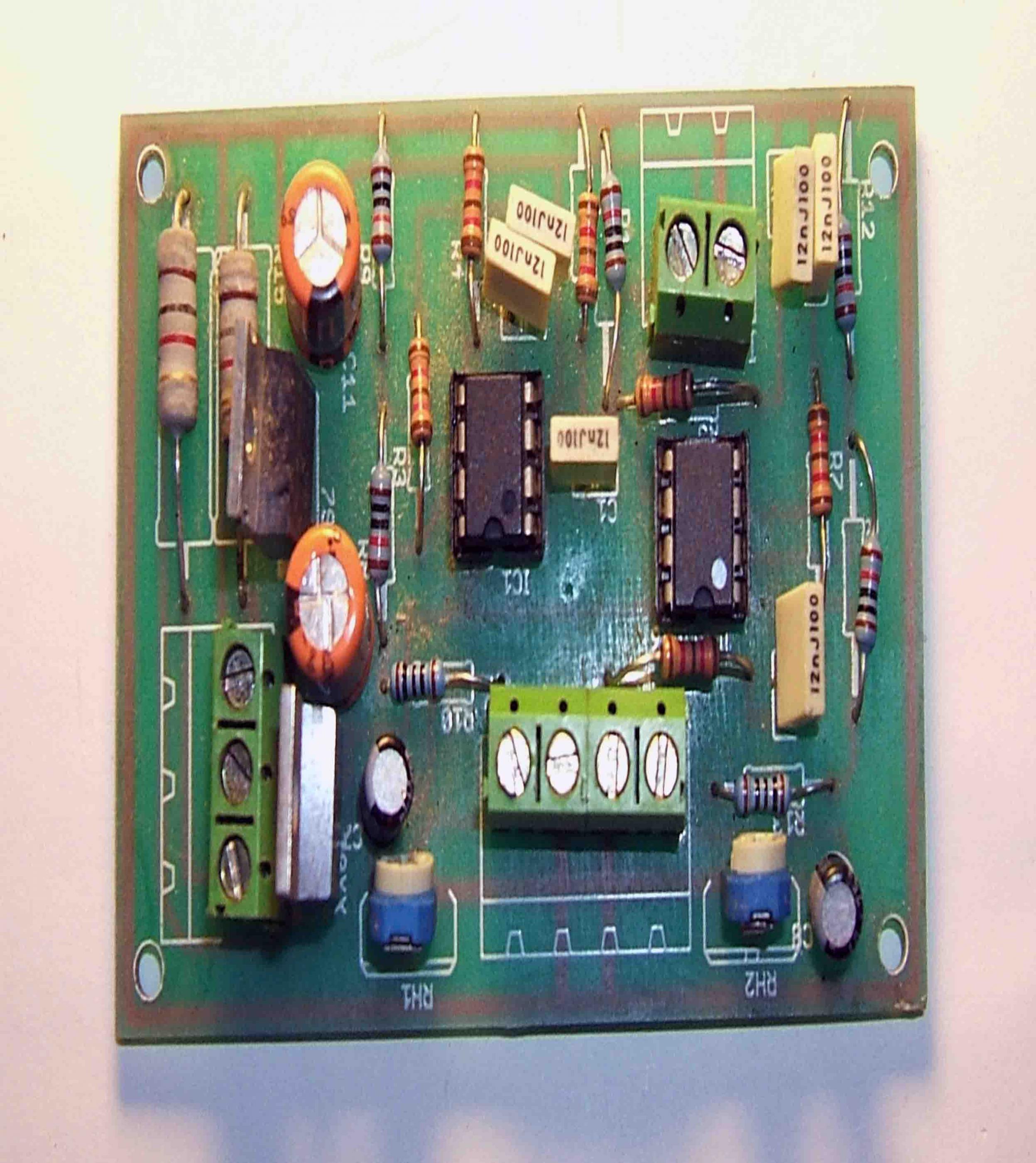

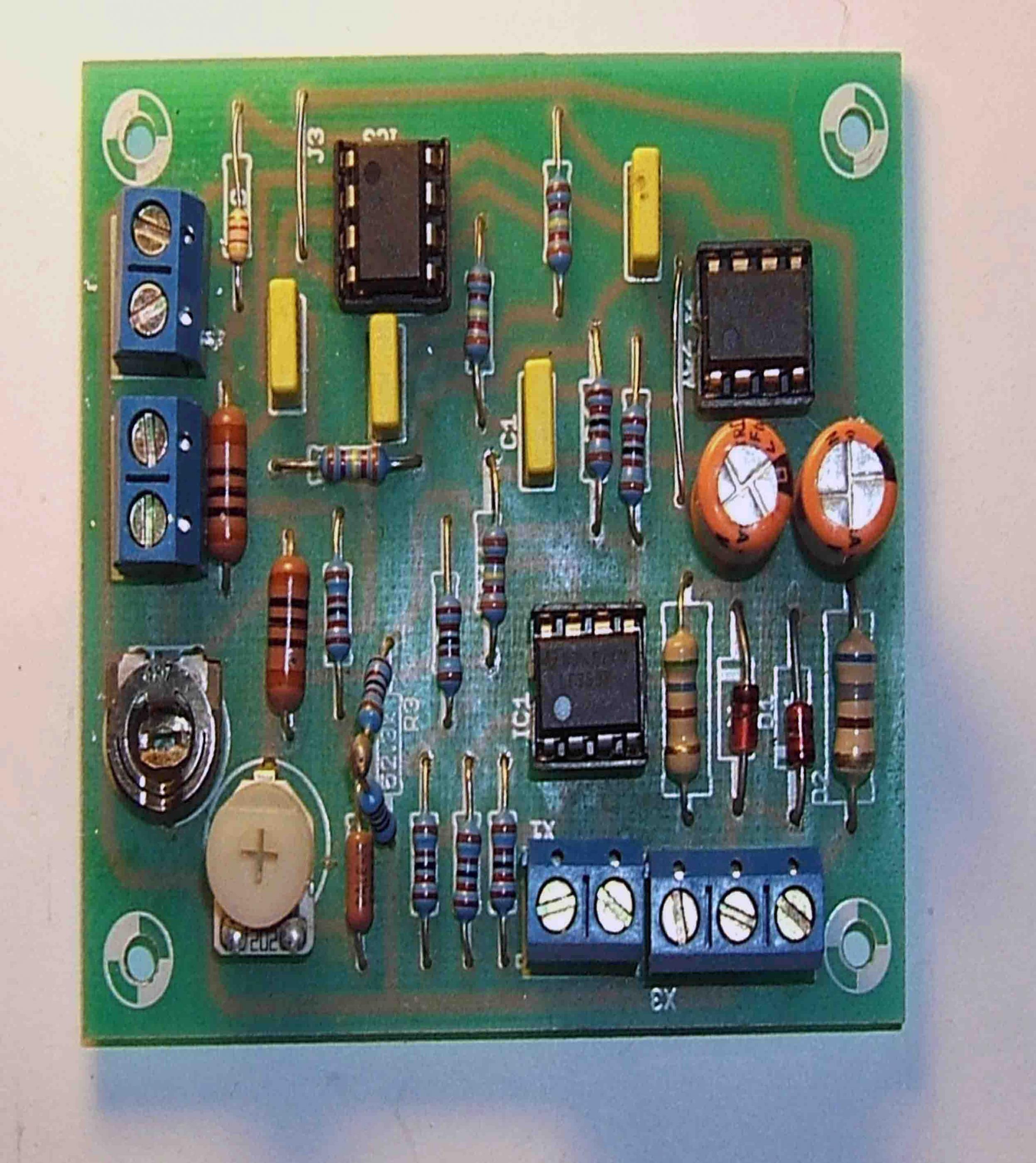

Which of the filters are the better of the three. Each of them have some advantages
Sallen & Key
1) Small PCB
2) All resistors and capacitors determining the frequency have equal value and hence easy to procure
Linkwitz reilly
1) Has baffle diffraction,all pass filter and is 24db/octave
2) The best sounding of all three
State variable filter 24db/octave
1) Adjustment of the frequency is dependent on only four resistors
2) Can adjust for the hump occurring at the crossover frequency
Sallen & Key
1) Small PCB
Linkwitz reilly
Hopefully you are aware that the crossover frequency, baffle step and delay should all be designed depending on the actual drivers and enclosure specifics. You can't just use whatever you feel like for optimum results, and unless you do your maths and measurement right, you won't be able to do any meaningful comparison between the crossover types.
Other that that, if you are looking for optimum on-axis response, your best bet would be Linkwitz-Reilly as it provides proper acoustic summing, ASSUMING the proper crossover frequency and if necessary all-pass delay has been used (although it's better to mechanically put the acoustic centers of the speakers at proper distances than use electronics to fix this), also for proper frequency response baffle step must be considered and this depends almost entirely on the width of the enclosure. All that being said, it's not the optimum crossover for all speaker types and uses.
It might also interest you that there is a kind of state-variable derived crossover that has 'perfect' phase and impulse response once the signals undergo proper acoustic summing. It was published by National Semiconductor in one of their application notes, IIRC you can still find this on the net. This crossover works very well but requires careful selection of drivers and optimization of their positions on the enclosure - it works particulairly well with coincident drivers, such as the KEF uni-Q series and other similar co-axial types.
Forget the discussion about Optimum Filter. As ilimzn alsready mentioned driver SPL and BS must be accounted for in teh filter. It is the acoustic (=driver+filter) filterd output that is supposed to have a LR , BUT or whatever chosen characteristic.
Electrically perfect LR (or BUT or whatever filters produce horrendous results when combined with real drivers in a real enclosure.
So get the combined responses right firstly, which is a formidable task in itself, before discussing various topologies.
