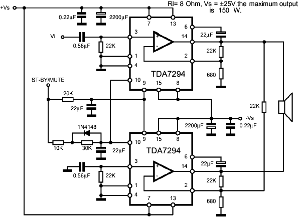

HI,
I intend to build this circuit for my stereo amp. each channel will consist of 2 tda7294 in bridge mode all i need is pretty pcb for this circuit-or i`ll have to build it on general purpose board..lool- & any one have any comment or modification about the circuit i am glad to hear it...
I will use 24-0-24 10 amp. transformer
2 * 8 ohm speakers
and this circuit for tone control
THNX,,,,

24 Volt transformers will result in rails of about 33-35V depending on mains voltage. You risk frying the chips with that voltage and that load. For 25V rails I would use 18 or 19V transformer.
Using a single resistor to bridge the chips will work, but I don't know that it is ideal in terms of performance. It might be worthwhile to explore a dedicated balanced line driver chip or use the second amplifier in inverting mode with a few suitable modifications in the gain resistors.
Good Luck.
use a 18V transformer, better for the chip :p
and design a neat PCB for it, a good amp deserves it imho
but TDA7294 amplifiers are very good, i personally like them more then the normal lm3886.
but for power supply, a good 2 * 18V transformer, 225VA per channel, and 20.000uF per channel for capasitors.
now build it and be amazed :D
