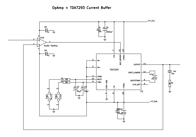

Hi Panson - like Charlie I'm also happy to see more progress on this. I'm also running a project on TDA7293 at the moment. I found a couple of things out about the buffer which might interest you. Firstly remember that high open loop distortion you showed a while back? I think I found one of the reasons for it - the positive side gain is substantially less than the negative, giving large amounts of 2H. The fix I'm trying is to run bridged.
The second thing I noticed is the input impedance to the buffer (at pin 11) isn't high. I haven't explored this much further, but I wonder if its caused by the current source from the positive supply shown in the internal schematic. About 1.5mA seems to flow from the positive supply pin (pin7) to pin11. I plan to try an equal current source to the -ve supply to mitigate this.

Its a personal project which I'll make available for anyone who's interested, commercial or not. So its a bit like 'open source' except only for interested people rather than pushed out into the public domain. That is always assuming that it works! Yes, I am all for understanding these chips to our best abilities - your measurements certainly helped with that.
I do have one other suggestion for your earlier schematic, and it relates to power supply cleanliness. With the external opamp you have the option of much smoother supplies to it than is easy to achieve with the TDA7293's gain stage. While smoother supplies don't show up in sinewave testing I do have a hunch they contribute to better sound. You could try some LCLC filtering to the opamp's supplies.
Hi Richard,
Thank you for your comment. I will try passive filtering and linear regulator.
Panson
Panson
With the Parallel TDA7293 board, I'd be interested to set Both chips to slave mode and then drive the board with your voltage amp instead of the TDA7293's built in voltage amp.
Perhaps there would be an imaging improvement from using your external voltage amp to drive the TDA7293 power buffers.
