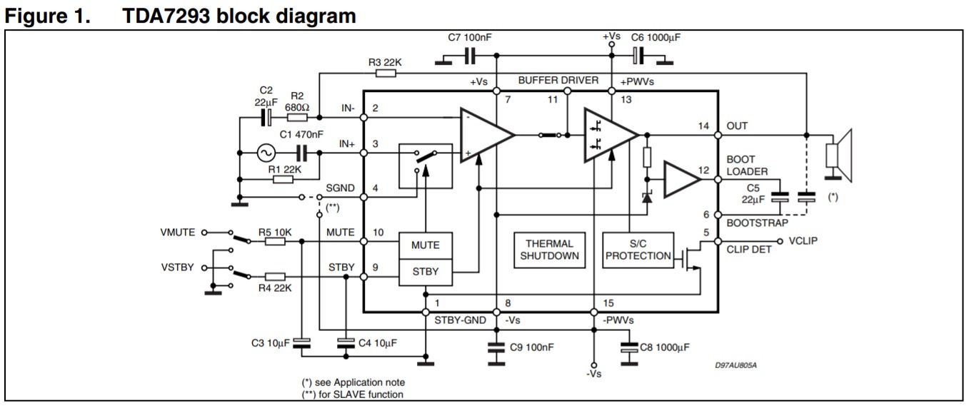

Good evening gents,
Apologies, posted initially in the wrong place - will get the hang of things.

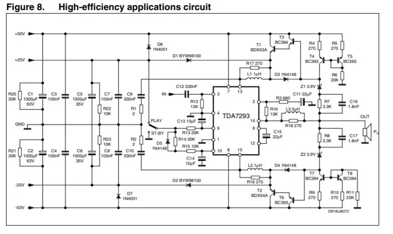

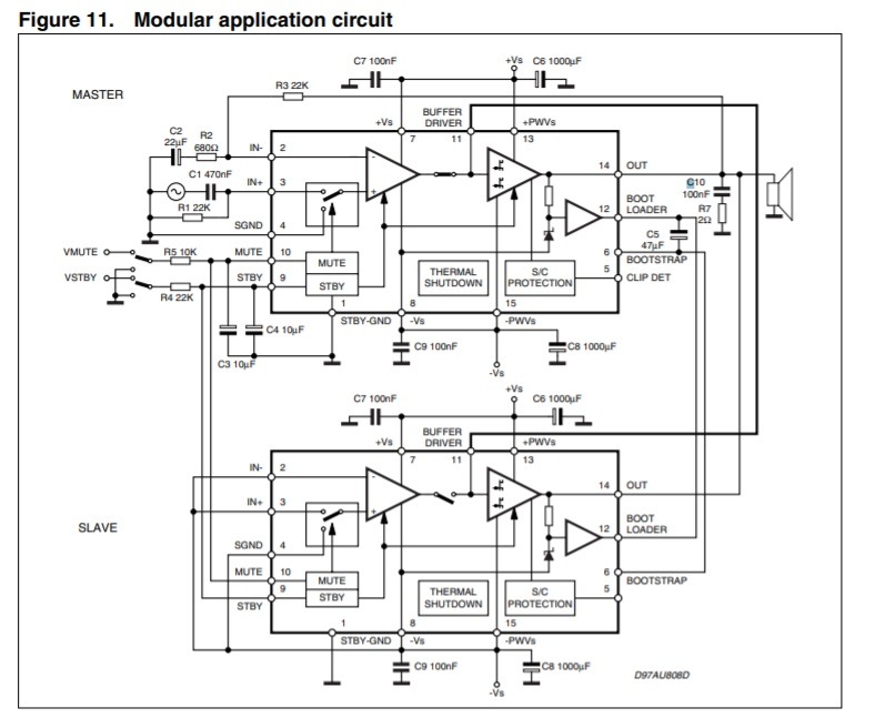

I'm laid up, no driving licence for 'dicky ticker' reasons' from October so I'm crawling up the walls. I have a weeks holiday at Christmas so I thought I'd get on with an audio project. I have a Rega record deck gathering dust on top of the wardrobe I thought I'd have a go at building an amp, not from discrete components I hasten to add. I've spotted the TDA7293 which seems ideal as a basis for this and studied the data sheet which has a couple of example circuits one of which is described as a TDA7293 block diagram. This diagram appears to relate to a PCB layout and is quite straightforward ie few components.. Is this a working circuit, I thought I'd knock it up over Christmas well at least the PCB. There are a couple of other circuits (modular and high efficiency) which are also on my radar although the component count of one is far higher. What are peoples thoughts on the circuit I should go for. Thanks in advance.
