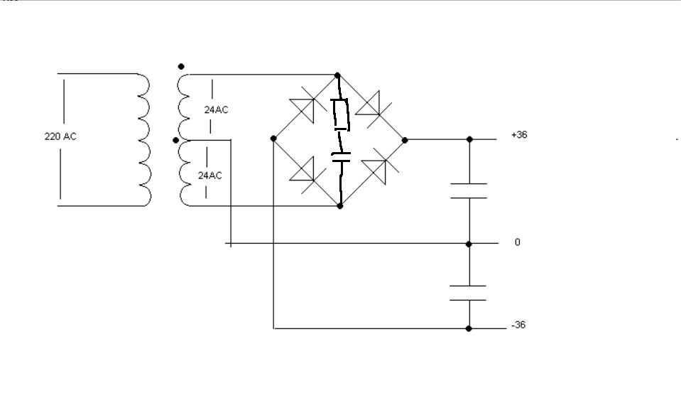

Everyone has there own ideas... I would suggest somthing like two 4700uf to 6800uf reservoir caps and also a simple snubber network of a 0.1uf 400vac poly cap in series with a 4.7 ohm 1 watt resistor connected across the combined secondary winding of the transformer (so that is across the input to the bridge)

Caps on or before the bridge are to stop "ringing" caused by the commutation of the bridge as it comes in and out of conduction... remember I said earlier that it was non conducting for most of the time... it is that switching each cycle that can cause the ringing in combination with the inductance of the transformer.
One cap and one resistor is all you need across the input to the bridge.

here... i drew a quick sketch... this is what i call basic transformer/rectifier reservoir cap arrangment. you said something about a rezistor... and what caps should i use...
Like this. Use around the values suggested earlier such as a 0.1uf and 4.7 ohm.
