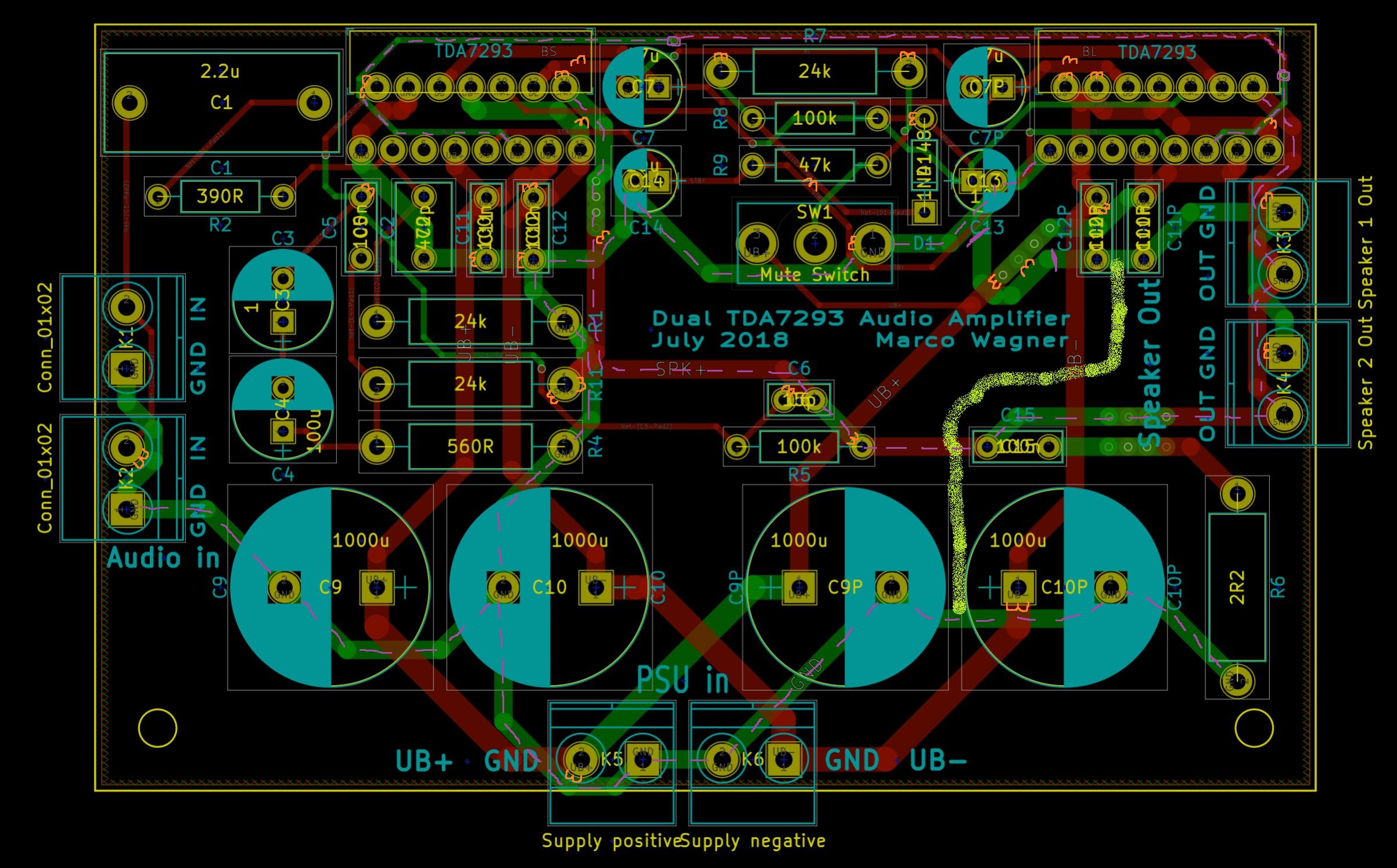

Hi everyone,
about 2 months ago I decided to take on the project of designing my own amplifier which is supposed to be driving my subwoofer in the future.
The circuit I chose to use is a dual TDA7293 parallel design.
I have attached my circuit diagram to this post. Please be aware, that I have already figured out and fixed the follow mistakes made:
- Capacitors C10 and C10P1 (1000u smoothing caps in negative supply rail) are polarized in the wrong direction, have turned them around on PCB
- Capacitor C3 polarized in wrong direction as well
I have also attached an image of my PCB layout.
The power supply is a 24-0-24V toroidal transformer with a rectifier board attached to it (which did not have any problems and has worked perfectly fine from the beginning). It has 2 63V 10.000uF caps per rail.
Now the problems started when I first turned on my amplifier board.
On the first try I had both TDA7293 chips soldered to the board. I have shorted the audio input signal to ground.
In the instant I turned on power, both chipamps literally exploded, meaning they blew off part of the black cover of the IC.
Ofter the past weeks I quadruple checked again for mistakes in my layout and then soldered on a new TDA chip (this time only the one in the master position, because I had heard of the possibility of instability in parallel mode).
But the same thing happened again, instantly after powering on, a flame shoots out the bottom of the IC and that's it...
My last hope are now the great people in this forum who might be able to help me figuring out, what the problem with my amplifier design is.
I'm looking forward to your responses and suggestions and please don't hesitate to ask for any more info required to assess the situation.

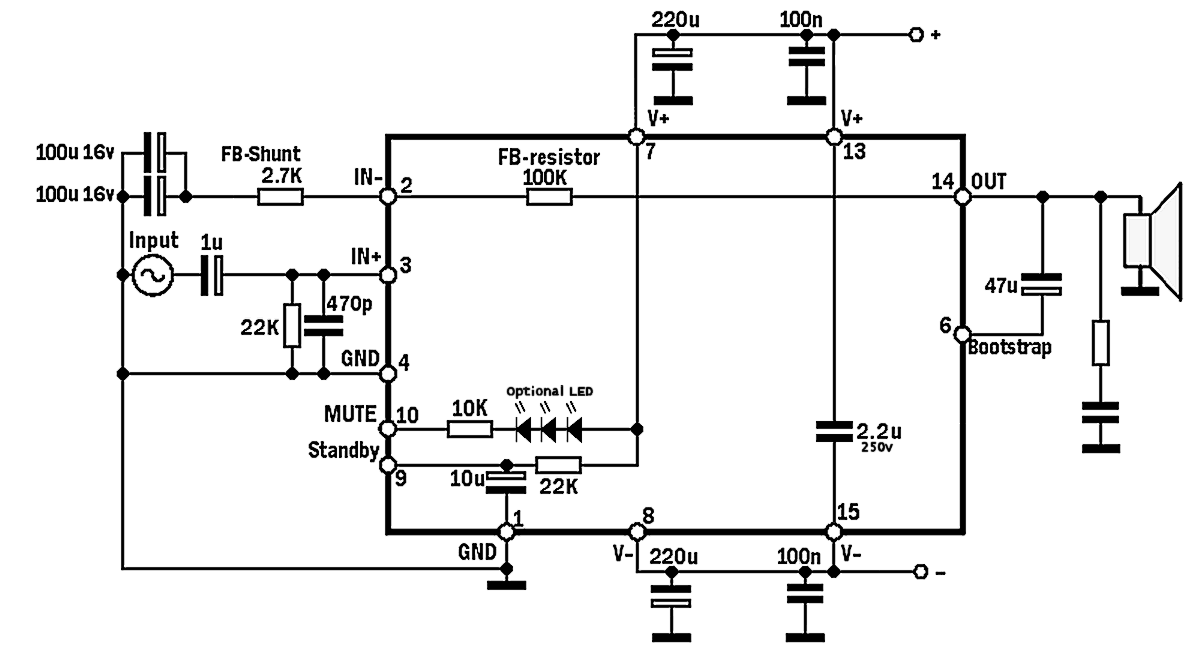

I think you have to check the feedback circuit. Please do one amp as explained in datasheet.

Bootstrap has only the voltage difference, less than 1 rail, inside the cap; however, double-check the polarity.
V- related explosions:
Screw terminals and other friction connectors, if used for power, cause a broken chip. Also, it is necessary to double-check with the ohmmeter between the chip's tab and heatsink--verify insulation works (no conductivity). At the power board, the diode/rectifier must not have screw terminals or other friction connectors. You need a soldering iron to secure these connections, for sure. Also, at the power board, put an LED on V- and an LED on V+, run at 8ma or less--these also provide clues as well as eventually drain the charge down to a couple of volts. Also, led's on = keep fingers away.
Overcurrent:
Initially check out the amp when an incandescent or halogen light bulb is in series with the mains plug. Have a clear bulb so that you can see the filament. An amp that is neither playing nor endeavoring to explode, results in a bulb filament almost too dim to see.
Authentic die-shrink, functional clone, counterfeit, label-swap, stability? The answer could be a 'safer start' schematic, and some notes:
The attached schematic is for the initial effort of getting the amp to work. The mute led's are optional OR can be a Zener for more effectiveness. In this example, there must NOT be any cap bigger than 270uF on the amp board (The larger caps go on the power board). The ringing lowest-bidder 100n caps that come with kits, should be replaced with ordinary ceramic caps (disc preferred due to lowest chances of ringing). For the feedback resistor, the resistor pins must contact chip pins, no vias, no traces. For the feedback-shunt resistor, that resistor must take a straight path between chip pin and coupling cap, no vias, no traces. Those two resistors fit under-board easily, and do use the values from this schematic (attached). The popular, tidy row resistor placement is decorous but anti-functional, so that needs corrected first.

Hi Marco,
The symptom you described has only two likely sources: A low impedance path between SPK+ and one of the power rails, or full-power oscillation. There are enough clearance oopsy-doodles in your board layout to cause the former. And enough long, convoluted, loping traces with ill-advised vias to cause the latter.
At the very least, the clearance issues should be addressed. Start with the ones marked with an orange squiggly in the pic below. Use an X-acto or utility knife, a 10x or 15x magnifier, and your ohmmeter to verify.
Then consider cutting and replacing some of the traces marked with dashed purple, with a direct connection using an insulated jumper of 'hook up' wire. It may be possible to get it working without re-laying out the whole board.
If a new layout IS under consideration, I'd strongly recommend a few not-so-minor changes. Move the output terminals to between the chip-amps, and remove all the Mute/Standby circuitry OUT from in between them. Since such circuits have no performance, stability, or high-current considerations, they should never be allowed to increase the spacing between components that DO.
All grounds are NOT created equal! Try to avoid 'daisy chaining', where a row of supply bypass capacitors have an input, output, or feedback ground picked off either somewhere along the way, or from one end or the other. Also, R6/C15 needs to go directly and with a short path to the high frequency supply bypass caps.
As much fun and satisfaction as it can be to design your own board, it can also be far more frustrating and time consuming than the value of the hard-won lessons learned. I really think it would be worth the effort to attempt the board design in ST's spec PDF.

TDA7293 blowing up is related to MUTE and STBY pins.
Remove the switch and connect the circuit directly to +VCC and your problem will be solved, if there are no errors.
The IC DOES NOT like the STBY pin left OPEN or connected in any other manner.
The TDA7293 works perfectly in PARALLEL bridge to deliver around 320W/8E while not needing any current sharing resistors on its outputs, just as mentioned in the datasheet.
bimbla.
Remove the switch and connect the circuit directly to +VCC and your problem will be solved, if there are no errors. The IC DOES NOT like the STBY pin left OPEN or connected in any other manner.
Datasheet application of standby works perfectly. However, the datasheet application for the mute circuit is an awkward thing that I avoid. The datasheet treats the mute as large signal, which is wrong because it IS a small signal input. And, a bit of wrong at the input causes decreased stability.
I honestly think that the majority of explosions involve sprawling layout to hinder stability (if the gain is too low) and screw terminals glitching the v- while the amp is running. However, in such conditions, an awkward mute circuit making stability slightly worse, could hasten explosion in a very small way.
Anyhow, if you've got a single-layer board, screw terminals and 20-ish gain (mostly bad case), there's nothing you can do to either the mute or standby to prevent explosion.
However, if you've got a compact dual-layer board, securely soldered connections and 30-ish gain (mostly good case), then you might consider streamlining that mute circuit (being mindful that it is small signal).
