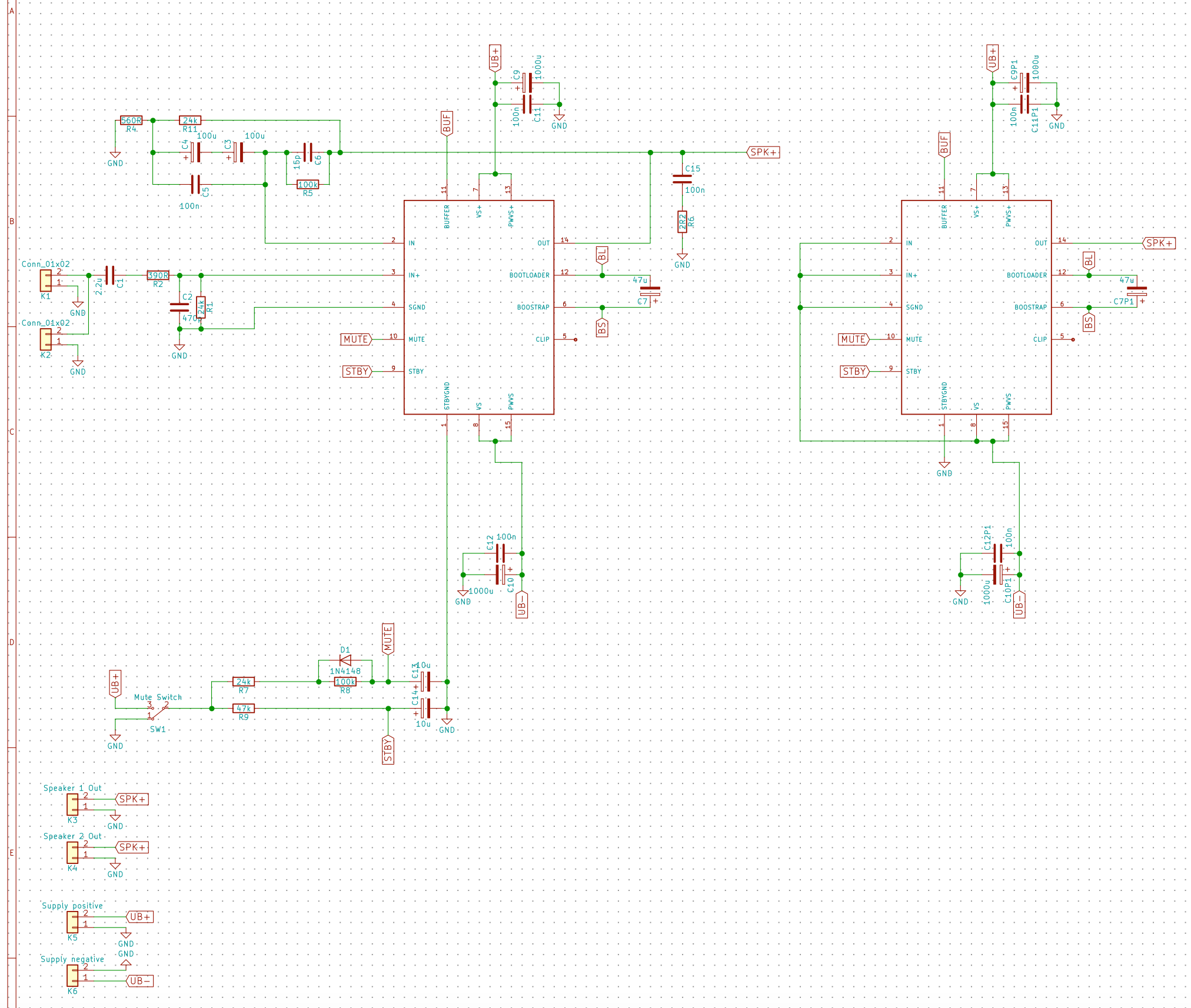

about 2 months ago I decided to take on the project of designing my own amplifier which is supposed to be driving my subwoofer in the future.
The circuit I chose to use is a dual TDA7293 parallel design.
I have attached my circuit diagram to this post. Please be aware, that I have already figured out and fixed the follow mistakes made:
- Capacitors C10 and C10P1 (1000u smoothing caps in negative supply rail) are polarized in the wrong direction, have turned them around on PCB
- Capacitor C3 polarized in wrong direction as well

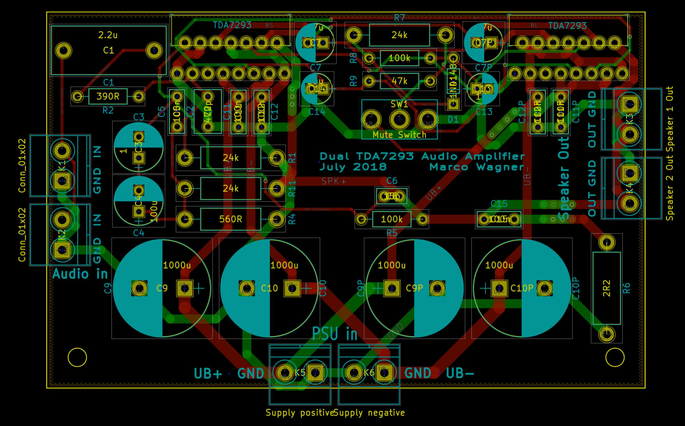

I have also attached an image of my PCB layout.

In your layout, why does the negative supply go to the + side of the bypass caps and vice-versa?
This is one of the mistakes in my layout I mentioned in the first post. Capacitors C10 and C10P are polarized incorrectly and their orientation has been changed accordingly when assembling the PCB.

Mark, my point is that two TDA7293 seem to have been put in parallel at the outputs simply by a direct connection between them. Pin 14 of the first TDA7293 seems connected to pin 14 of the second TDA7293. Could it arise from the use of terminal "SPK+" at both outputs?
To begin with, your schematic is wrong. It will never work as is.
1) you only show the left amp connected to signal, ground, supply rails, NFB and speaker.
the right one has the following gross errors, I am very surprised nobody pointed at them:
a) the right amp has no signal feeding it.
b) +I, -IN and Signal Gnd are not only shorted among them but ... directly connected to -Vb!!!!
That alone will destroy the right side chipamp.
c) its output is directly connected to the left amp output, so it will carry it to its grave too.
d) plus somewhat smaller errors such as unconnected Stby and Mute, etc.

FauxFrench, isn't that the way it has been done in the datasheet, figure 11, where one is placed in slave mode?
Am I the only one who reads datasheets?
Yes Mark, you are the only one who knows how to read here.
You are right, Fig.11 shows that "Modular application" can use the outputs connected in parallel, directly.
As you are the only one to read here, would you know which is the "slave IN pin" described as "The slave IN pin must be connected to the negative supply" (section 4.4, last bullet)?
As an illiterate, I find it likely that the second TDA7293 is actually not acting correctly as a slave and thereby loads the output of the first TDA7293.

When paralleling these, the second chip only has its output stage in use.
Pin 11 (Buffer Driver) operates as an output pin in the first chip. Pin 11 in the slave chip is an input and selected by connecting the - and + inputs to the negative rail.
Direct connection of the two outputs is permitted.
Standby and mute are in parallel for the two chips.
That all seems OK in the diagram in post #1 as far as I can see.

The bootstrap capacitor is in my schematic oriented the same way as in the modular application figure in the TDA data sheet if I am not mistaken, so this should not be the issue.

Is my layout really that different from the data sheet? In what aspects is it really bad? I am very interested in that so I can learn for my future designs.

I believe you are not correct with your assumptions. The second amp is configured for slave mode with it's Input, Feedback and signal Ground connected to the negative supply rail. This is shown in the modular application according to the TDA7293 data sheet.

The "slave IN" pin as I see it is simply the input pin of the second TDA chip which gets shorted to its feedback pin and the negativ supply instead of feeding it an audio signal.

A thought: if the -supply is disconnected, how can it then blow up? Where is that 'blow up current' going to/coming from? Whats the path? Presumably from +supply but where to? Is there a ground connection at the chip, except for the standby pin?
Are we sure there are no other errors??
Edit: I see JMFahey has already pointed them out. Problem identified and diagnosed.

Is my layout really that different from the datasheet? In what aspects is it really bad? I am very interested in that so I can learn for my future designs.

A link to some just for fun layouts that I made for a TDA7293/4 S/V board. Wide power traces. Input ground and feedback connect together then connect to the speaker return (R6 middle of the board).
