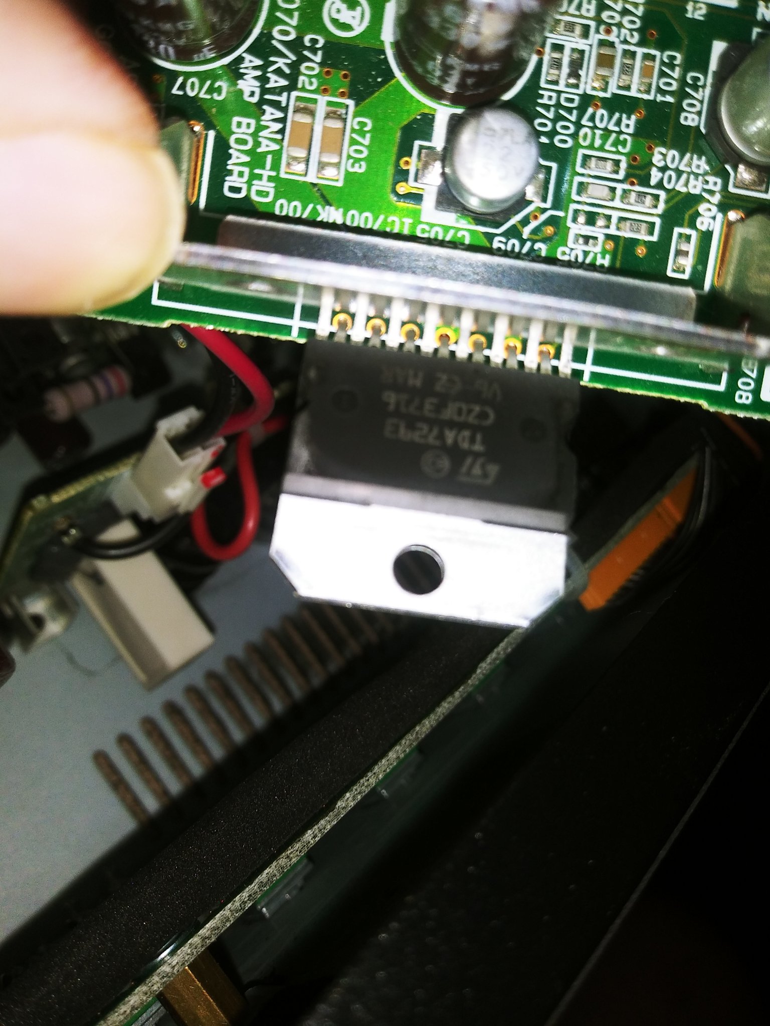

Need a TDA7293 here in the states, my 100 watt BOSS KTANA guitar amp has a burnt one, the only one.
Pain in the A$$ to remove, and I only want to do it once. Pushed too hard.
When they are confirmed dead, best is to cut all pins near body, remove it, and then individually remove pin by pin.
Infinitely easier and safer.

I SMELLS FRIED.

JMFahey asked:
Just curious what sub-ohm load do you need to drive?
Thanks.
Min 8 ohm. According to BOSS.
Ok.
Then you do NOT need to parallel them, even less 3 of them.
Just one is happy driving an 8 ohm load, 2 or 3 in parallel will not improve that a bit, and RMS/peak to peak voltage across the load will be exactly same as before, so no improvement ,even less considering the added complexity.
My question came because only way it would be justified would be driving an "difficult" 4 ohm load, which at times drops below 2.5 ohm , even reaching 2 ohm at some critical frequency.
Apparently not your case.
Please rememeber those other two big differences between 7293's and 7294's: 7294's can't be paralleled (pin 11 = n.c.) and supply voltage ratings are lower (±40 Vdc vs. ±50 Vdc).
Best regards!
