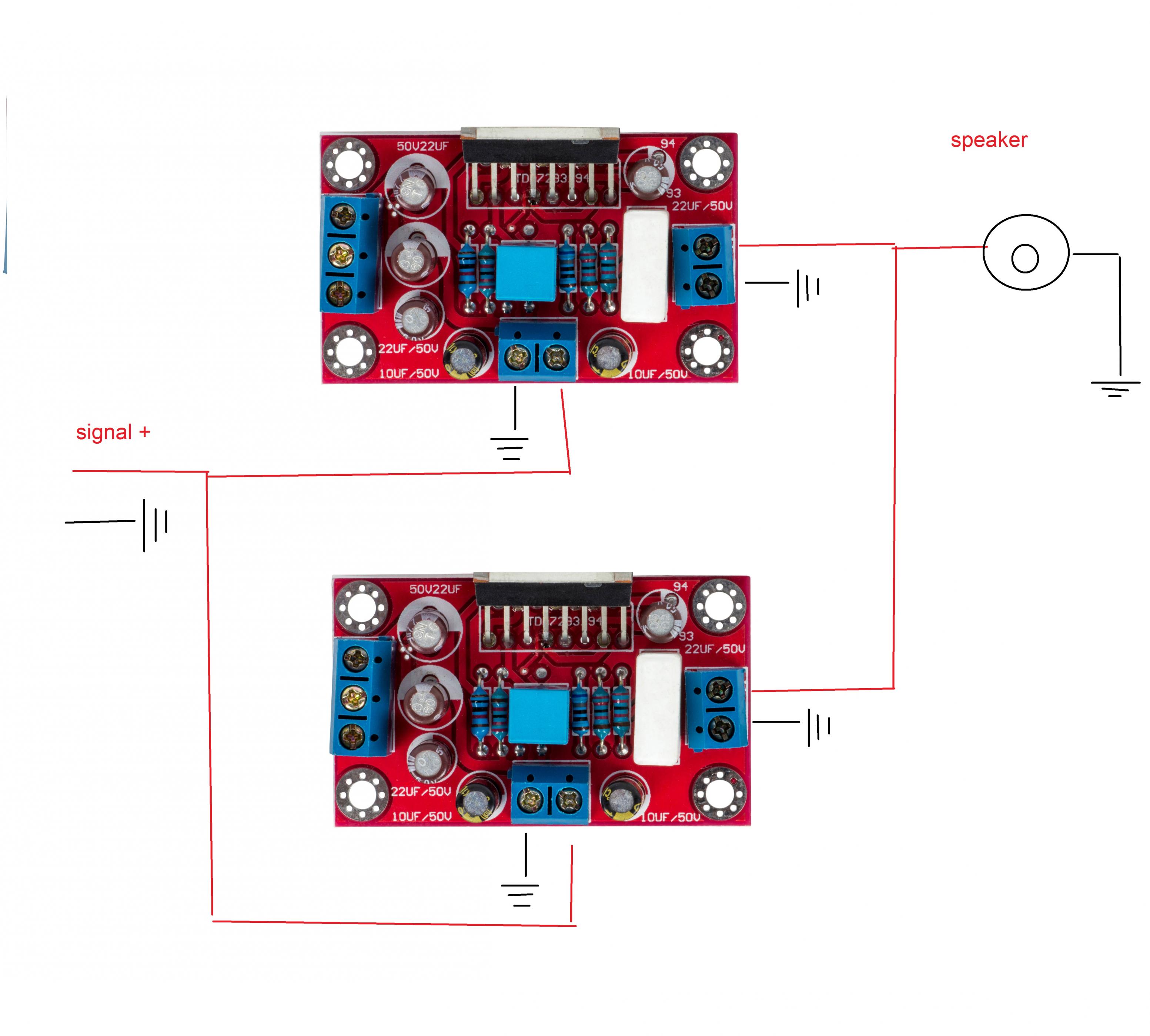

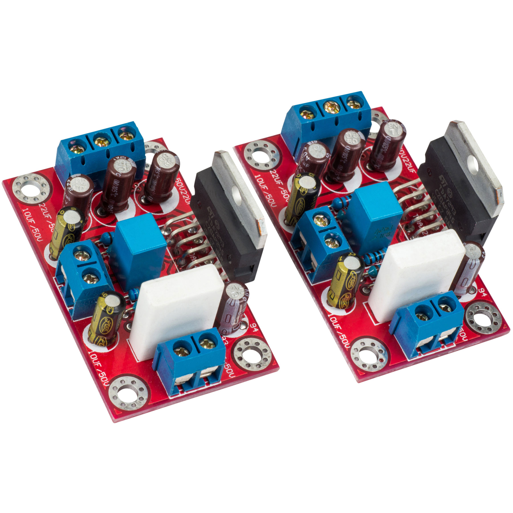

The boards I have are attached. So if I understand you correctly, on these boards, I want to make sure the resistors are matched as closely as possible...Is the diagram I made missing anything besides the output .2ohm resistors at the Speaker Out terminals? Should I add any caps or resistors to the signal Input?

With those boards you don't need to match all the resistors - only two (probably) are gain determining resistors. But you will need to match one of the capacitors (harder than matching resistors) or increase their value by a factor of 10 or more.
If you have a continuity checker the resistors that need matching will be connected to pin2 of the TDA7293. Or perhaps to pin2 via the cap (in the case of the resistor to 0V) and its that cap which needs either matching or increasing in value.
