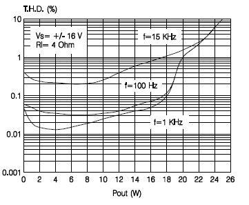

So what chip amp next? I tried to check the datasheet for TDA7296. No way this chip can sound good. Here is a little secret of a good/bad sounding amplifier (example is a bad one, for TDA7296):
Its probably the RF susceptibility of the input stage, that's the reason you find you can't get decent sound without a preamp. Try TDA8566, this is giving me the special sound without any preamp, but you do need very good PSU decoupling - ceramic caps I've found work well.
Looking at a THD vs level plot, what I think indicates bad sound is sharply rising THD at the lowest levels (<1W on this plot you're showing).
