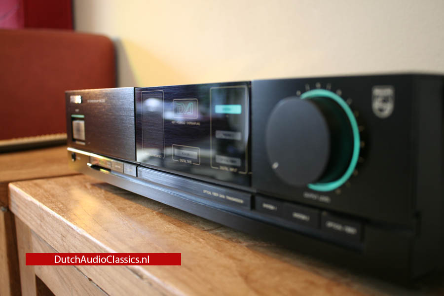

Probably looking for an older device that accepts 16bit 41/48 with digital in (most likely optical).
Judging by what is said on dutchaudioclassics.nl searching for something with the TDA1541A onboard.
By researching through their device list, most are CD players, with a few exceptions being Marantz Project D-1 (too big) and Cambridge Audio dacmagic DAC3, which is actually available on ebay for £100 starting bid at the moment but unsure whether or not if 4xTDA1541 in parallel is necessary.

Philllips' DAC 960 looks stunning too though definately out o reach..
TDA1541A is a much better sounding chip than newer sigma-delta based designs, but implementation is key - noise from the adjacent SAA7220 filter can be a limiting factor. Quad TDA1541A is unlikely to be for engineering reasons - could be a good source of spare chips though. I noticed a Philips CD460 going for around $140 which also has TDA1541A.
