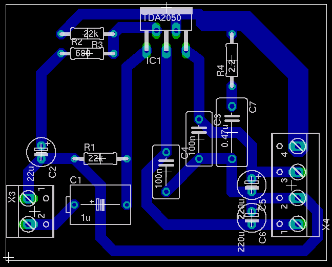

I still have to test it to know exactly how well it is working, but I was already able to listen to Discharge and nag my neighbours... I'm sending the eagle lay-out, but I used it only for drilling / punching the holes. I drew the board by hand, and the power tracks are about 5mm thick.

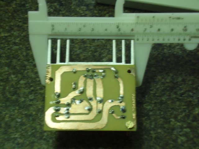

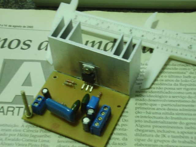

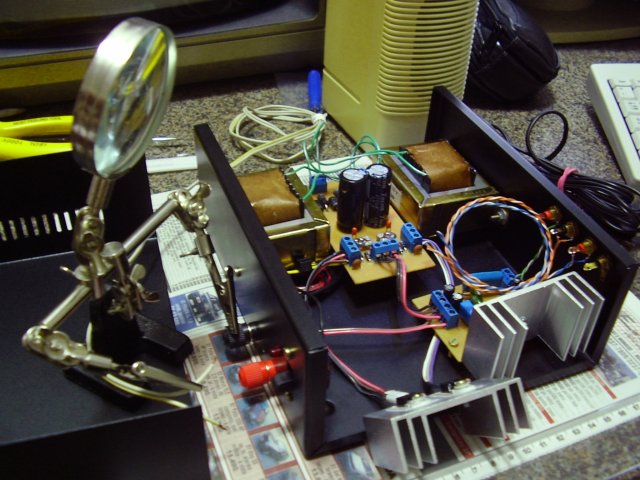

Finally I got my camera back... Here are some (ugly!) pics of the amp. :)
The design is basically the one suggested on the datasheet. I just redraw to remove thas space for the stuff that you might use on the TDA2030.
Caps are 16v... I also changed the type of the input capacitor because it makes me nervous to use electrolytics there :)
Yes, I decided to drill the holes after, and then decided I did need them! :(:headbash:

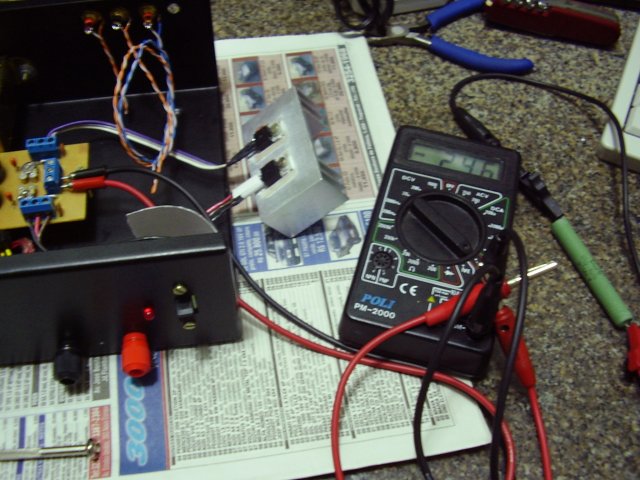

"Smoke test" of the PSU. Some serious 2.46 ampères going on! Almost 10W on "big green" 1.5 ohms load. The heatsink is too small for that... The voltage on the regulator input is 20V, with a 5V output so it means 15*2.46 = around 37W :bigeyes: It was almost too hot for touch (probably would be with both regulators on!)
