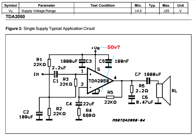

Thanks for the help everyone! I guess now I should go and actually build something, I'll try a base gain of 30 and make it adjustable to 50 using a small trimmer to find the right balance between volume and hiss.
