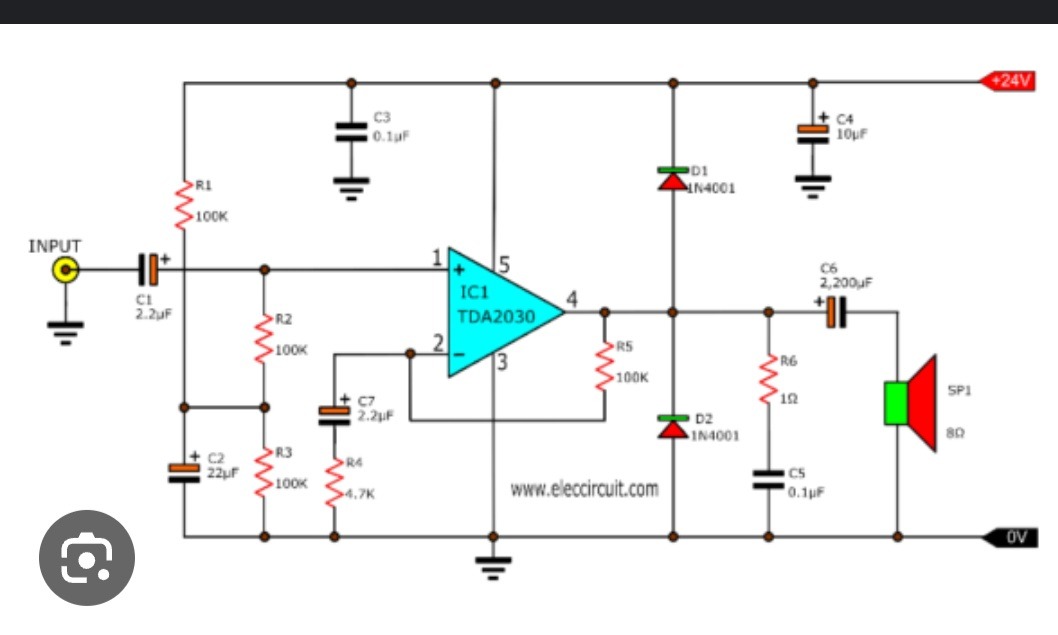

A Anselrecod Member Joined 2024 2024-01-21 10:00 pm #1 2024-01-21 10:00 pm #1 In this circuit, could I replace my tda2030 with a tda2050? I can't find any circuits to work for my tda2050 but I have seen the chips are interchangeable in some circuits. asuslover Member Joined 2016 2024-01-26 4:18 am #2 2024-01-26 4:18 am #2 At 24v Of course you could use tda2050 or 2051 or 2040 instead of tda2030. But the real winner is lm1875 because is not discontinued. Reactions: JMFahey JMFahey Member Joined 2009 2024-01-26 4:22 am #3 2024-01-26 4:22 am #3 True. You can also try to get second source **2030 or **2050 from UTC, which are acceptable quality copies. If you can't find a supplier, Profusion PLC is an authorized distributor.. You must log in or register to reply here. Share: Facebook X (Twitter) LinkedIn Reddit Pinterest Tumblr WhatsApp Email Link
