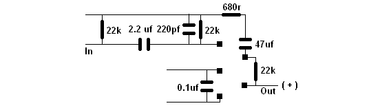

And here are the schematics of both
LM1875
http://www.electronics-lab.com/blog/wp-content/uploads/2010/08/20W-amplifier-using-LM1875.png
And for TDA2030
http://www.electroschematics.com/wp-content/uploads/2009/02/tda2030-diagram.jpg
Both of these schematic are easy to understand for you.
