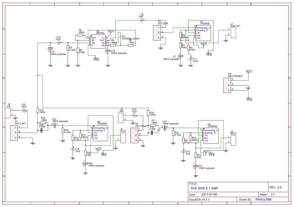

Well it isn't a humming noise as in low frequency, it is a high frequency jitter from the two satellite speakers, I changed the tda2030 chips with better quality ones and even that didn't work, the only way the jitter would go away is when we touched the heatsink when it was connected to negative 12vdc through the chips middle leg, question is what change occurred when we touched the heatsink/negative 12vdc? Something to do with radio interference? EMI? Something else?
Check your circuit against this
Also connect the heat sink through a 100 ohms or so resistor to mains earth and see what happens.

Tda2030 2.1 Subwoofer Amplifier Circuit Diagram - TESCKT
This has a good description and layout with instructions.
Helpful
In the previous post the schematic is a copy from the web, not my work.
Helpful

I compared the image in #3 with my board,
I found the only difference is in the ground pad layout,
mine ground begin with the center joint of the 2 big caps ,
all along from that center joint to the TDA2030s,
then to the filtering IC,
finally to the input jack ground.
I found this board,
the input ground is in the mid way of the subwoofer ground.
this could cause instability.
I thought if try to connect two wires from the center joint of 2 big caps,
one to the SW ground joint,
the other to the input ground joint, this mod might be helpful.
(if this mod works then isolate the input ground pin from the ground pad)
its just a suggestion
