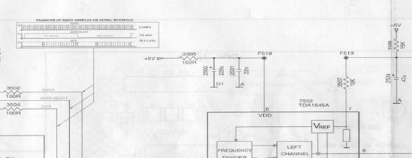

TDA1545A is in my Philips cd723.
Any recommendations for the vref cap size or make?
Also the vref calc as attached picture:-
10000/(10000+15000) * 5V = 2V vref

Konnichiwa,
The Vref input fundamentally drives both full scale current and offset current in the TDA1545, when using the original circuit it also becomes an input signal for the output stage, where it is at least passed through at unity gain.
You have de-factor around 7.5KOhm Resistance in the circuit to form a lowpass for supply noise.
You need a capacitor with VERY LOW ESR (as ESR limits the maximum attenuation) and good high frequency behaviour, which because of the crappy supply in this player also needs to be VERY LARGE in value to make sure you knock out at least 60db @ 100Hz, in other words the RC filter needs a turnover of 0.1Hz.
From that we get 220uF as minimum, I would say make it a Sanyo Os-Con, 6.3V while you are at it. When using traditional electrolytic capacitors something closer to 2,200uF/6.3V will likely be needed.

Konnichiwa,
eVITAERC said:
Very informative post Kuei!
I have no idea that the PSRR of TDA1545 is THAT crappy :(
Well, the full scale current of the TDA1545 AND the bias (offset) current are both directly proportinal to Vref, with around 10db gain IIRC, so in effect -10db PSRR on Vref.
The PSRR on the supply line of the TDA1545 is listed as 30db.
In other words, unless both Vref and Vdd are squeaky clean, Vref to 18Bit levels and Vdd to 12bit levels the TDA1545, referenced to the output the chips performance will degrade, potentially very seriously.

For the vref capacitor I have some rubycon mbz low esr 1000uf caps lying around so I modelled the circuit in SwitcherCad, and it "modelled" ok so may try this cap out today or tomorrow.
Thanks for the pointers towards upgrading the power supply. I thought I misread the diagrams at first (+10/-10V supply for opamps was unregulated) but nope it's all there!
