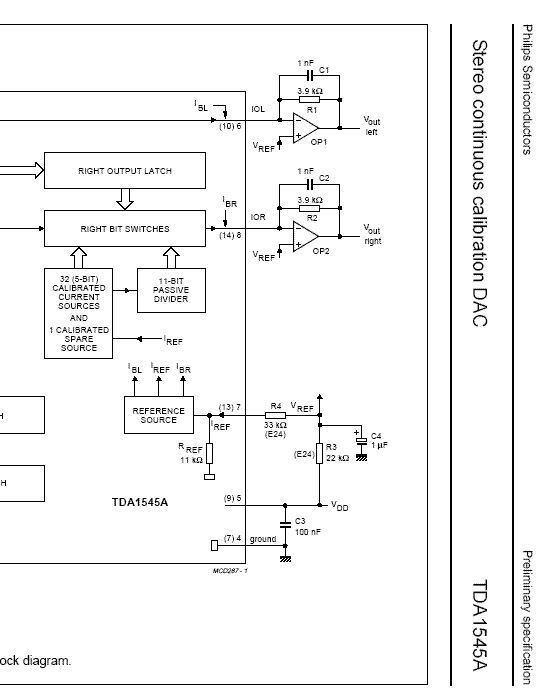

My question is whether the TDA1545 can be operated in piggy back mode, and if so, what changes to the Iref & Vref (or anything else) would be needed. Also, how many 1545 chips can be piggybacked?

The requirements for I/V conversion for TDA1543 are a bit different to TDA1545. I don't know enough to know whether TDA1545 can be used in parallel, or whether the particular I/V requirements for TDA1545 prevents parallel operation.

this is the output part of the 1545: what happens when you keep R 4 (for each dac a separate one) as is and adjust R3 for the same reference voltage as before? When you stack these devices you need more current for the additional dacs - the voltage drop at R3 will be higher. So lower the value...
michael

By the way, I haven't yet got around to trying the suggestion of michael in post #4 above to see if I can piggy back the 1545. I hope to be able to try it this weekend, or next week.
