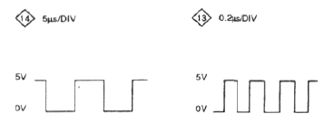

I don't have a scope so I can't really measure it, refering to page 8 of CD63 service manual, it seems that the digital filter 8x oversamples the sampling frequency input, hence my guess.
If anyone could confirm this, I'll be pleased to know.

As SM5872 is delta/sigma DAC and incorporates 8fs oversampling filter it is quite logical that no oversampling is done before it. Also, according to cd63’s Service Manual (page 16), wclk signal is 44.1kHz. Sclk (bck) looks alike 48 x wclk, i.e. ~2.1MHz (actually diagram shows 10-20% less freq than it should be, but it was most likely problem with printing).
Pedja
(14 is wclk, 13 is sclk)
