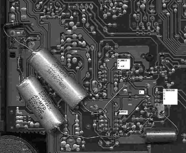

Today I bought a Philips CD210. Flea market. The output didn’t work.
The chipset is SAA7310, TDA1543 as DAC, two LM833 for filtering and signal output. The printed circuit is two sided, where one side is mainly earth. I read that SAA7310 seems to be giving superior error correction and that Meridian uses it for that reason 
I did the following mods:
1) I disconnected the digital feed to the digital output, disconnected the two pins so now I have two extra cinch sets for output on the back.
2) I connected a 470nF capacitor to the pin 2 of the LM833 of each channel (the first opamp, like in the specs). This I did because I found no signal (strange) on pin 6/8 of the DAC (scope).
3) I also replaced the supply cap on the DAC (originally 220 muF) with a solid tantalum 150 muF and this really should have a good effect as these have linear response op to the Mhz (used by the former l’Audiophile team on all supplies). Solid tantalum from STC is a tubular design, 2 cm by 0,75 cm)
So everything else remains in place, including the inductor, they are just quite further on in the circuit.
This first opamp of the LM833 is used as a 40 kHz lowpass (1k2/3n3). So this is rather OK to tap off. The output impedance is low enough.
I compared this with my Meridian 206. I have one CD twice in my collection: Leclair - Sculla and Glaucus (Gardiner). This allows real double blind testing. There is no level difference between the two outputs.
The CD210 with this modification gives a definite better soundstage: just handling violins better on normal and heavy passages. Ease and relaxation. Pleasant. Convincing – also to my wife. It’s excellent. The 206 is a 1-bit. The impression I have on a CD like Sade Lovers Rock also shows that rock (intensely mixed) also sounds more relaxed. The bass is tighter. The sound effects and gimmicks come on clearly now. On Brassens Les copains d’abord the guitar is not anymore larger than life, really sounding like as they are his ‘les copains gonflés’ playing along.

Just a correction of a mistake: I connected the output on pin 7 of the LM833's. I attach a picture.
See the place where I cut the output plugs, very simple job to do.
Thinking over it: I think that the outputs (6/8) of the TDA1543 are not giving off any trace is because they run into the feedbackloop of the LM833 opamp. So the internal resistance of the TDA1543 attaches to the feedback and this regulats untill there is just no signal left, any microvolt difference is ampolified. So the connection looks like it is plan earth on the scope but the opamp is doning the work to keep it like that and the by-product of this configuration (like a summing amplifier) is a clean output signal!
This is just another description of course of an inverting amplifier but I think its fits better here in this circumstance.
