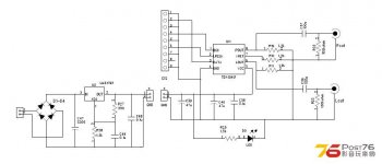

That schematic sets the TDA1543 supply to about 7V.
Yahh....I'm wondering if somebody has sucessed the passive IV
after tda1543 with 5V PSU
Raising the supply rail voltage is not supposed to raise Vout or Vref, so your chip is doing what it is supposed to do.
Raising the supply rail voltage gives you greater headroom so you can choose resistor values which result in no peak clipping. If the rail is too low then it is impossible to choose correct resistor values, as you have found.
The aim is to set Vout at about halfway between the limits set by the supply rail. To do this you need to use Ohm's Law on Rout to calculate the current, and then use Ohm's Law on Rref to adjust the current. Alternatively, see my webpage where I have given the answers.
