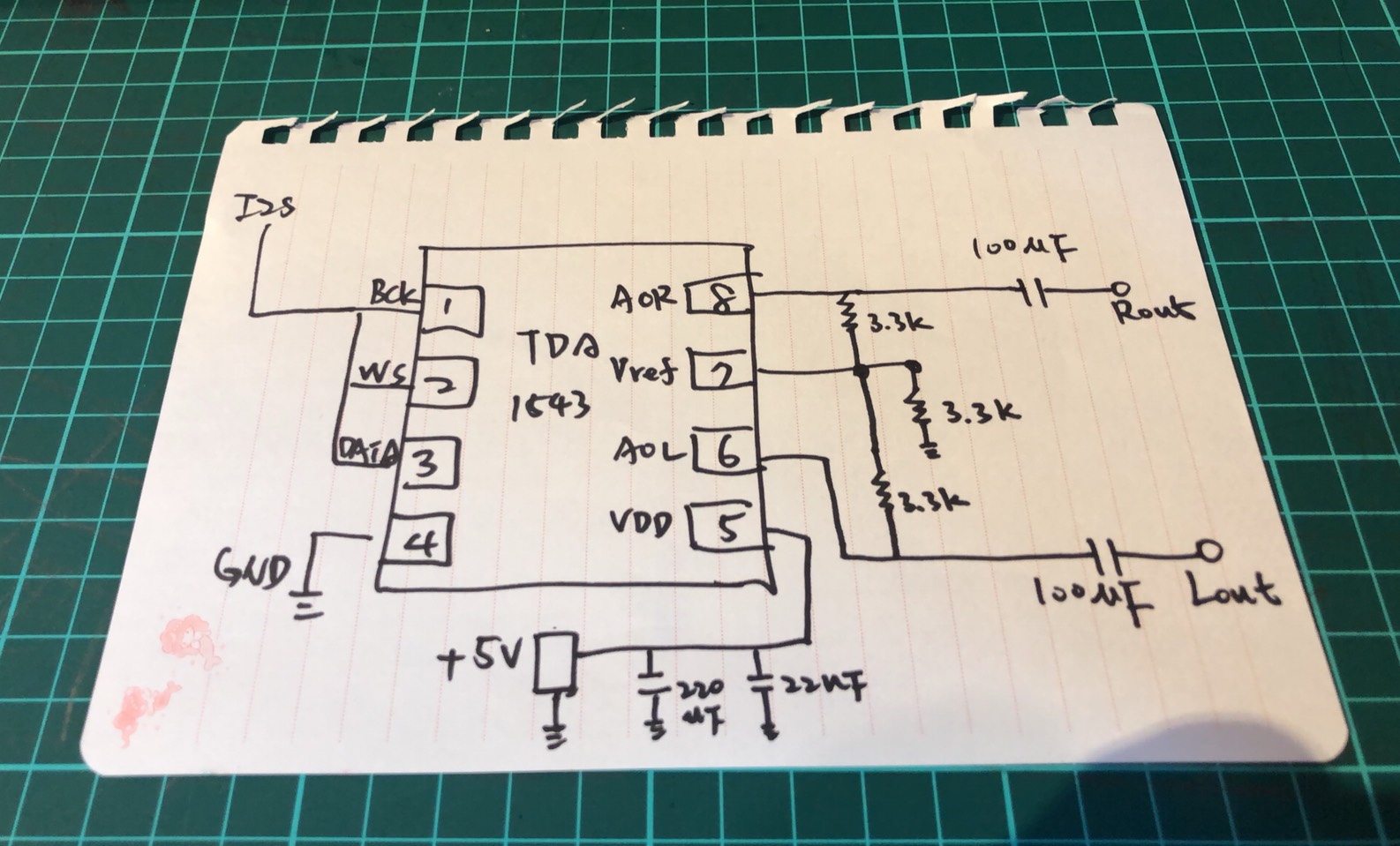

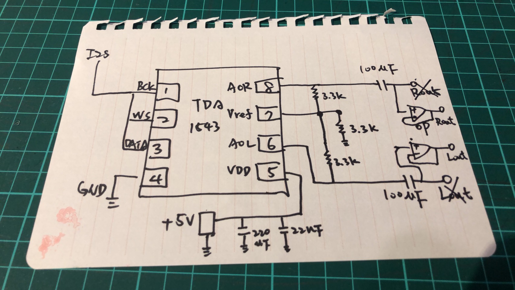

I'm trying to modify my philips cd player with directly I/V out as the pic below
I move away the original opamp I/V converter circuit And use a SHUNT resistor(3.3K) and SERIES CAP(100uF) and then output directly.
But there're some white noise in the background although the music can still be recognized (but noisy!)
Is that because I left the point B(Vref) flatten?😕

Where are the 2 output resistors (from AOR/AOL to GND) ?
They set the output dc offset. There is a calculator to determine the value of them according to the number of chips and the voltage you are using. I'll try locate it

I’ve draw on the pic.🙂
Ah, those red things. OK then, what do you mean 'flatten' ? Everything seems OK provided you got the right values for RVref and RLoad resistors.
I had a number of TDA1543 chips, remember having the same problem from cold joint between RLoad resistors and ground.

If you just removed the opamp then the feedback RC network may still be in the circuit depended on what comes after the opamp.

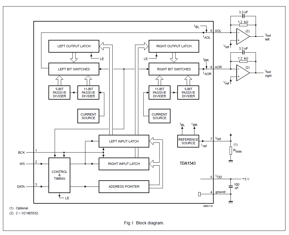

I tried to modified the schematic and solved the white noise problem
The schematic has been showed below
The main concept of this schematic is to use the Vref as a reference "Ground" to the AOL and AOR I/V converter circuit.
Just like the reference block diagram that datasheet suggest(It uses the virtual short of the OPAMP to set a reference ground for AOL and AOR)
But there's also some problem of the sound.
The bass is totally gone.
It's not just a subjective consciousness.
The prove is when I playing a string quartet.
Sound of the Cello part is much weaker comparing to the original OP I/V converter.
The imbalance of the sound can be observed in other music also.
Do anyone knows the reason?

I/U resistors( from Aor and Aol in your schematic ) must be connected to ground not to V ref
It will be some white noise at the background as I mentioned before.
But I don't know why.
Connect to Vref solve this problem.
I added a OP buffer after the passive i/v and the BASS comes back.
But there's still some distortion occurred as the music comes to the largest dynamic.
I guess maybe the value of the resistor still needs to be fine tuned.
Vref is not just a voltage reference output, its also a current input. By connecting Vref to the audio output you're varying the DAC's bias current with the audio, not at all a recommended approach.

I think that’s why the philips guys used the OP amp as a IV converters that can refer to the Vref with it’s virtual ground but isolates the sink current(IBR IBL on the datasheet) simultaneously.
So Maybe that’s also why veterans use the external Voltage supply for the Vref.

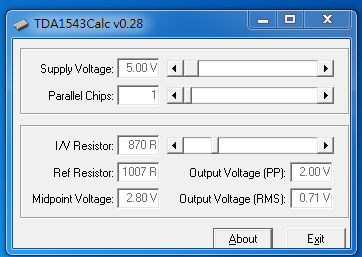

Your choice of 3k3 for I/V resistor doesn't work with TDA1543 - its too high a value, bound to result in clipping. For 5V supply you can only get 2V swing at the output hence you need an I/V resistor of 820ohm. Then adjust the output voltage (pins 6 and 8) with a resistor between pin7 and GND to get 2.8V.

According to the calculator that savvas kindly offered.
The Rref should also change to 1K ohm right?
I believe that 2.8V is so called the midpoint voltage right?

It could be higher, the DDDAC (16x1543) had 3.2-3.4V target voltage. I've read many suggestions for one with regards the supplying voltage e.g.
Pavouk's (5V) is Rref 1k5 and Rload 2k2

Calculators I think is to give you a general idea. Doede Douma debates the values from the calculator from DiyHifi. He relies more on his experience from listening as you might also read.
- midpoint recommendation
"on 6 Volt the best midpoint is 2,5 Volt
on 8 Volt the best mid point is 3,85 Volt"
- his recommendation for resistor values is the same with Pavouk's per DAC (i.e. 2k2 / number of dacs).
Also it is widely recommended to push voltage above 5VDC up to 8.5VDC (better THD). True, the datasheet has an example with OPAs but since 1543 is capable for 2Vrms Ι find it unnecessary. Tubes are more popular (there is a dedicated thread)
So, try adjusting to the above (even using trimmers if you can) and see what you get.
