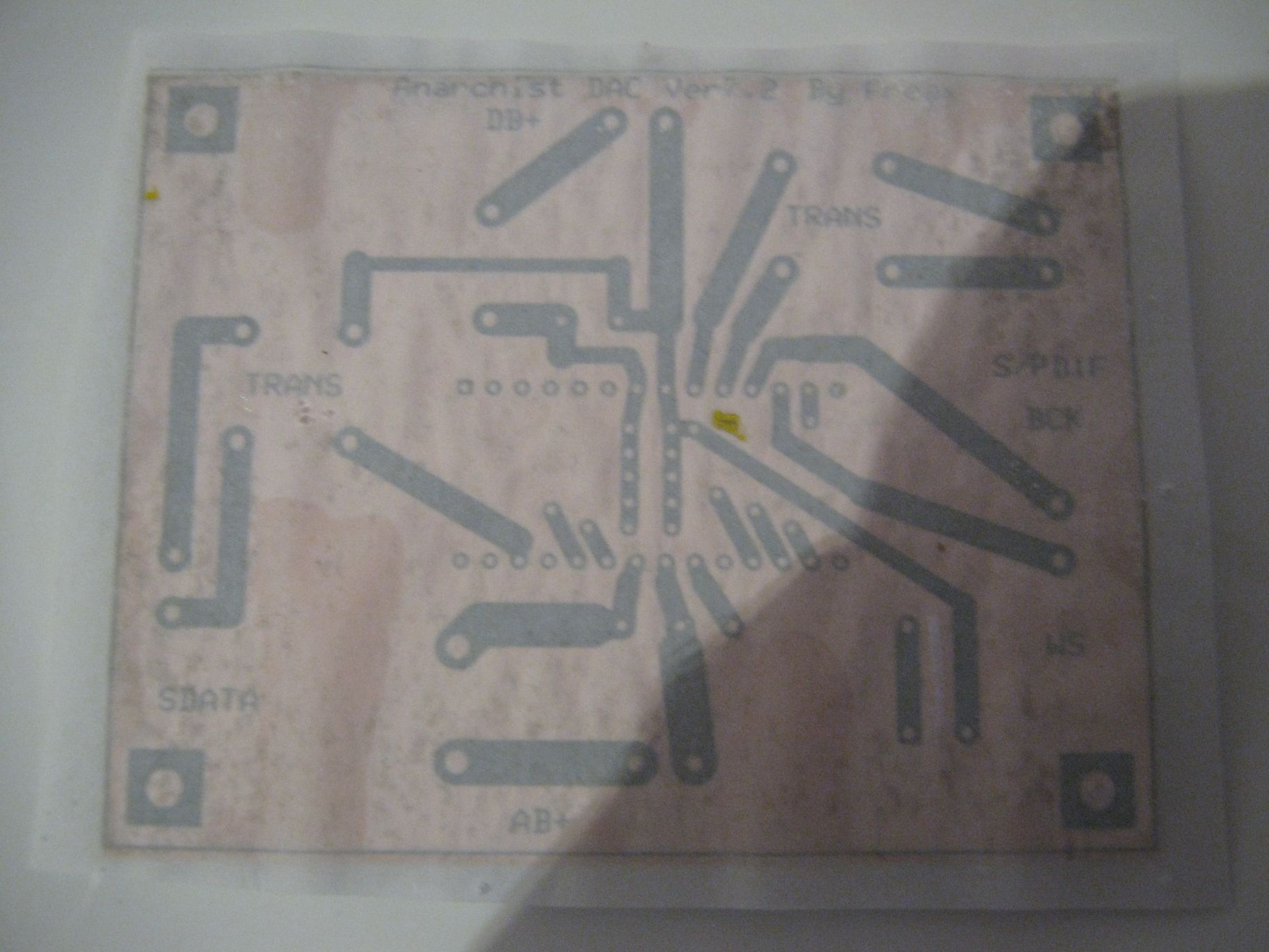

Here is the 1st half of version 7.2 Alpha:
In this version you select which modes you want the CS8412 to do by bridging the M0-M3 traces and SEL traces to either earth or DB+ (5v). This version has thicker traces too which will aid in doing toner transfers to a PCB. (I know this from experience)
You will find the v7.2 expresspcb trace attached to this message.
It is not recommended that you build these until I have had a chance to build them myself (as of 25th of July 2014 I am only up to the pcb transfer stage, still waiting for components to arrive, specifically a drill press.), this thread is mainly for my own personal self discovery with this design and also to find any bugs or issues which I myself cannot see by my own. While you could theoretically print and build these traces you do so at your OWN RISK.

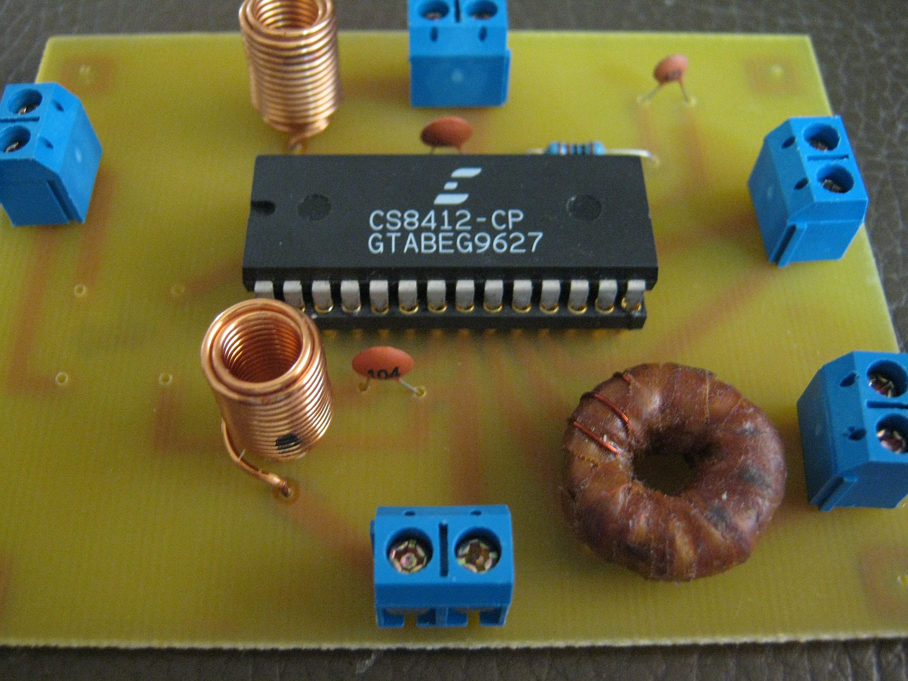

Version 7.2.1 of the CS8412 part A.
Version 8.1.1 of the TDA1543 part B.
Part A
Part B
Both are bundled in the same zip file as attached to this message:

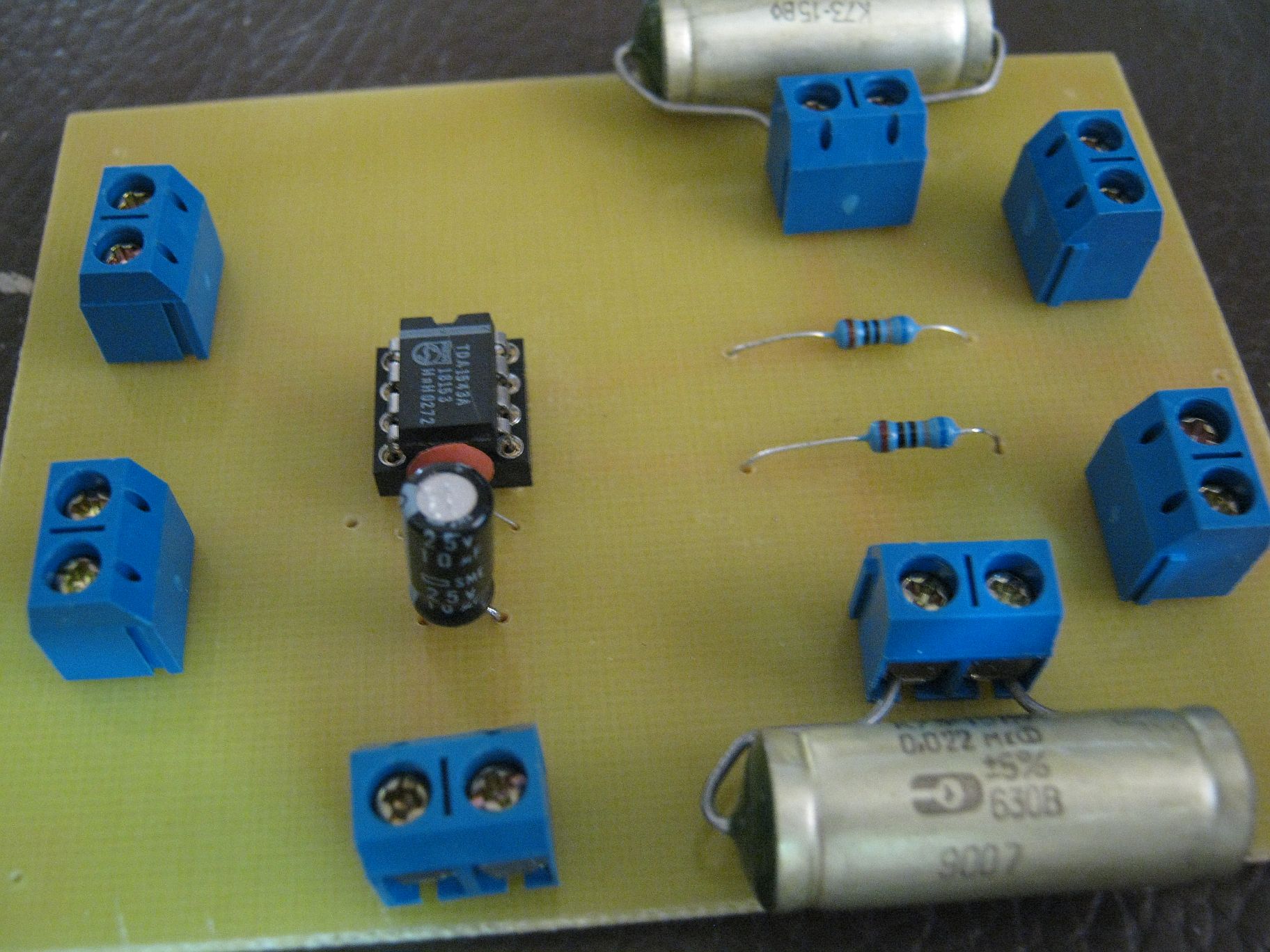

Progress has been made with regards to pcb printing/drilling.

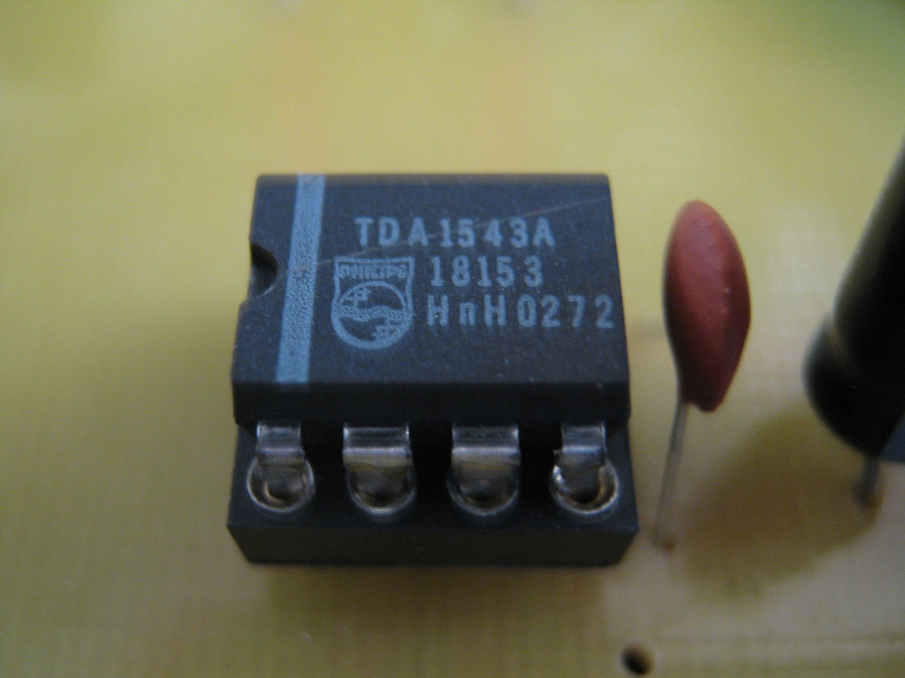

If anyone is interested, this is what a genuine TDA1543A looks like. (Pulled from a Sony CDP)
I am aware of the incompatability of the CS8412 with the TDA1543A, Will be finding another IC capable of Japanese digital output.

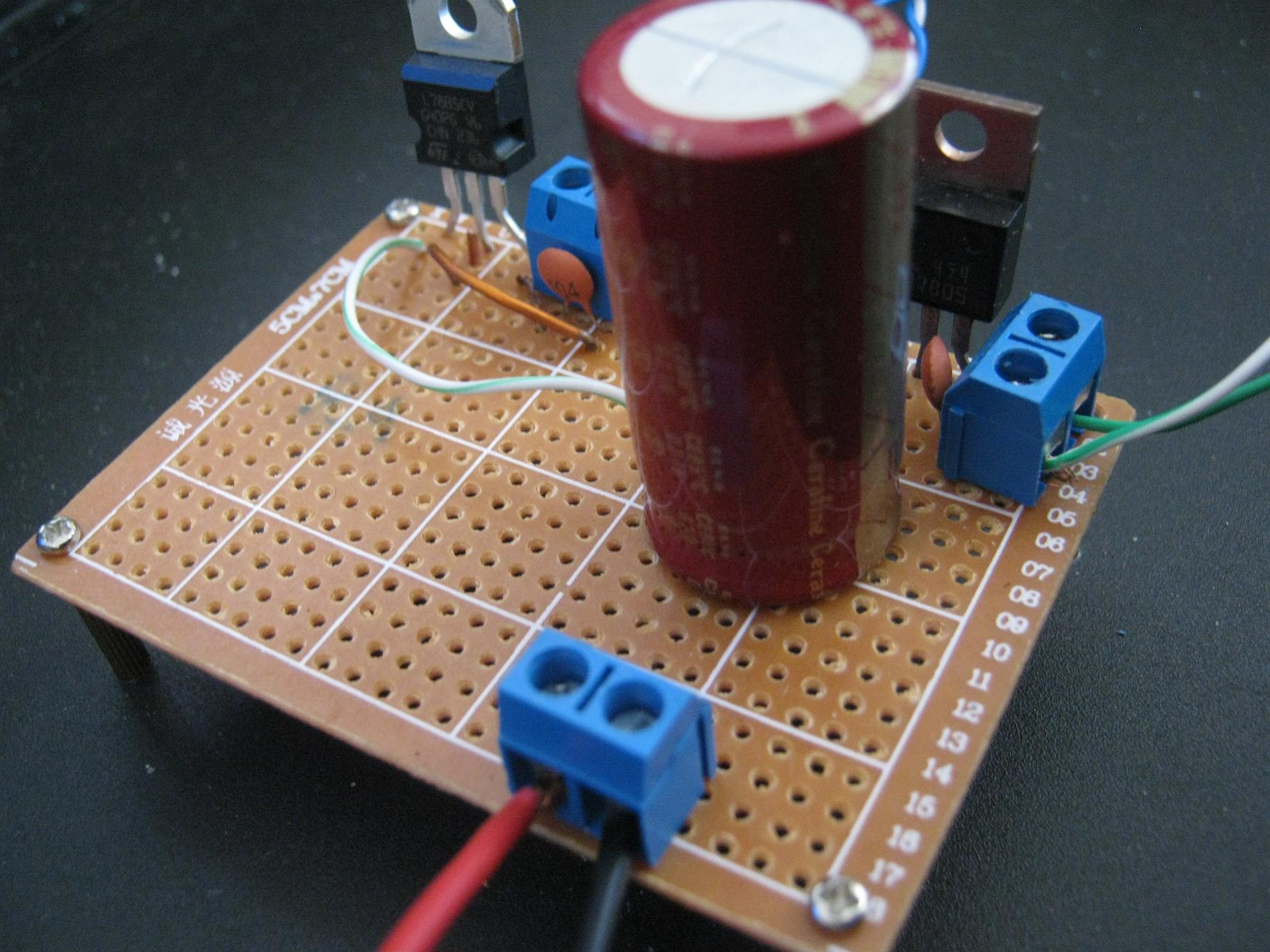

I'm at the moment designing the LM317 super capacitor power supply. Its a bit difficult because I need to make it capable of automatically switching from a solar 12v DC power source to 240v AC and back again during a blackout.

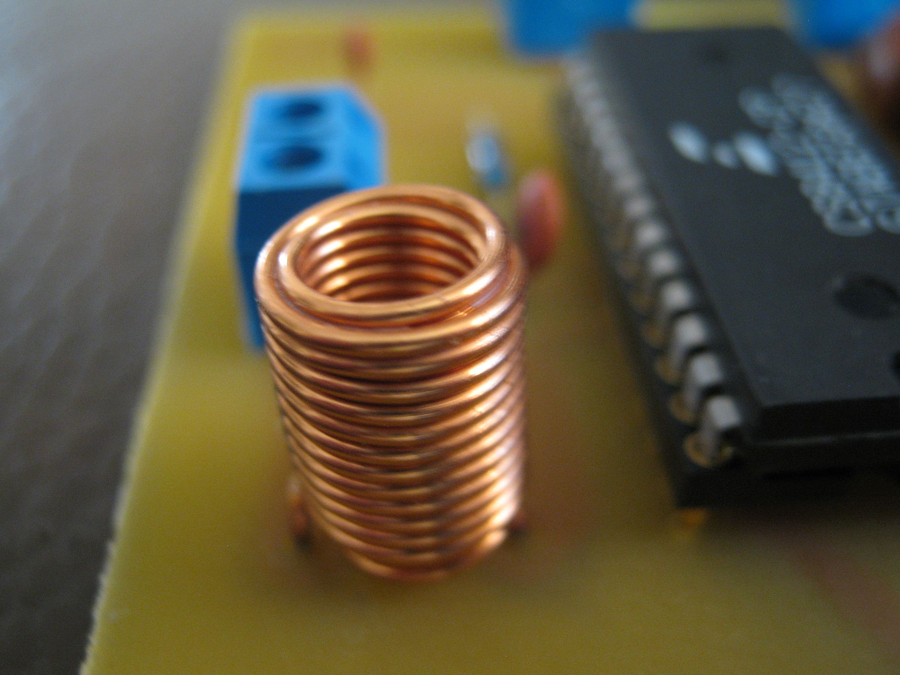

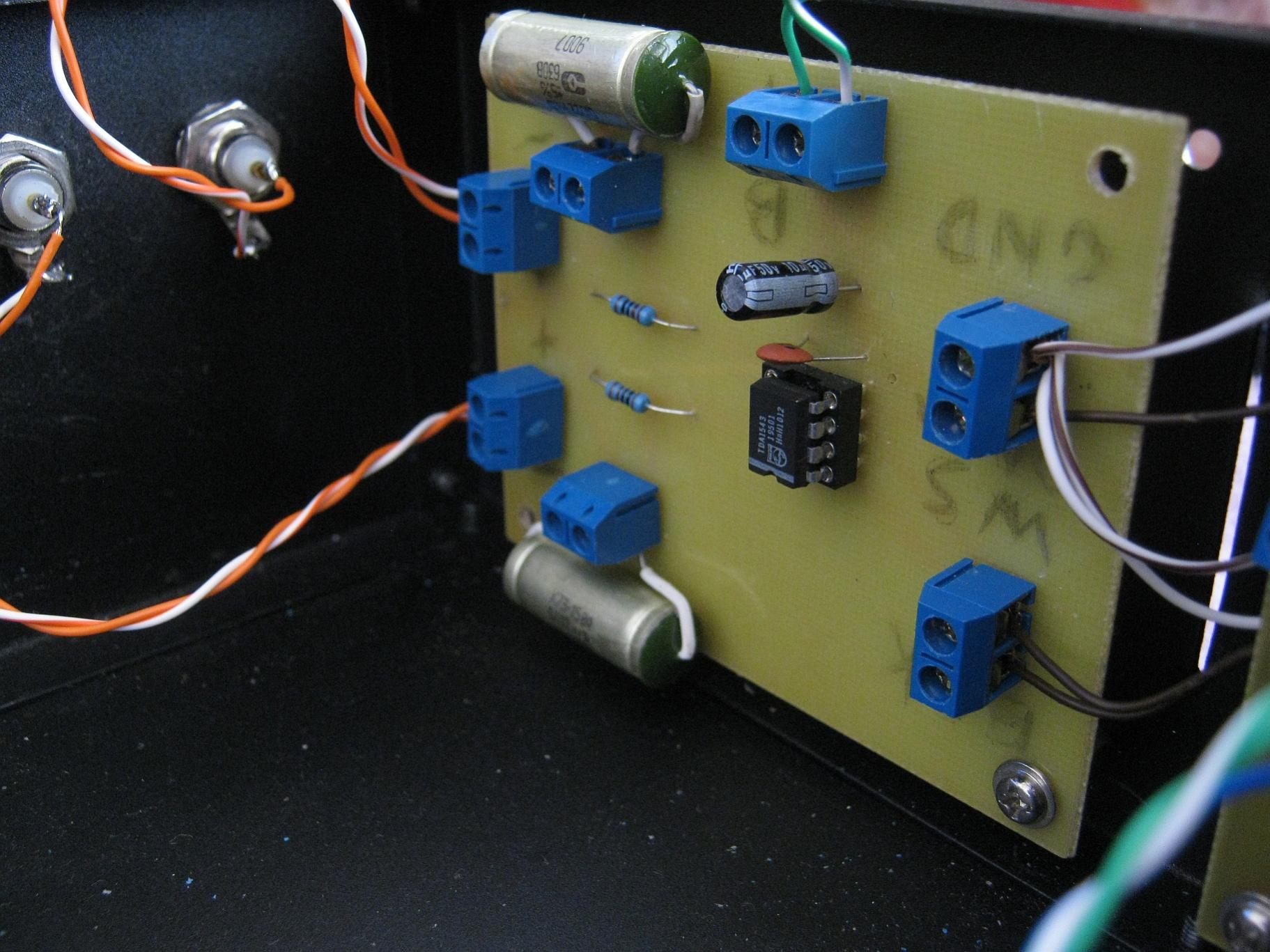

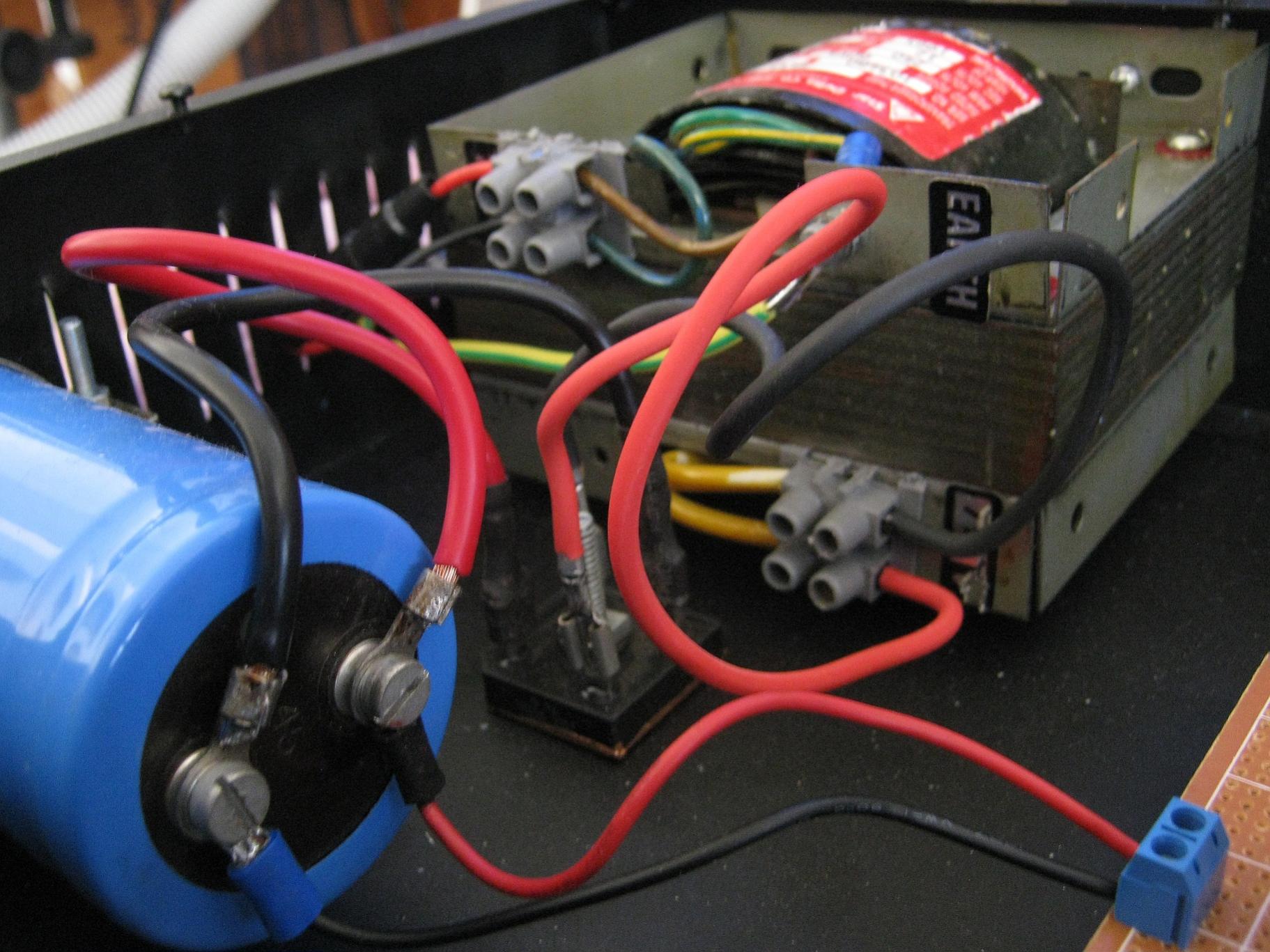

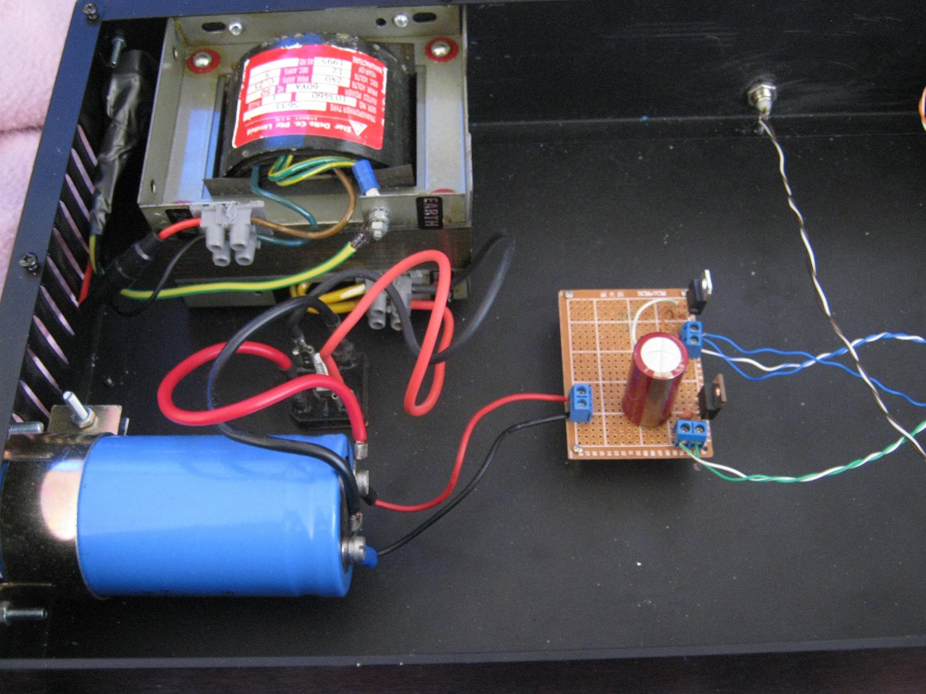

Got pictures of the prototype.
It sounds great. Very soft but accurate and sharp. It does lack bass but it makes up for it with tons of clarity.
The only thing that I have to compare it to is a TDA1541 (NON-A) board pull from a Marantz CD-65 CD Player, unmodded with the op-amps still in place. And the TDA1543 Russian dac kit "Hypnosis" with its cheap chinese knockoff/fake TDA1543 IC.
~ Compared to an unmolested Marantz CD-65:
It sounds at least 90% as good as the TDA1541 which is about what I expected. It does have a taste of the 3D clarity which the TDA1541 brings to the table but it is not completely immersive as the TDA1541 can be.
~ Compared to the eBay TDA1543 Russian DAC Kit "Hypnosis"
In comparison to this one the Russian DAC has a sharp and nasty high end. This Anarchist DAC has seemed to mellowed everything out a bit. It does have the same 3D clarity as the Russian DAC but it just sounds smoother and less fatiuging.
~ Compared to your average run-of-the-mill CD player with a 1-Bit dac, this is far far superior.
All of these observations are with 4 hours of burn-in.

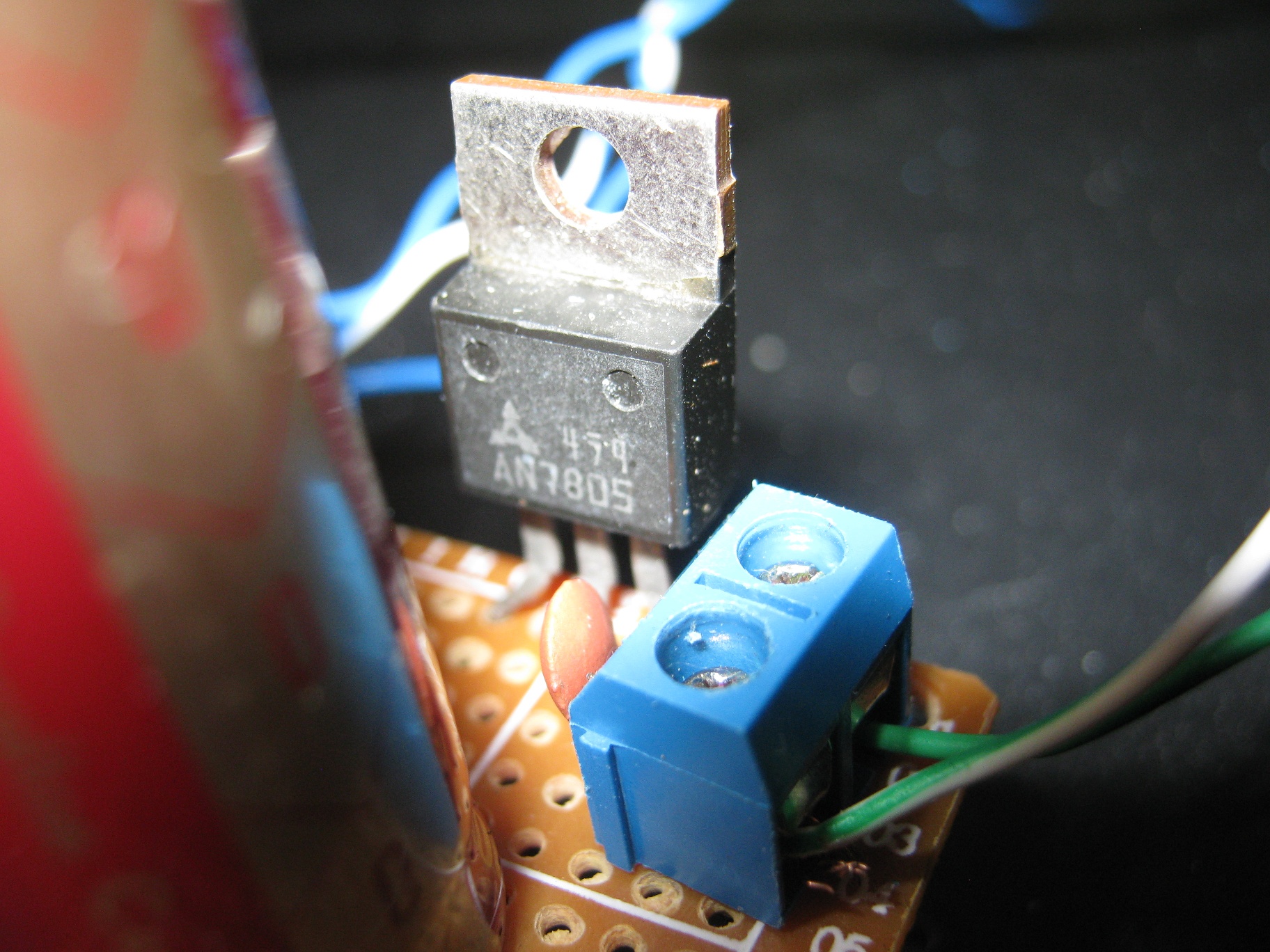

Also pictures of what a 100% Genuine AN7805 looks like. (Pulled from a parts bin that dates back to the 1970s.)
The Genuine AN7805 is dedicated for Analog Power supplies only and solely feeds the TDA1543.

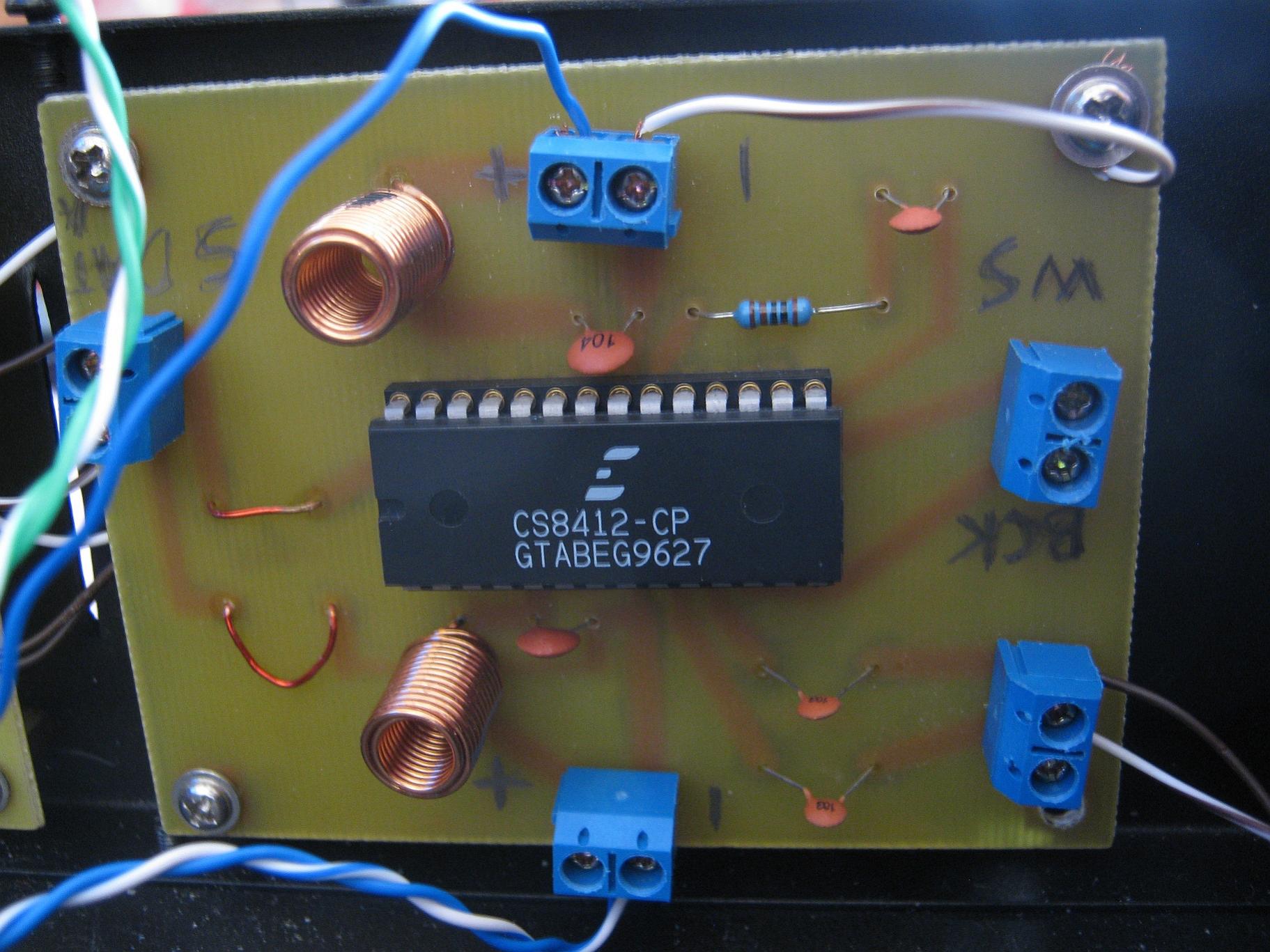

I did have extensive problems with digital noise appearing on the analog side however properly earthing each stage to each other solved these problems. Also earthing the CS8412 to the chassis solved the final problem.
It was interesting listening to the storm of digital noise which we know is there but we cannot hear. It went silent during transitions and came on like a storm during loud passages.
I resolved the earthing problems in 3 stages.
First I did some research and read a post regarding properly terminating I2S lines with a 0.01uF ceramic capacitor across the SDATA and Ground. This ended up not fixing the problem.
Then I realized that I really should have dedicated earth lines for each I2S wire, BCK/WS/SDATA, So I ran 3 pairs of wire from the pins of the CS8412 and terminated all 3 earth lines at the earth on the screw terminal of the DATA/GND on the TDA1543 Board. This improved things gradually.
Then I realized that an earth wire coming from the CS8412 power-earth terminals to the chassis improved things considerably.
The problem primarily is that I don't have my BNC analog outputs and digital SPDIF BNC connector floating from the chassis (The washers that I need to do this with are playing hide and seek), So I'm assuming (correctly hopefully) that all of the digital noise was going through my analog stages and through to the chassis.
