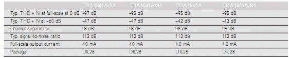

Is there any way that a tester could be put together to test chips to the double crown standard (other than using your ears)
Trouble is, afaik, Philips never published the S2 specification. The best we have is from the February 1991 datasheet:
TDA1541A/N2 (ie. the plain old TDA1541A):
bit 1 - 16 Edl < 1 LSB
TDA1541A/N2/R1 (ie. TDA1541A R1)
bit 1 - 16 Edl < 2 LSB
TDA1541A/N2/S1 (ie. TDA1541A S1)
bit 1 - 7 Edl < 0.5 LSB
bit 8 - 15 Edl < 1 LSB
bit 16 Edl < 0.75 LSB
(Edl = differential linearity error)
We can only assume that the S2 grade has a specification that betters the S1. 😀

musicomputer said:
Trouble is, afaik, Philips never published the S2 specification. ....
Perhaps a way to test the chips would be with an audio test CD that has various waveforms (ramp/sine/triangle extending over the whole digital range) and measure the monotonicity of each step on the analogue output?
Not true!!
Will post specs later!

I think the picture that QSerraTico_Tico posted is one I posted up a couple of weeks ago. The clip comes from Philips' 'Semiconductors for Digital Audio, a designer's guide 1997'. It's quite an interesting document, comparing most of the Philips DAC line.
