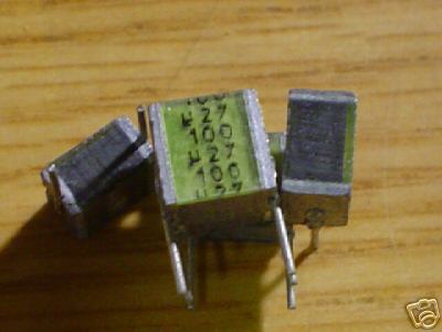

Could anyone advise me if these Siemens caps are good for TDA1541A decoupling?
The part number is B32540 but it is obsolete so I can't find much info about them.
I think they're stacked polyester, medium quality. I would try something better if I were you, but sure, they would work ok. Cannot comment on the sound quality...
