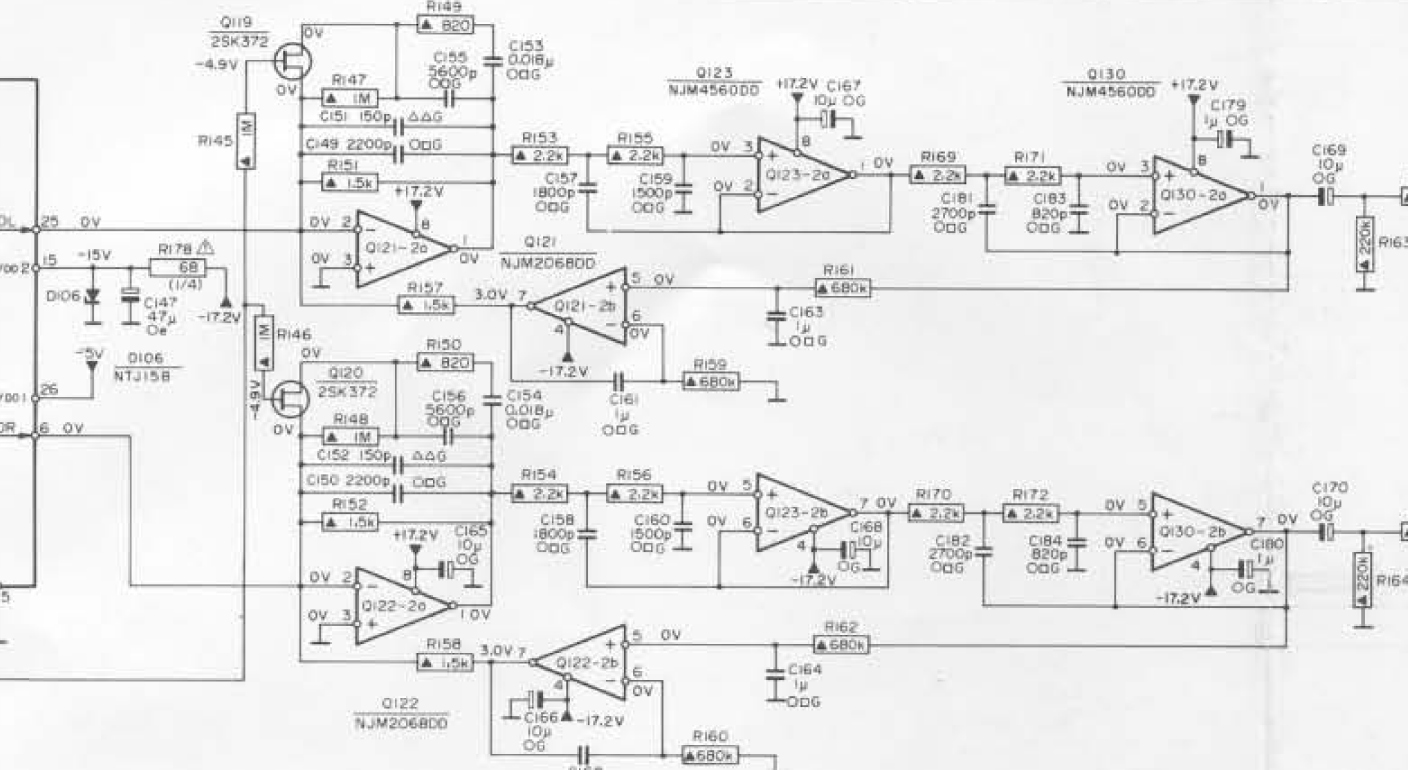

Yes it samples the output and compares is with ground, see the diagram.
That's a classic DC servo to maintain zero volts on the output... which is then (correctly imo) AC coupled anyway.
I wonder if the FET switching for de-emphasis introduces a shift in offset if there were no servo to correct it. I imagine it would be very very small though.
