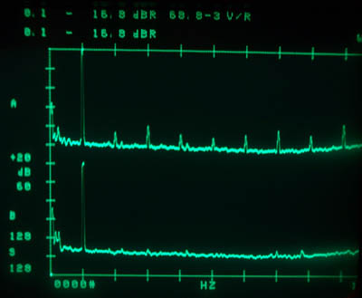

Thank You Berhnard, I have a Sony CDP with PCM56s and will them, when I've got a spectrum analyzer /or a soundcard suitable for that/ Now I prefer far ahead the external AD1852 based DAC; both CDP abd DAC have low-jitter Clocks.
I also do not like the analog section of the CDP, but I'll make the adjustments first.
Btw, I've seen many old /and good/ players with PCM56, and I alone have sent some PCBs w. PCM56 to the basket
