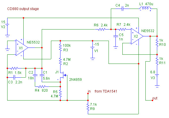

Till,
thanks,
was it you who wants to use AD1865 ?
I think the main problem is that it needs 18bit input.
The SAA7345 could provide that, if you find a CDP with that chip...
Put a 220µ/10V Oscon close to the SAA7220 today.
The output stages of the Philips CDPs have 3,4V DC offset
So they need a coupling cap
What about the modified schematic below ?
There is a voltage divider in the feedback loop with one end connected to 6,8V instead to ground.
So DC offset on output is eliminated.
And some gain is provided.

Can I throw out all parts, except X1 & R1 ?
I would throw out all parts and start again with a discrete I/V like the ones Rbroer designed. Better do it right directly instead of doing it only half good and needing to work on it a second time. Now don't ask me which thread please.
