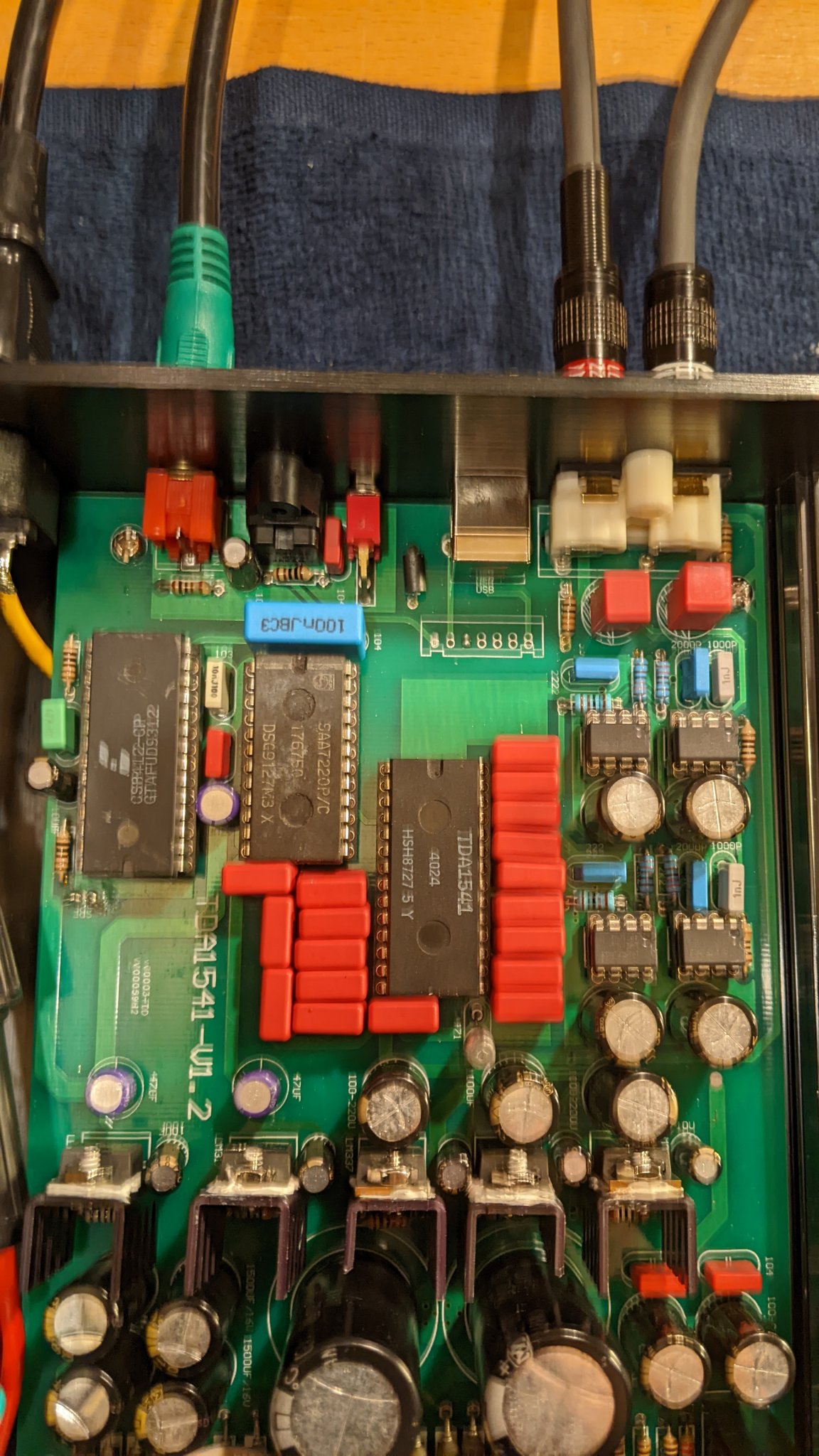

Hey all! Not much experience with DAC design, but got a question - I have a TDA1541 based DAC - all voltages appear to be per design. No output to OPAMPs...is it possible to have bad (fake) TDA1541 with all pin voltages correct?
DAC Input to CS8412, SAA7220 to TDA1541. LED lights for good Signal lock on TOSLINK and COAX Digital input. Just no output either channel

Its one of those TDA1541 Kits you see all over the net...I do not have the formal Schematic...but will continue to search...The OPAMPS getting proper voltage, and the TDA1541 also has right voltages at pins too.
I used a Probe and speaker to trace analog out of TDA1541 / input to opamp...nothing there, so must be at SAA7220 or the CS8412

The TDA1541 has a current output that is normally connected to the virtual ground input of a transimpedance amplifier (typically an op-amp with a resistor and a capacitor). Ideally (*) there shouldn't be any signal voltage at the op-amp input, only at the op-amp output. Is there any signal at the op-amp output?
(*): With a theoretical ideal op-amp there would be no signal voltage at all, with a real-life op-amp the signal voltage at the op-amp input will be very small indeed, typically 500 to 100 000 times smaller than the op-amp's output signal depending on the audio frequency.
Ha, just replaced the TDA1541 and she fired right up...I suspected the DAC chip...
