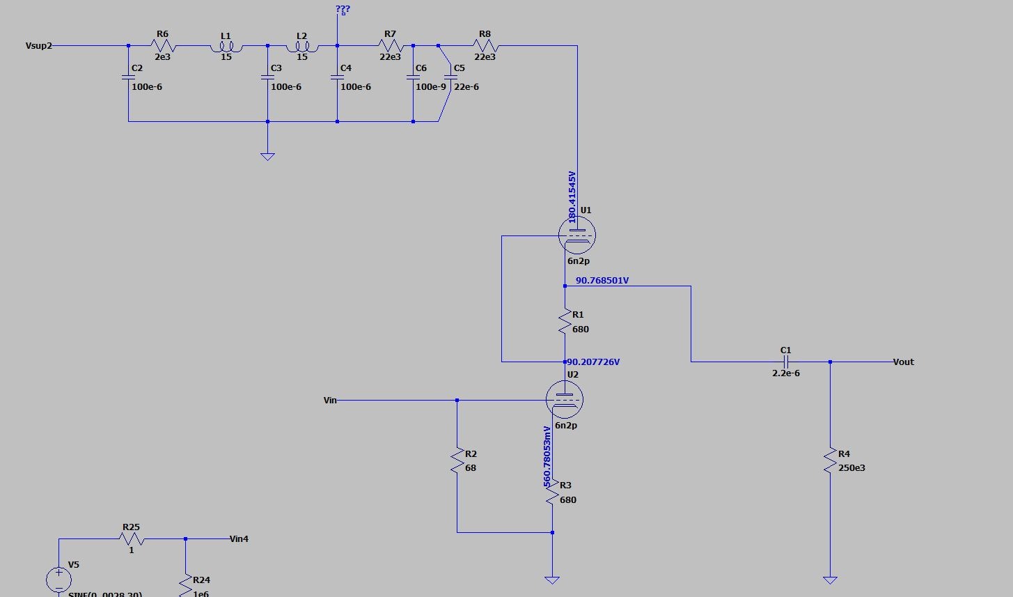

I've been using the Lampizator circuit attached to a TDA1541A DAC for about a year now. I'm very happy with the deep sound it produces and it suits my music taste which is mainly vocals and strings. Therefore I've never really tested it with a VTVM or oscilloscope to see how the FR is, I was just happy with the sound.
Out of boredom, the other day I've measured the FR and it looks way out of specs. I have 2 of these units built and both of them have the same lazy specs. Basically the curve is not flat at all with about -5db at 10KHz and -11db at 20KHz. The sound it produces doesn't really seem to reflect these number though unless my ears are getting really bad. The same numbers are shown on the VTVM and osc.
The TDA1541 has flat FR. The coupling cap is a ClarityCap.
Just looking at this circuit, does it scream crappy FR? Is there something I can do to improve the top end or that's just how this circuit works? I guess I have a case of FOMO.
Lampizator has a couple of circuits, one with 6N1P and another with 6N2P. I'm attaching both of them as well as the power supply schematic used, I've tried both and they both have the same FR.

The DAC is on one of those boards made specifically used and commonly used by others. It comes out of China. The DAC board is attached via usb to a volumio box (streamer). Signal generator is my iphone attached to volumio via airplay.
I have used the Lampizator1 circuit attached in the first post. The values are exactly as in the diagram using a 2.2uF for the coupling capacitor. Adjusted the power supply attached to match the volt values as in the circuit.
The FR has been measured at the grid and it’s extremely flat. It was measured with vtvm and osc. Phone is at maximum volume and the signal at grid is about 70mV at 1khz.
The FR was also measured at the output behind the cap. This FR has a high end roll off of about -11db at 20khz.
LTSpice modeling shows a flat FR but I’ve learned that simulation is not very accurate, at least the with the tube circuits i’ve played with.
Let me know if you need other values.
Again, I’m happy with the sound but i’m suffering of the fear of missing out and wondering if the already amazing sound could be made even better. Also, if the input at the grid is flat shouldn’t the output be quite flat as well? I mean the circuit is quite simple.
I’ve built other tube preamps that are +/- 1db but sounds a bit bright and sterile.

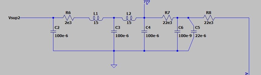

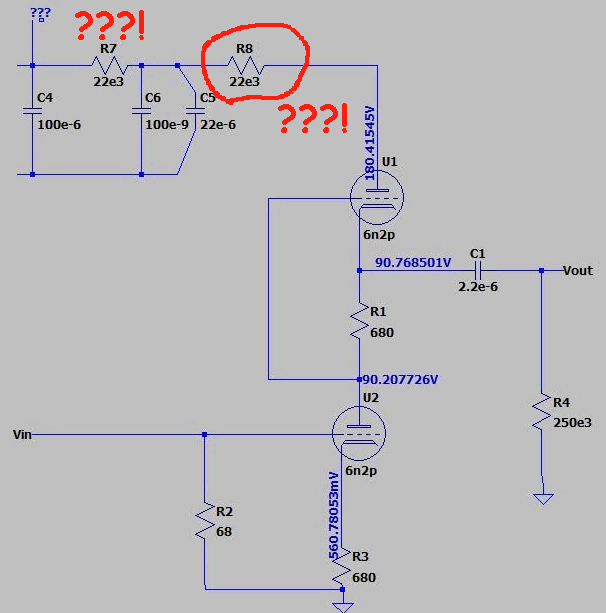

PRR, obviously i’m a nube. Would you please show on the schematic where the bypass cap at the plate would go and what size?
The PS schematic is from other tube amps and I thought they’re just a bunch of filters. Is there something wrong with it? The power source is a smps which can be quite noisy but it delivers 300v and 0.6A.

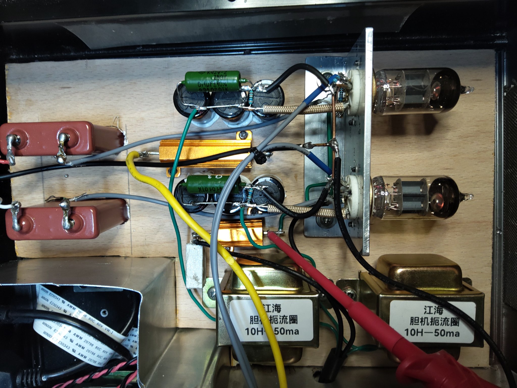

Hi . I usIng 6n1p for my dac tda1387 x8 (rpi hat). What i tested need very low resistor from grid to ground 27r and going try even less to lower output lvl . lampizator mention that , but he been using x4 with 30r .
Ive ordered 6n2p and gonna try them later .
I have to double my capacitance to get rid off hum (picture). Probably doing something wrong , but cant figure out .
You using 6n2p but cathode resistors you have from 6n1p circuit 680r , but it should have 200r.

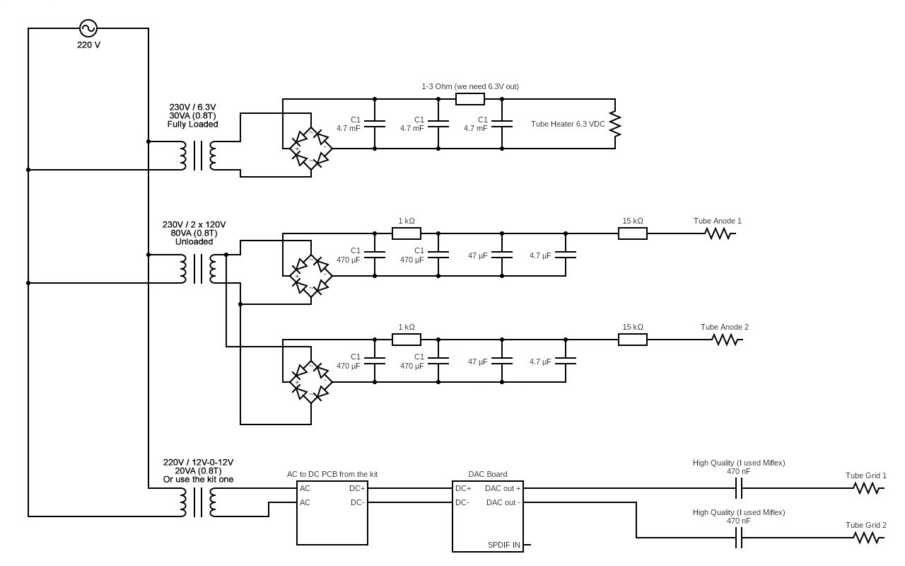

Psu im using :

Get rid of the 15k resistors (same problem as the OP with 22k resistors). The output from the power supply (from 470uF cap) needs to go directly to the top anode in the SRPP. Also, the original Lampizator PS has 820uF after the rectifier.
