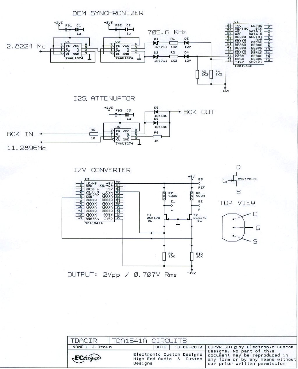

also for dem clock (grundig method), i noticed that streaming from bck produces more round-earth tda sound where as from ws there's less of the tda house sound and more refinement. for now the clock is fed from ws.

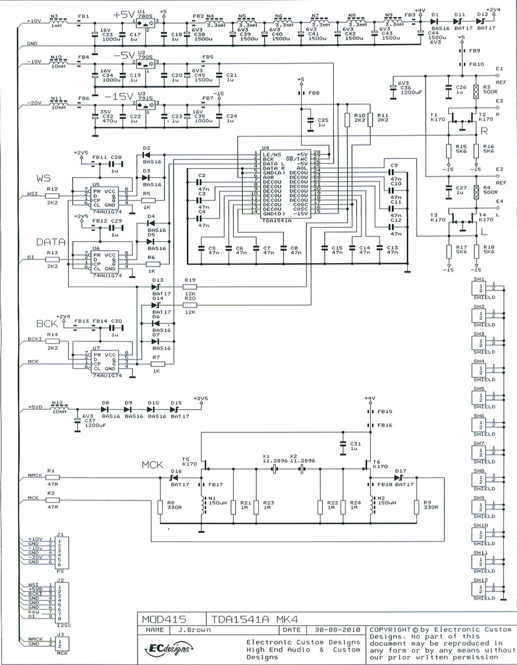

on john b's output diagram, i'm guessing 500r is the variable resistor. if so is 500 min or max value?
thanks for your patience with this beginner so far 😉
ah, the actual 500 ohm I/V resistor, yes you can change the value. In my case I use lower R I/V for my AD1865 since the final stage is tube with gain. Tantalum resistor is best here imho
better use schematic below from John to avoid confusion on DC coupling
look at right upper section there, but you must provide a variable voltage at point E1 & E2 similar to second schematic. PM me if you want my implementation on this
how about that? no more expensive film cap 😀

whats the purpose of 1uf and 150pf? i had something similar in my premade discrete circuit. taking them out improved the sq with no adverse effects
