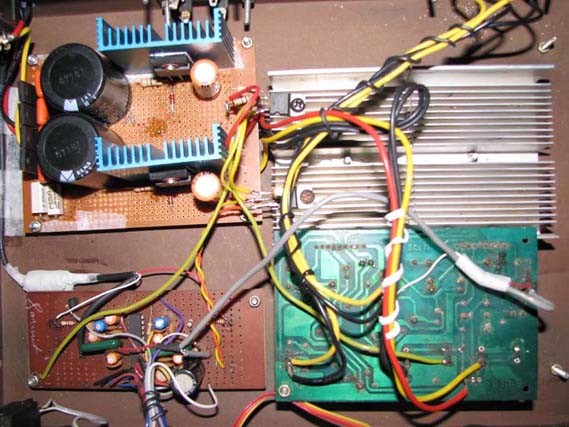

I have a home made TDA1514A in dual mono configuration it's arnd 10 yr old , but i stil play it as an amp for my PC. Speakers though are new ones ( Polk audio RTi A1 ).This based on the philips application diagram however, plays pretty loud.
PCB was from a local kit supplier "visha".
supply voltage +- 25v regulated ( primitive pass transistor and zener )
here's a pic
here's a pic
