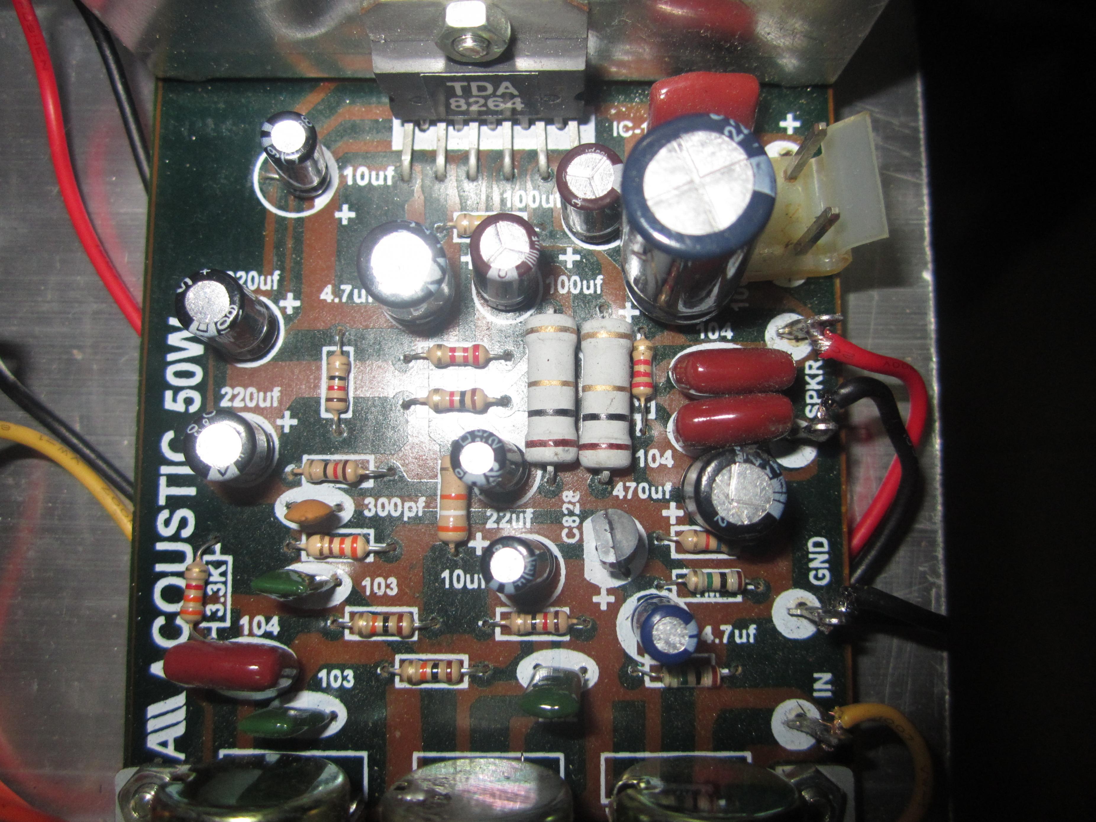

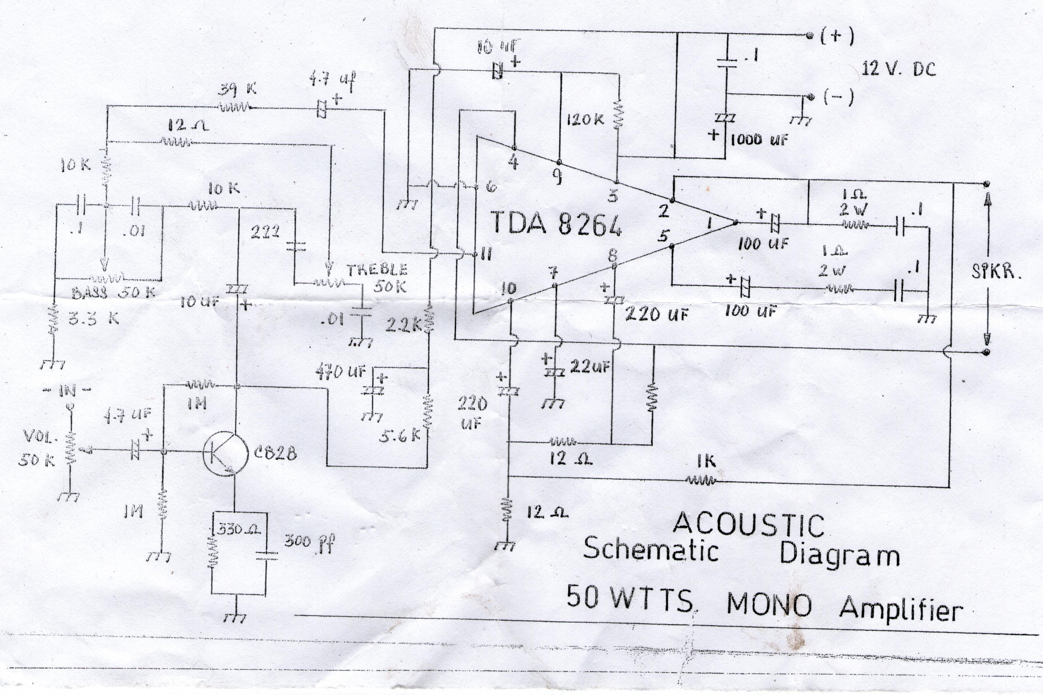

Hello there everyone, just got a TDA8264 amp, but the problem is, it keeps on humming. I need your inputs on how to improve this circuit.

get rid of the tone controlls.
and post pictures of the actual circuit built.
prehaps grounding issues, re-routing /planning grounding scheme to star ground would make improvment.
a ceramic cap from pin 11 to gnd might allso helps.
220 to 330 pf value.
