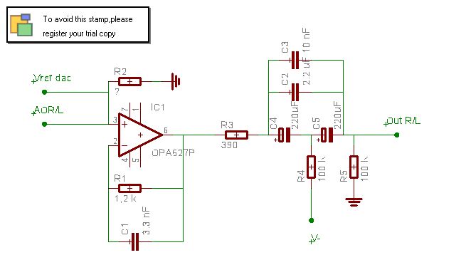

How about this active I/V stage?
jean-paul said:
edit: Mmm, you edit your posts faster than my eyes can move; I swear I saw a turntable pickup just a minute ago.
No really!! that can`t be right ?????? :clown:
Well I had some problems posting the schematic, and yes the pickup was there for a short moment....
What`s wrong with the schematics? (I`m not an EE so you have to, or could at least try to forgive me :)

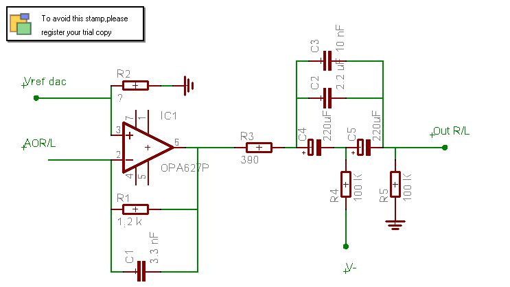

Re: Schematic error....
Chris said:
This should be more correct..?
Please, what else is wrong? I can handle it!
Hi Chris,
I can't see much wrong, except orientation of electrolytics. It is very much like the TDA1543 datasheet.
With +5V supply for the DAC I am using R2= 3k3.
Do you need that large output caps? I mean the electrolytics. The opamp has low output impedance and you could lower R3. I am using OPA 604 instead of OPA627....And an 0.47µF Audio Note paper in oil copper foil.

Thanks Elso and others... :)
Yes the circuit is mostly from the tda 1543 datasheet. Would you change it in any way to improve it (R1,C1)?
R3= how low?
Why is it not active(no ref to ground in feedback loop?)?
Only high quality 0,47 uF cap at the output sounds good.

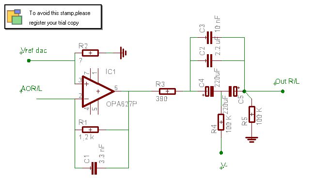

Hi Elso, how do you figure the (3K3) value for R2? I want to try this IV stage, but I'm having a hard time understanding this current business. If you (or someone else) could spell it out for me, please?
Re: Re: Re: Schematic error....
Hi Mad_K,
I put a pot a Vref and observed a 0dB sine wave on the scope. With a low value of the pot I could null the offset at the output but the sine wave was distorted. With some safety margin I got at 3k3 for the least offset and a undistorted sine wave. I also found the 3k3 resitor in Philips players using the TDA1543. The value is not given in the datasheet. Also note this is for +5V supply and using active IV-conversion as in the datasheet. If you connect the non-inverting input of the IV-opamp to ground, and not to Vref you get much more offset. I have about -1.6V DC before the output caps. Note I am using an inverting output buffer:cool:
