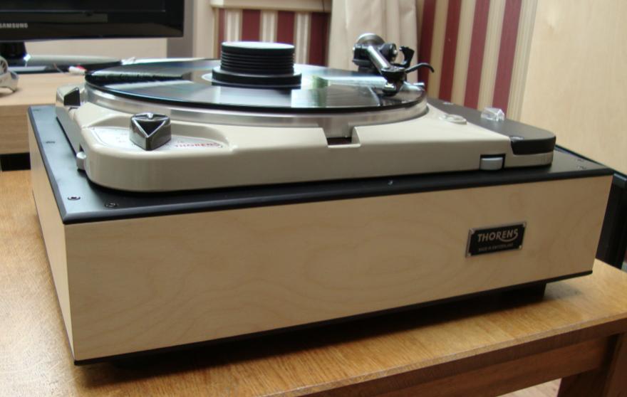

I had to adjust the eddy current break to near maximum level now everything runs so smooth.
A good sign all the oiling of turn table parts an revision of the motor had positive effect.
It is e real pleasure to play records on the TD124 works great sounds good. Looks professional with the aluminum frame. I was very lucky to find such a nice one.
Constant speed TD124
After a cold start the td124 is running to slow. One would aspect the speed depends on synchron motor and the 50/60hz of the main-supply this isn't the hole story I think.
Cold start? Yes in the td 124 the engine is warming-up. This temperature changes are responsible for speed variation that is what I think.
At my job I do a lot of temperature testing on switching power-supplies. The temperature rise of most medium power-supply with enclosure takes about 3 hours it follows a E-curve.
This means the E50 motor of the TD124 will run constant after 3 hours.
This morning I did the test.
After start the TT runs to slow after 2 minutes it is acceptable aft ten even better.
After one and a half hour it runs the right speed so the engine is so far in the E-curve that it end point for influence on speed so it stays constant.
That is the result of the Thorens being mechanical speed controlled and be affected by friction variation in the design.

All true, although the times you quote indicate motor service is probably needed. I assume you have not serviced the motor yet. It really, really makes a huge difference. Disassembly is comparatively easy and depending on bearing condition you can either clean and reuse them or replace them as you desire. (At minimum you must clean and completely remove the old lubricants.) I've done this on a number of TD-124 tables and once functioning nominally the TT is up to 100% of set speed in under 10 minutes from a cold start and is rock stable after that assuming an ambient of 20C or so. (Colder it will take longer) Also when completely cold it runs just a couple of % slow at worst. Take a look at my thread for information on overhauling the motor, and go here to see what is involved: http://homepage2.nifty.com/pantone/thorens/index.htm
In the previous pages you can see I did replace the bearing an felt rings and did buy a original belt. I have the eddy current break placed very close to the stepped pulley because the TT runs with very low resistance now, when I bought it it would not run slightly to slow and adjustment would not help.All true, although the times you quote indicate motor service is probably needed. I assume you have not serviced the motor yet. It really, really makes a huge difference. Disassembly is comparatively easy and depending on bearing condition you can either clean and reuse them or replace them as you desire. (At minimum you must clean and completely remove the old lubricants.) I've done this on a number of TD-124 tables and once functioning nominally the TT is up to 100% of set speed in under 10 minutes from a cold start and is rock stable after that assuming an ambient of 20C or so. (Colder it will take longer) Also when completely cold it runs just a couple of % slow at worst. Take a look at my thread for information on overhauling the motor, and go here to see what is involved: ƒg�[ƒŒƒ“ƒX THORENS model TD 124
But it cant help the motor to heat up for a longer period of time and with that being a influence on speed. Maybe when the new bearings have run in for a longer period it will change.
I found for about the first 100hrs motor performance did change significantly, and both the weight of the oil (20wt) and the amount present is fairly critical. (Lots of oil!) I also had to adjust the eddy current brake in order to not have the table actually run too fast - this I have not resolved to my full satisfaction, but the table runs dead silent on its slate plinth so I can't really complain.

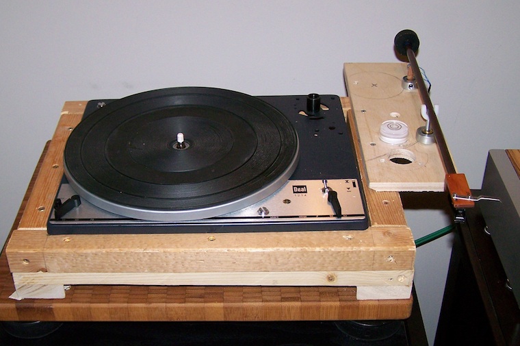

Stew I think this is the real DIY buy a low cost daul cs1200 series and build your own arm.
It would be good to put a well documented build of this turn table for youngsters as adults with little money to build real high end for scratch with your own hands.
At mine I had made a 8mm ax to lengten the pitch control and also the same for the speed control. It made a cool appearance.
Helmuth,
Your build looks very good and I must say shows your skill and esthetic preferences, which seem to mirror mine.
A well documented build was/is the idea. I had planned on writing it up for HiFiZine.com but have since resigned my position with them (5+ years writing for Affordable$$Audio prior to their merger). I haven't decided to create my owm blog (or ezine) or see what other ezine writing opportunities exist.
I am still going to document the build and do an interview with Jean on his ideas and concepts regarding idler wheel turntables. It had always been his contention that one need not start with a Lenco or Thorens or Garrard "big dogs". There are lots of changers that could be easily modified to single play manual turntables that cost very little.
What you see in my attached picture two posts back is absolutely crude, but sounds great. Once I decide on the design of a plinth, I'll get constructing and further listening.If the initial lstening sessions arre any indication I may have an Oracle for sale.
Besides the Dual 1214, I have a Garrard Lab 80 (without idler or platter but everything else is there), and a VM, as well as a Phillips idler in nice compact console stereo from 1961, but I'd like to leave the Phillips intact if possible.

Helmut, and what did you do with DUAL platter? I see it differs from the original. I'm experimenting now with very similar DUAL deck, and it handles easyly both double and triple heavier platter, with no signs of drag. I will stop with 5kg weight.
DUAL idler runs surprisingly well, with no noise or rumble. At least it is lower than record floor noise...
The metal frame was build in a heavy mdf plint. On top of that a 22mm mdf plate the platter disappears in the 22mm. Than I made a multilayer platter of felt rubber trespa mdf. To do this you need a extra long axle in the middle of the platter.
A-haa, now I understand why it looks the way it is. As for me, I've placed additional cast and machined 2,6 kg platter on the top of Dual own one , so together they are 5 kg, and also ordered extended spindle. Of course, the arm and the plinth will be replaced with something more decent.The metal frame was build in a heavy mdf plint. On top of that a 22mm mdf plate the platter disappears in the 22mm. Than I made a multilayer platter of felt rubber trespa mdf. To do this you need a extra long axle in the middle of the platter.
er...my lack of skill
