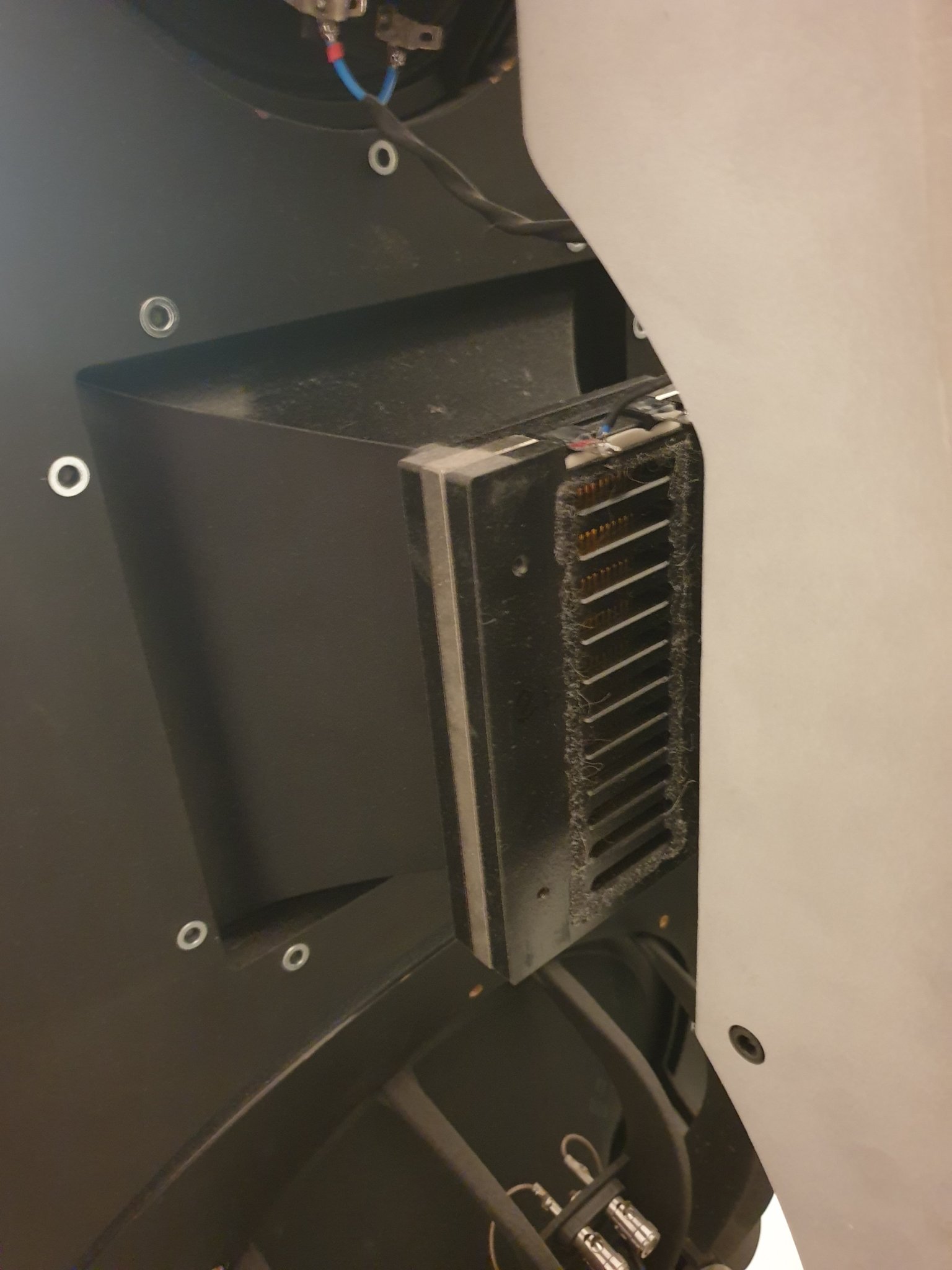

I think in general all AMT's respond better without a rear chamber. I noticed this with the Heil as well. Just a simple block of fiberglass at the rear to attenuate to taste works for me. Seems like the diaphragms don't like the additional pressure imposed on only one side with a rear chamber. Must have to do with how they work vs a regular cone driver.I did this on a pair of TPL-150. Did not notice any change in frequency response, but the decay got a lot cleaner, and THD greatly reduced. Both OB and large rear chamber will work.
How about comparing THD and CSD with and without the felt? Freq response it not the only important thing.....
I experimented with different types of damping and density. Each changed FR somewhat and distortion in the lower frequencies was lower overall. I ended with a layer of open cell foam (9mm thick) followed with a 30mm layer of regular fiberglass.

Can I ask you for a picture of the back of your OB? Trying to understand how you attach the TD8M/TPL panel to the vertical structure. I'm thinking about how to do mine.
StigErik,I did this on a pair of TPL-150. Did not notice any change in frequency response, but the decay got a lot cleaner, and THD greatly reduced. Both OB and large rear chamber will work.
