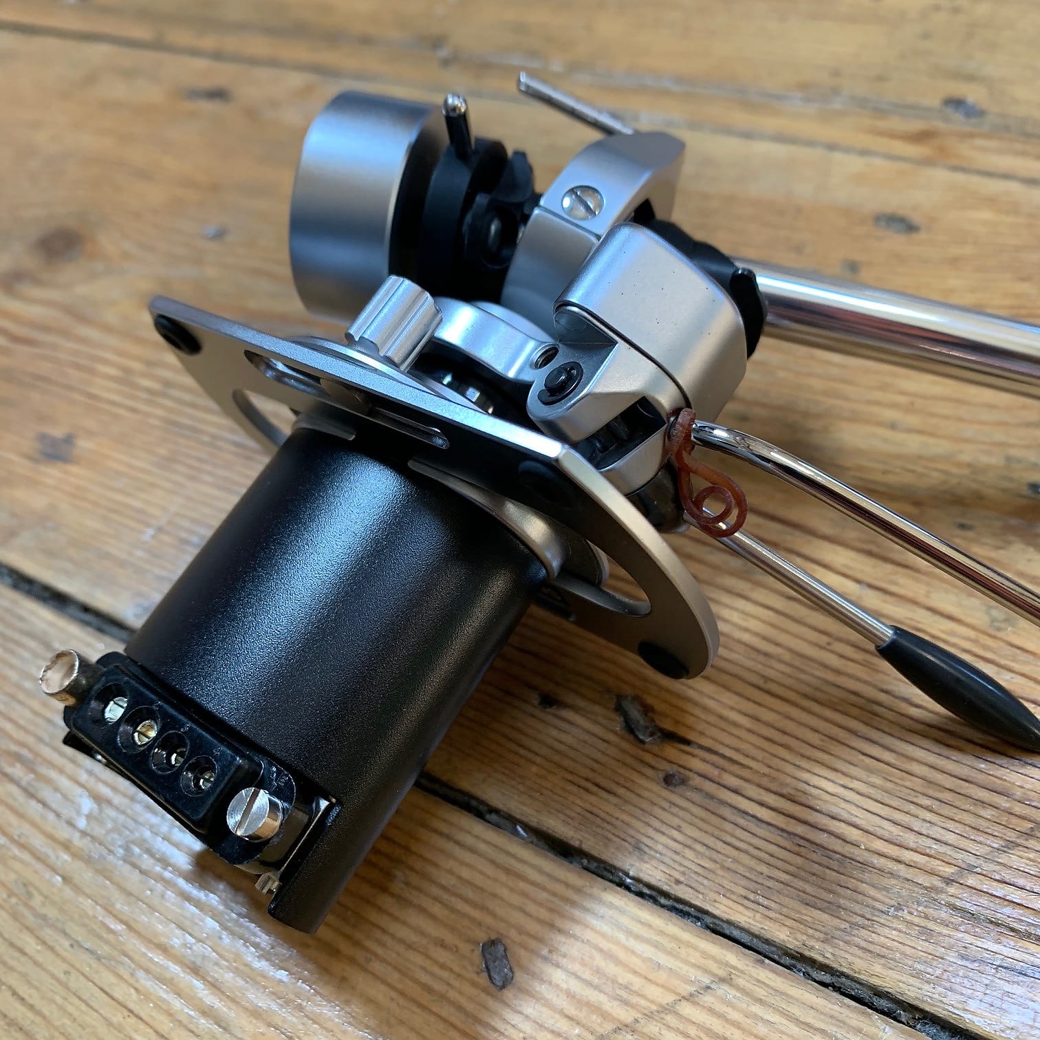

Yes, the separate chassis ground is normal and the only way it should be done. That is the factory connection. Make sure the tone arm is not connected to chassis ground and signal ground at the same time.
No problem!
Just make sure either signal ground does not have a connection to the tone arm ground or chassis ground. The tone arm should be grounded to the chassis.
Do you have a meter? Measure between the chassis and each RCA ground skirt, then to to tone arm and chassis. No connection between the chassis and signal grounds. Of course the turntable is unplugged from everything for this test.

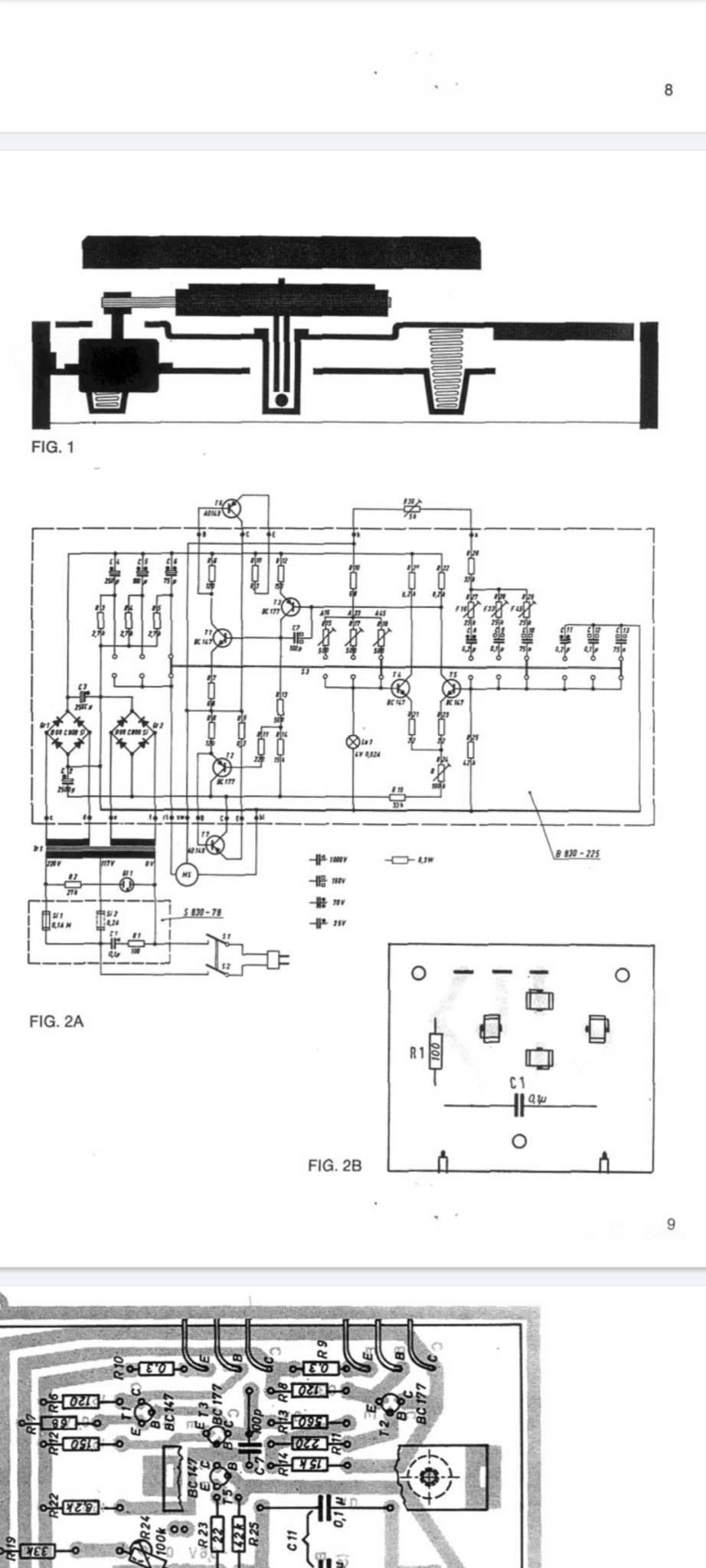

The TD 125 has spark suppressor/ snubber consisting of C1 and R1. Before doing anything else, check those components. Refer to the Linked discussion and the attached image.
https://www.vinylengine.com/turntable_forum/viewtopic.php?f=17&t=57656
The service manual is available for download on VE and electrotanya.
Regards
The spark suppressor is there to protect the switch contacts only. At worst this would cause a "click" or light "snap". Besides, you showed the TD-125, not the MKII. They are different.
Anyway, step #1 is to check the grounding as it is not the original tonearm. You do that first before removing parts to check them. Yes, you have to pull the part to properly test it. Step #1 is always understand how it should go together, then use your eyeballs to see if it looks right. Then use a meter to confirm basic connections are in fact made (never assume anything, prove it!).

The thump during on/off is almost certainly due to a failed suppressor. I have also worked on several tts and have not found this issue to be caused by anything else. I also have the misfortune of the output transistors of a nice amp being taken out by one such failed suppressor.

Whatever C1's type is, it ought to be replaced with an X2 grade capacitor, which is intended for connection across the mains live and neutral.
Farnell 2429368 is just one example - there are lots out there. Choose one that will fit the original holes - and remember to order an X2 safety capacitor.

The grounding scheme is correct, signals are not connected to chassis or tonearm ground (these are soldered to the 5th solderpoint on the sme connetor, signals have theirs, as in the pic...)
