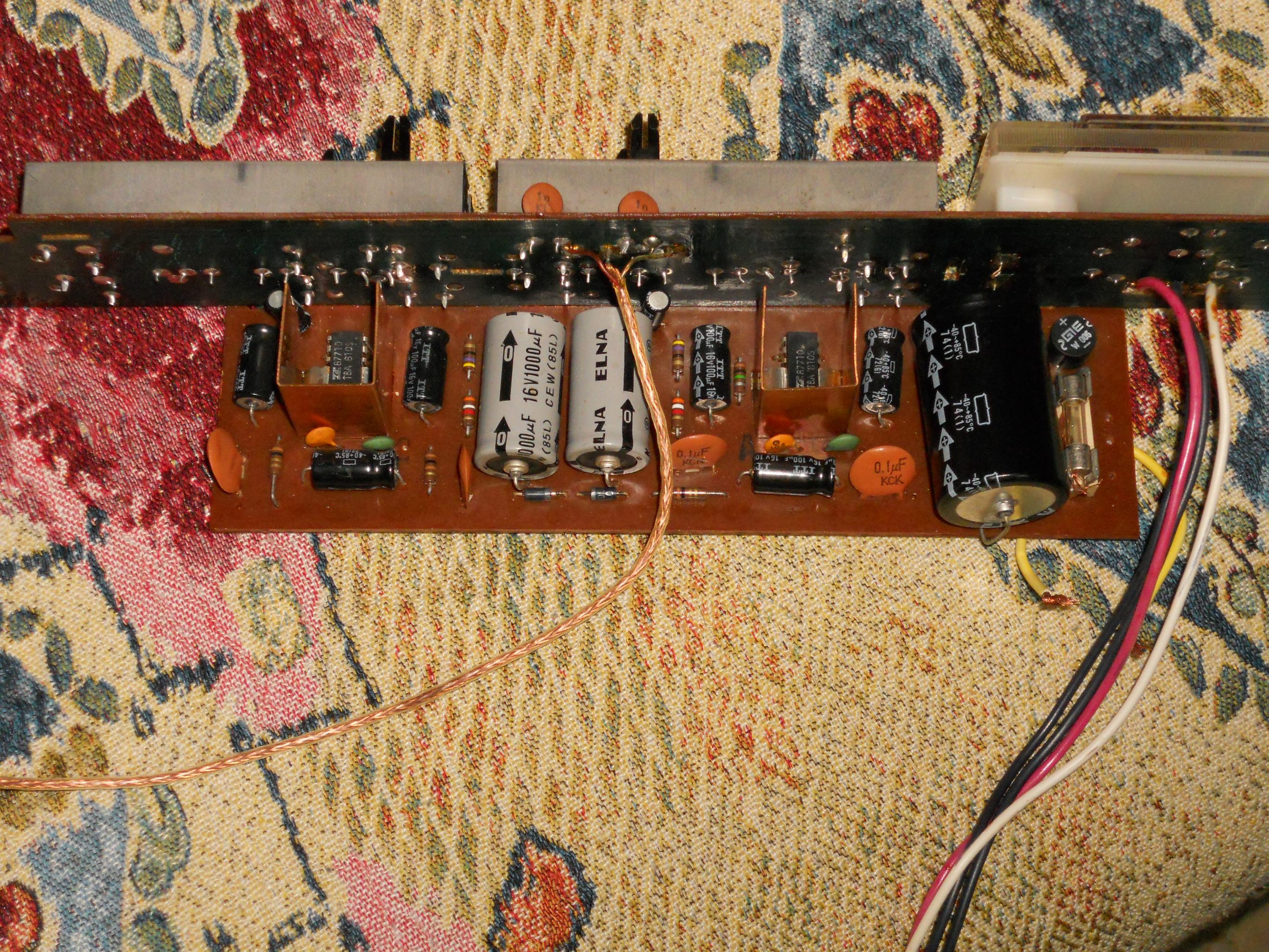

Hi Anti!
Please could you help me with your great knowledge?
Please take a look at picture of the amp circuit board (below)...well, could you see the two diodes behind the two grey Elna capacitors (the biggest ones on the PCB)?
On the body of these two diodes I can 1N4001 (and in the bottom part of the diode body there's another number: 710 if this can be an important information).
Could they have some connection to the vu-meters, in your opinion?
Thank you again Anti😉
regards
Yes. Driving VU and other AC Meters - Simple High Performance Circuits
It's possible that this is a VU connection. But it could be also a sort of some kind of "anti-pop" circuitry. Hard to tell. If your amp had VU meters, then this is probably it.
Don't dispair. Here's what I would do.
1) check and decide if you want/need any of "extra features" apart from your board being an amplifier. (like a VUmeter, whatever).
2) if you want "extras", check the connections that the board provides and try to trace your board to get the diagram of how exactly it is done on your board(s). In this case, I would suggest to visit a local service shop / serviceman to help you with the refurb if all of this is starting to get over your head.
3) if you don't want any "extras" and just want a "pure amp", determine which part-positions on your board belong to the core amplifier circuit AND the PSU. In this case, remove any un-necessary and un-related components to the core circuitry. Imho you can do this on your own; you can follow the schematic I linked and use it as a guide to determine "what-is-what-on-the-board".
To renew and refurb the core circuitry, you can follow the recommendations I have outlined in previous posts - these will help you get a little more "oomph" from the TCA (specifically those on electrolytics, resistors and the rectifier bridge).
One final note: I recommended to install 2200uF "output" caps. My "childhood" experience was that for some reason, this was the MAX value that the TCA "liked"; going above 2200uF (eg 3300, 4700uF) could for some reason kill the chip at the power-up.

Hi dear Anti!
As always, thank you for your moral and technical support!🙂
I believe that the best solution is to post a picture where I track the rail of the diodes on the circuit board.
Maybe it's the only way to understand their real function inside the amp circuit board.
