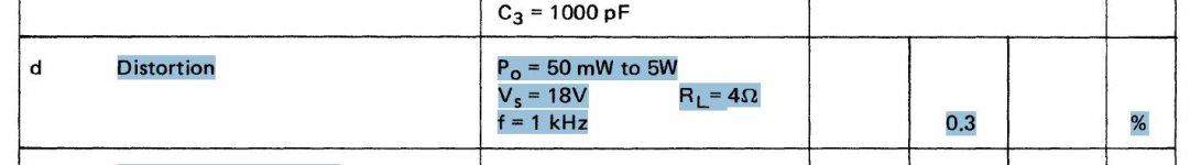

Well, I need to know the distortion value of the old TCA940 transistor at 8 watt (into 4 ohm) with a power supply of 22 volt.
Unfortunately I can't read this technical value in these sheets:

From looking at fig3 my guess would be between 0.3% and 0.5% at 8W/4ohm.
Thank you very much Abraxalito!...it's a very beautiful reply for me!!!
Frankly I suspected a worse value than 0.5%: it's incredible that from 0.5% of 8 watt, the distortion value increases up to 10% with just 2 watt more.
Thank you very much for your precious support!
Regards😉
You're welcome. My thinking is that rapid upturn in the graph is due to the IC entering clipping. With 4 more volts on the supply (22V vs 18V for the plot) we have the potential for a bit more output power before getting clipped. This is of course assuming the chip doesn't overheat...

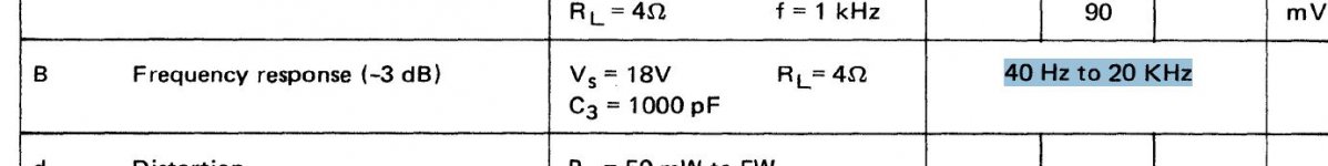

The frequency range of the chip under discussion begins only from 40 Hz.
And the distortion value of the old TCA940 chip is 0.3% only up to 5 watts.

Thank you very much, but I don't want modern amp like the 2009 even if they sound better, as you said correctly.
However, the distortion of the TCA940 is 0.3% up to 5 wat at 18 V as the schematic says, but with 22 or 23 volt are you sure that you can't get 7 or 8 watt with "only" 0.6% of distortion?
