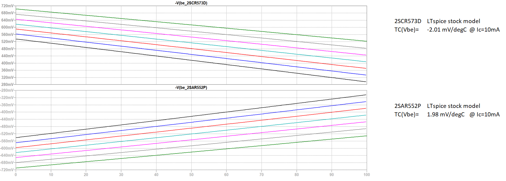

As a rule of thumb, TC(Vbe) is around -2.1mV/degC (NPN). Here are typical plots of Vbe against temperature for NPN and PNP devices at collector currents Ic ranging from 100uA to 100mA.
These are straight lines which open out slightly to the right; if one were to extrapolate the lines to the left, they should, in theory at least, all converge on the same point (~1.2V) at -273 deg C. All the LTspice stock models I looked at seem to be reasonably accurate in the way they model TC(Vbe).

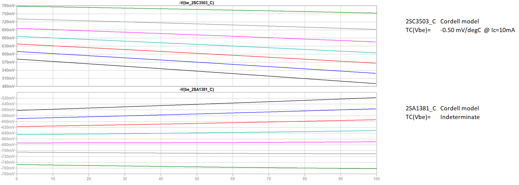

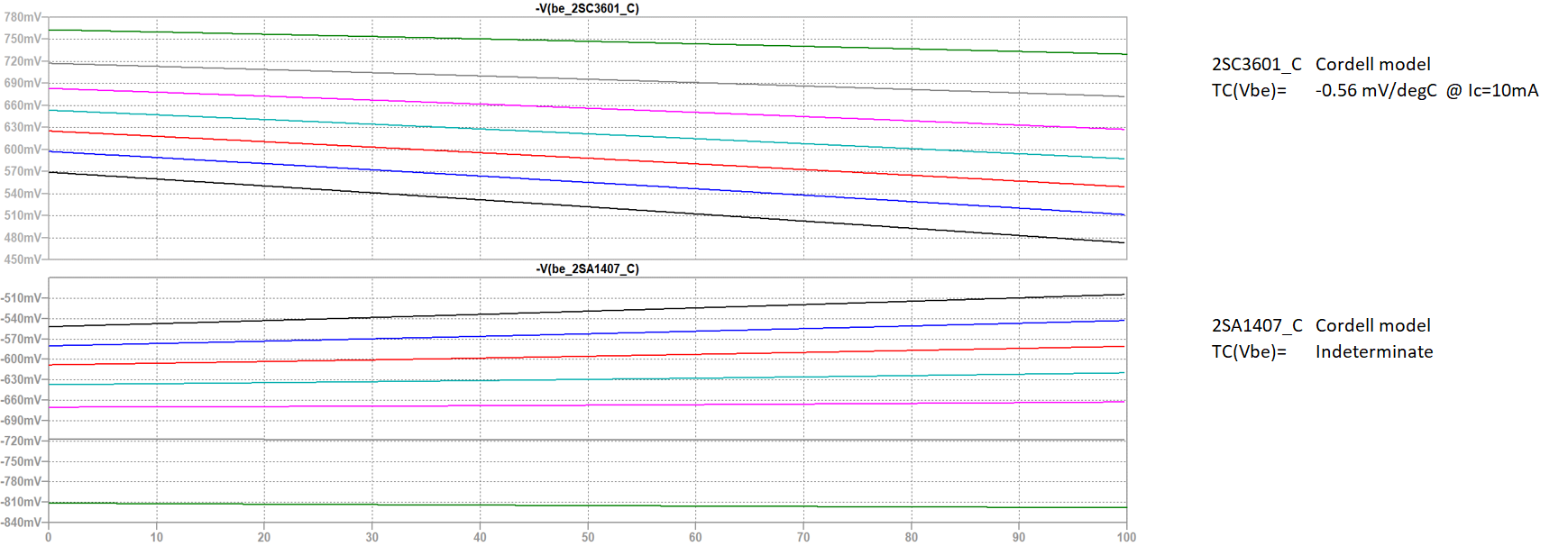

In contrast, here are the same plots using Bob's models for 2SC3503 and 2SA1381.

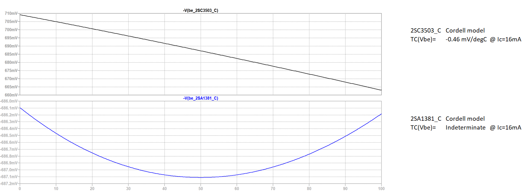

The 2SC3505 is only showing -0.50 mV/deg C. The 2SA1381 is even more confused with the gradient actually changing direction for higher collector currents; TC(Vbe) varies between 0.44mV/degC at Ic=100uA and -0.14mV/degC at Ic=100mA (note change of sign). Here is a detailed plot of TC(Vbe) for these two transistors at Ic=16mA.

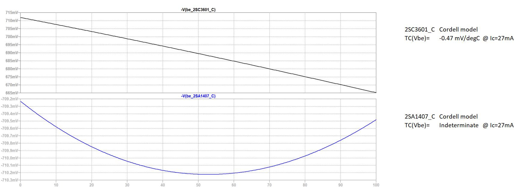

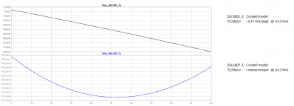

The plots for 2SC3601 and 2SA1407 show a similar pattern.
