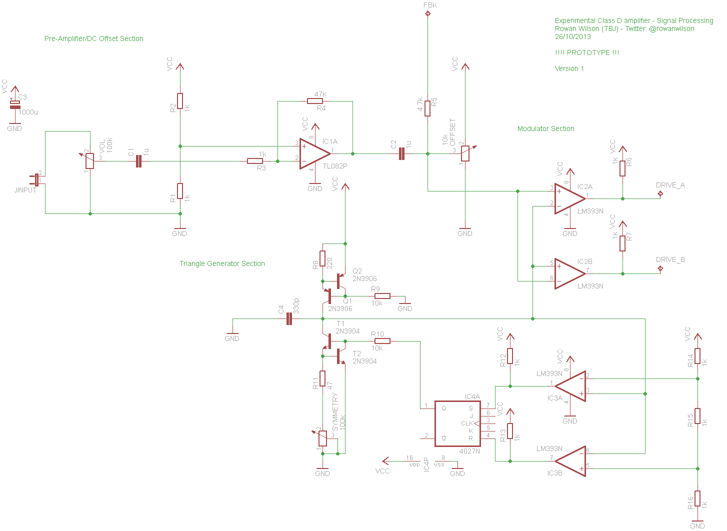

Modulator
The modulator consists of three main sections:
Triangular Wave Generator
The triangle wave generator is somewhat more complex than expected - it turns out that generating a nice clean triangle wave at 500kHz is rather difficult. You cannot use the classic two-op-amp triangle wave generator circuit because most op-amps are simply not fast enough - in the end I went with my own take on an idea that I'm sure I saw posted somewhere in these pages (unfortunately I can't find it now!)
In brief:
- Q1, Q2 and R8 make an always-on current source which charges the timing capacitor - C4 - linearly.
- When the voltage on the capacitor reaches the upper threshold point defined by the voltage divider made up of R14, R15, R16, the comparator IC3A switches HIGH, triggering the 'Set' input of the flip flop IC4A. (The two comparators and the flip flop can be seen as a Schmitt trigger).
- T1, T2 and the variable resistor form an adjustable current sink, which is activated by the flip-flop's output. The variable resistor needs to be adjusted so the current sink passes twice the current through R8, causing the capacitor to discharge linearly at the same rate as it charged.
- When the voltage on the capacitor falls to the lower threshold point defined by the voltage divider, the comparator IC3B switches HIGH, triggering the 'Reset' input of the flip flop. This switches off the current source.
- The capacitor is allowed to charge again and the cycle repeats indefinitely.
This section produces a very clean square wave of slightly less than 500kHz.
The trigger levels are approximately 1/3 Vcc lower and 2/3 Vcc upper.
R11 is just to stop you from blowing up the current sink if you tweak the value of the pot too low.
Pre-amplifier and DC bias
This section has three functions.
1. IC1A is an op-amp configured as an inverting amplifier. It amplifies the peak-to-peak level of the input signal to match the upper and lower bounds as shown in the diagram. The closer the peak-to-peak level of the amplified signal is to these bounds, the higher the duty cycle swing of the amplifier and the louder the output signal will be. Obviously the signal must never be allowed to meet or exceed these bounds or the amplifier will clip.
2. The output of the pre-amplifier is then AC coupled and fed through a bias network consisting of the pot "OFFSET1". The pot is adjusted so that the DC offset is equal to approximately 1/2 Vcc. The adjustment of the offset level is imperative - the amplifier must be set to run as close as possible to 50% duty cycle at idle, so that the averaged current flow through the speaker is zero.
3. Negative feedback is added to the pre-amp output (see the "Feedback" section further down). This improves linearity and reduces distortion.
Modulator
Producing a PWM signal from a triangle wave - image credit: Wikipedia
The triangle wave and amplified input signal are now fed into the dual comparator IC2A and IC2B to produce a PWM signal. The illustration above gives a clearer picture of the exact mechanism of the PWM signal generation (note that this image shows a sawtooth wave instead of a triangle, but the mechanism is the same in both cases).
Both halves of this IC are used so that both an inverting and non-inverting signal can be produced to drive the output stage.
Pullup resistors R12 and R13 are necessary due to the open-collector outputs of the LM393 comparator.

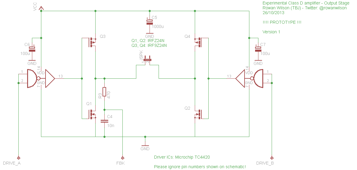

The output stage
The full-bridge output stage
Semiconductors
The output stage uses two P- and two N- channel MOSFETs. The IRFZ24N and IRF9Z24N devices were chosen due to relatively low cost and easy availability - I can see no reason why any other devices can't be used, so long as they have low gate charge and relatively low RDSon.
The MOSFETs are switched using Microchip TC4420 gate drivers. These are non-inverting drivers, hence the need for two drive signals 180 degrees out of phase. (See "To-Do" for more on this).
Other considerations
C5 serves an important function to prevent excessive power supply ripple. The value of 1000uF was chosen arbitarily and seems to work on my prototype - it may be prudent to add more filter capacitance here.
C6 and C7 must be as close to the gate driver as possible - driving the FET gates requires high current due to the capacitive nature of the gates.

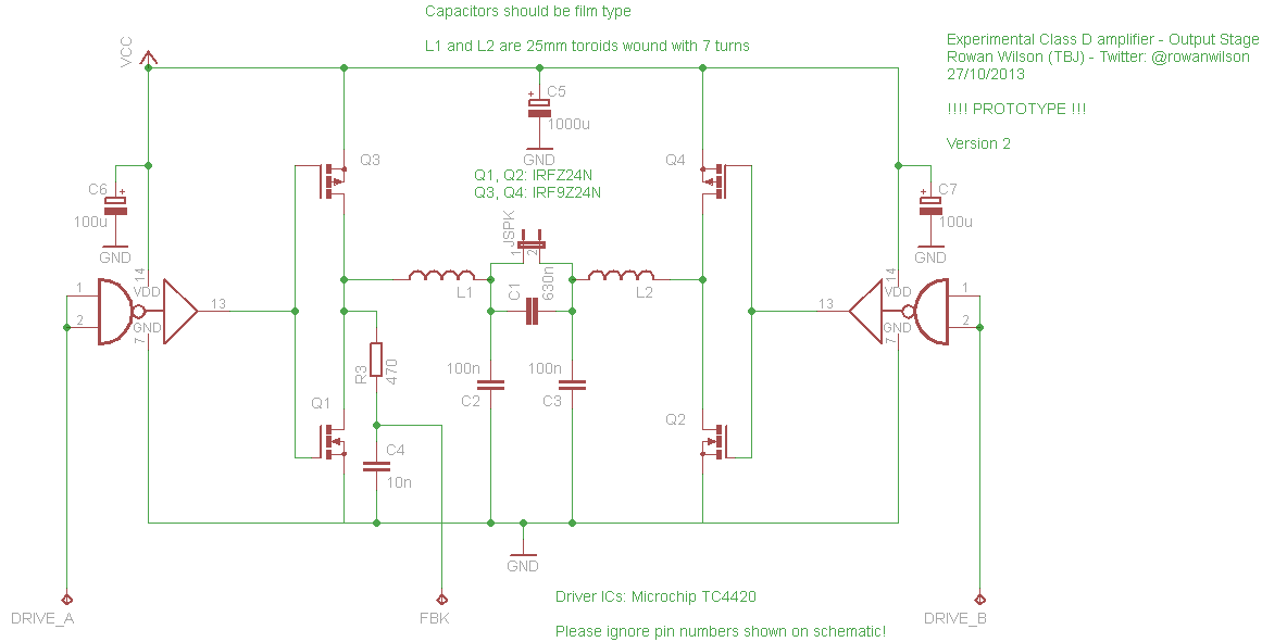

Output Filter
I am not too familiar with the strong points of LC filter design, so I have chosen a Butterworth filter with whatever components I had to hand that seemed to work. Capacitors are film types and the inductors are two toroids wound with seven turns each. Anyone that feels like doing so may wish to adjust these values - please tell me what works for you.

Full-sized schematics attached below
Correction: The symmetry adjustment pot should be 1k, not 100k!

Interesting project.
However, some observations.
The FET's have a gate threshold of about 4.4V and 4.2V.
With a 12V supply both FET's will be on at the same time for a short period of time.
When the drive is between 4.2V and 7.6V there will be current drawn from the supply that goes directly to ground through both FET's.
My estimate (i.e. guess) is about 5A peak.
You actually have negative dead time.
This will reduce efficiency and increase power dissipation. (and stress the FET's)
The plus side (or less negative side) is that you have a high current drive that will make this current spike very short.
and
The response time for a LM393 for a low level overdrive is 1.3uS and 0.3uS for full drive.
At 500KHz that might be a little slow.
I would find something faster, but that is just me.
Have fun.

Today I added an output filter - I edited details into the first post, but I have attached an updated schematic for the output stage to this post as I cannot edit my attachments on the original!
Shot of working amp on breadboard:
I have started driving a larger speaker with it - sounds good but for some reason the gate drive ICs are now getting hot. Might this be to do with the miller capacitance of the FET causing the gate to be harder to drive? I will try adding some gate resistors tomorrow and report back - I want to see if this solves the ringing problem too.
The drivers state 10,000pF. and an equivalent of 2.5R output resistance.
Your FET's are higher total C than that.
Look at the gate charge graphs.
Put 10R in each FET's gate. Limits gate current peaks and helps prevent Rf oscillation of the FET during OFF to ON transitions...(standard practice)
...strange...
The size of the speakers usually has not much influence on the gate drive losses.
- But stepping to higher frequencies usually does increase the gate drive losses massively.
- Also changing the supply voltage also is likely to impact the drive losses slightly.
- Filter vs. no filter might also have an impact.

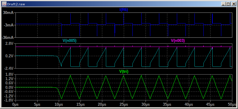

I've decided to reignite this project with the goal of building a car sub amp.
Currently in the process of testing (making a PCB this time as i no longer have the patience to build complicated circuits on breadboards!)
I have added dead time control and a few other improvements.
Will post schematics etc soon.

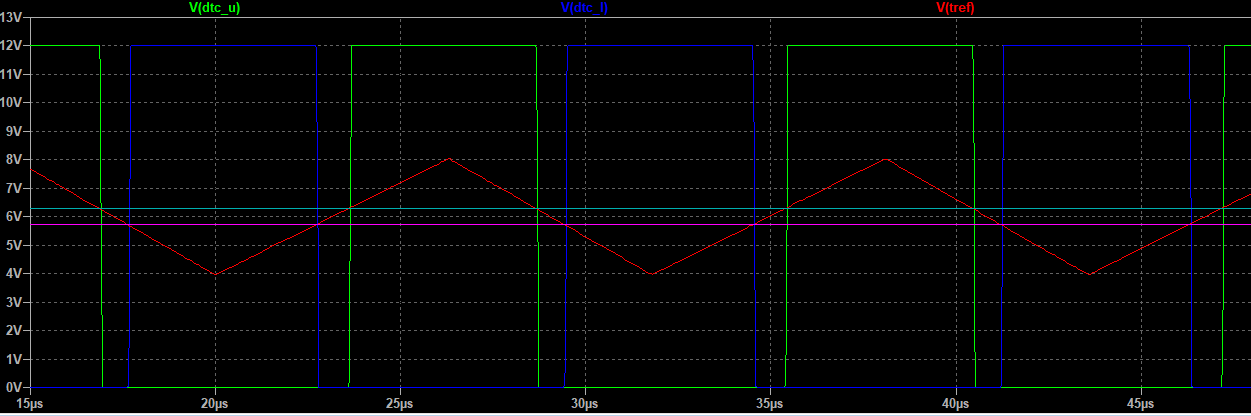

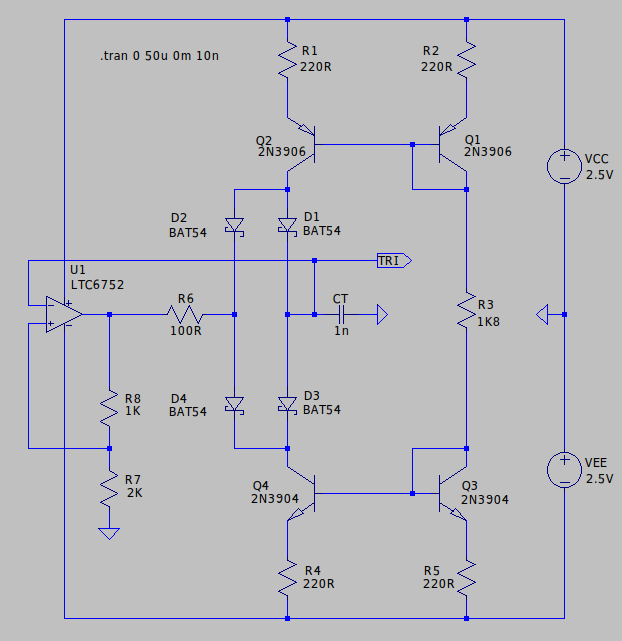

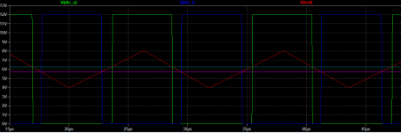

Here is an LTSpice simulation of the amp that explains my method for dead time control.
Attached asc file, a picture of the schematic and a picture of the simulation results.
I am still using LM393s for comparators at the moment but I am reducing the switching speed slightly (I am thinking 250khz is probably enough especially for a sub amp!)
There will be a new output stage designed to work at higher voltages, that is coming soon once I have built and tested the modulator.
How the dead time control works...
Essentially we are using the same triangle wave as the modulator section uses to produce an 'enable' signal based on upper and lower thresholds set by a resistive divider.
See attachment "DTU EXPLANATION"
When the triangle wave voltage goes above the upper trip point (cyan line on the graph - DTU) the comparator U3 output (DTC_U) goes HIGH.
When the triangle wave voltage goes below the lower trip point (magenta line on the graph - DTL) the comparator U4 output (DTC_L) goes HIGH.
When the triangle wave voltage is below the two trip points, both comparator outputs are LOW. This is the 'dead time'.
The size of the dead time region is controlled by adjusting R9 (set to 100 in the simulation - this will be a trimpot on the final build).
A logical AND is used to combine the DTC_U/DTC_L and non-inverting/inverting modulator outputs to create the final signals that go to the power stage. So when the DTC signals are in their LOW state, regardless of modulator output, the output signals stay low.
I hope this makes sense. I am pretty sure this will work! More to come soon.

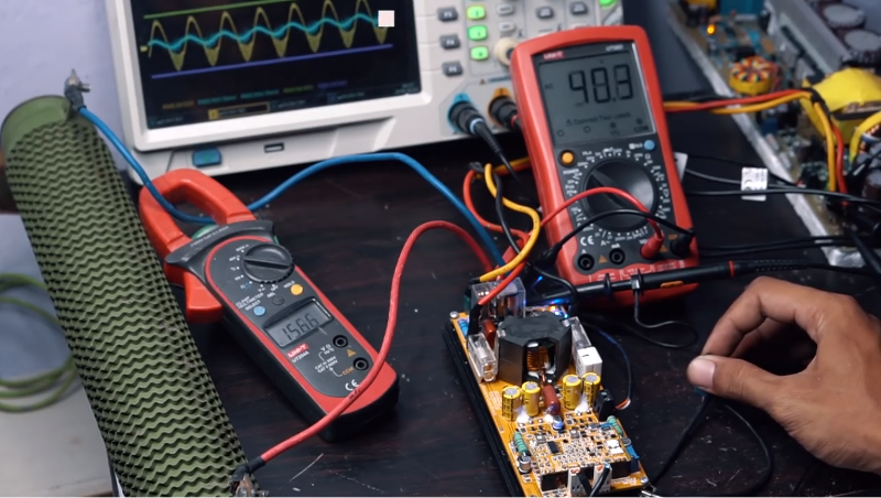

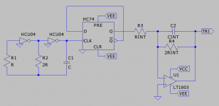

IMHO clocked amp has less benefit compared to self osc. But only few people will agree with this.
Sure... One of your designs?
YouTube
I guess self osc done right would not suffer from extreme asymmetrical fuzz on its output but that would involve some kind of insight beyond bodging bits.
Disabled Account
Joined 2005
YouTube
Yes he is so famous now because of yutub :)
Rather than people think that self oscillaton is so simple and ugly but it has advantages that self oscillation operation can adjust it self the switching duty continuously reflecting to output requirement.

Interesting design for a triangle generator. I think for now I will stick with my design though - current source and sink and a flip flop. It is stable and predictable and one can accurately control the low and high trip points and the symmetry of the triangle wave.
I agree that self oscillating does have its beauty but I just prefer the clocked design personally.
Kind of standard wibble. In terms of accuracy, stability and repeatability it's pretty good... as good as the accuracy, 1%, of the passives plus supply variation. One other source of error might be Rdson match of the N/P channel devices in the HC74 but for a 10K load that should be minimal. The sums are easier as well.
Your current sources are going to suffer from Vbe temperature variation and switching them on and off is kind of a bad idea. A more common circuit would be
