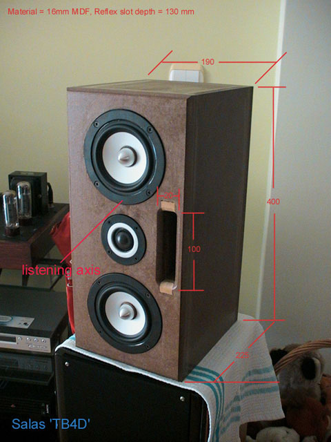

Here is a new design I want to contribute. I call it TB4D (Tangband 4'' double). Its cheap and simple to make. It is rather small and 90dB sensitive.
The drivers are Tangband W4-657SC (2 per speaker) and Tangband 28-847S for tweeter. They do offer great quality at the price (139 EURO for all 6).
I kept it simple. All drivers running the centre line, tweeter in the middle. Simplest crossover possible but nothing left to chance. Very good lobe and tight 50Hz to 20kHz monitor like response. Sounds alive but never irritating. Bass is great for the size. Transients clear as a bell. 3D imaging.
Look at the cabinet photo and you will see the dimensions too. Keep in mind that the reflex slot is mirror positioned for the pair to the outside of each speaker.
It is not veneered yet but I will rather choose a dark finish to highlight the magnesium cones. I eased the reflex slot lips as well as the edges of the box face. I used wool felt pads for damping. All drivers flanges are inset.
I also designed for a listening axis higher than the tweeter centre. So if you make a stand for TB4D it will not need to be rather imposing when the axis is targeting your sitted ear hight.

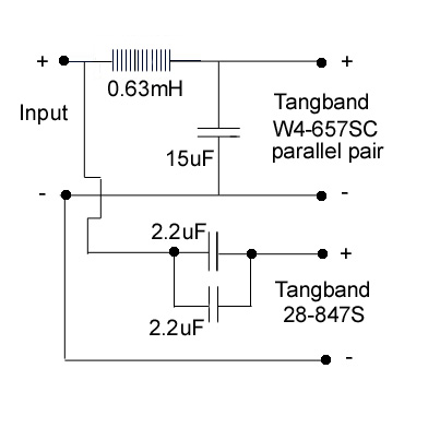

I used Visaton MKP caps and a simple 1mm wire air coil. No biwiring. If you end up liking it as much as I do and want to experiment with expensive parts, I feel it will respond. There are very few crossover parts anyway.
TB4D has potential for very good systems. Just give it 2 days to break in.

What XO point are you working at? I would be tempted to get the W4s to start rolling off before 7K.
If we push the cross to lets say 5kHz then the length between centres is too long. Also the mag cones will need a resonance trap. I have tried such and I prefered the 2.5kHz point for tight imaging, no mag nasties and crossover simplicity. The TB tweeter is absolutely capable since it is low Fs type and very sweet indeed.

Yes, of course. I was looking at the low value of the inductor and making a comment without taking into account the reduced impedance of the paralleled drivers. Looks good to me. I've played around with the W4 and it's not bad for the price.

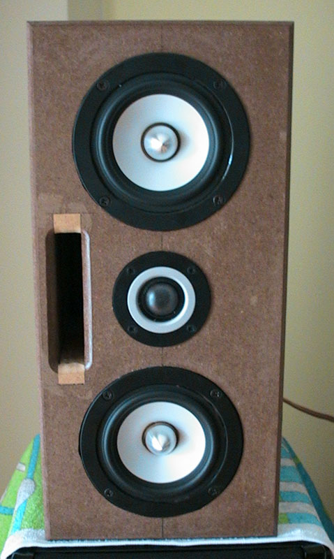

Does the port have internal dimensions?
and what are those light coloured blocks of wood in the port for?
Yes, as you can see in the photo, it has 100mm hight, 20mm width, 130mm depth. I use the cabinet wall for one side and I build the other 3 sides from same material. The colored wood bits are just a fix on an error at the exit's lips. Ignore them.

Thanks for the plans. After studying the Te-el, I must say I would not be tempted comparing to the TB4D. It achieves 50 Hz needing to be a 110cm floorstander with a back tail when the TB4D does 48 hz being 40cm tall. Then the Te-el is 88dB when the TB4D is 90dB. Its crossover uses 6 elements when TB4D requires only 3 (2.2//2.2uf counts as one).

The Grünanlage just underwent an update. Salas low pass filter is pretty close to the blue planet acoustic crossover but the tweeter really should have a 12 db high pass.
