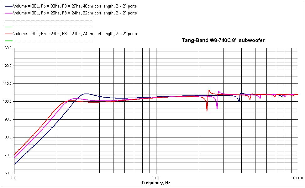

I'd recommend modeling the sub in Unibox: http://home20.inet.tele.dk/kou/ubmodel.html Its a free excel spreadsheet that uses an improved box model, and thus, has some benefits over WinISD and some of the other simplified box model programs.
If your enclosure volume is 30L, you've got the walls covered in stuffing, and you are using two 2" PVC pipe ports (which are 5.25cm internal diameter), then you'd need 42cm of port to tune the box to 30hz. I'm assuming you are cutting around 20 inches of sonotube? That means your ports would just fit as a straight line, since they'd be about 15 to 16 inches long.
If you are comfortable with a curved or bent port, then you might tune as low as 25ish hz, meaning a port length of 61cm, which would need to be curved to fit in the sonotube. Both 30hz and 25hz tuning would mean having a slight hump at the tuning frequency, and fast fall-off after that, but the 30hz bass boost in the amp will soften that up a bit.
In both cases, you run into excursion problems, and port air velocity problems at about 100W of power. Fortunately, 100W gets you up to 102dB at 26hz for the lower tuning, and 104db at the tuning frequency for the higher tuning, so thats pretty durn loud. If you want louder, you'll need a bigger driver. But for moderate to loudish volumes, that 8" should do pretty nicely!
Anyway, good luck, and let us know how it sounds in its final form! I'll be building one soon, so I'm glad you're pioneering for me. 😀
peace,
sam

I'm going to go with the lower tuning frequency...
Thanks for the advice, you rock!
