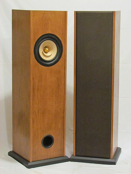

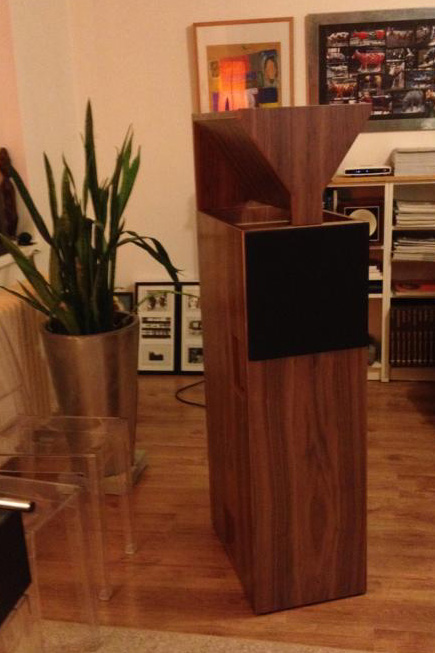

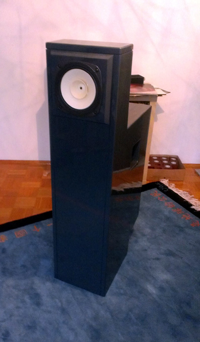

in Germany there is a shop with a lot of constructions for TB Speakers. For the W8-1772 i found 3 BL Designs:
I'm not sure if this is the TB Design:
Tang-Band-Horn-W8-1772
A detailed test was made in a german diy magazine (Klang und Ton, 01/2011).
Jericho - a well known BL Horn Design (in Germany) for different full range drivers:
Jericho-Deluxe-1772
Viech - also a well known BL Horn Design (in Germany) especially for low budget drivers, fc 70Hz:
Viech-Upgrade-1772
have fun

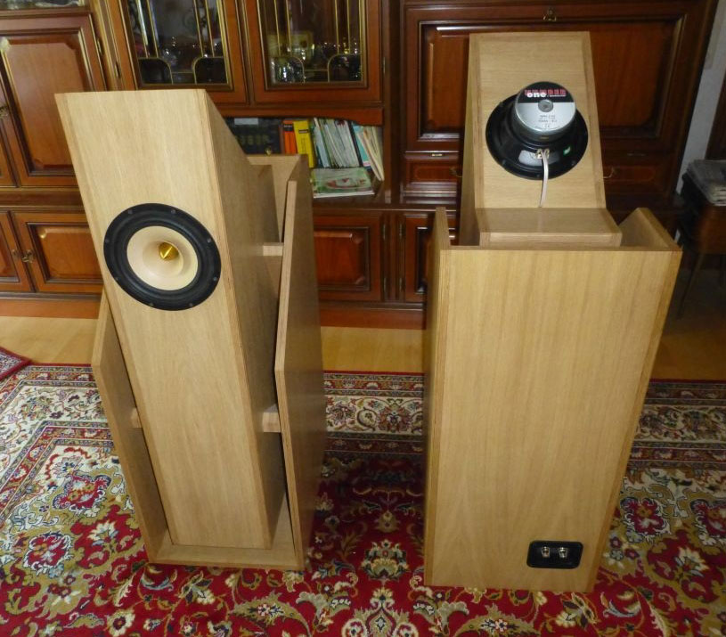

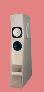

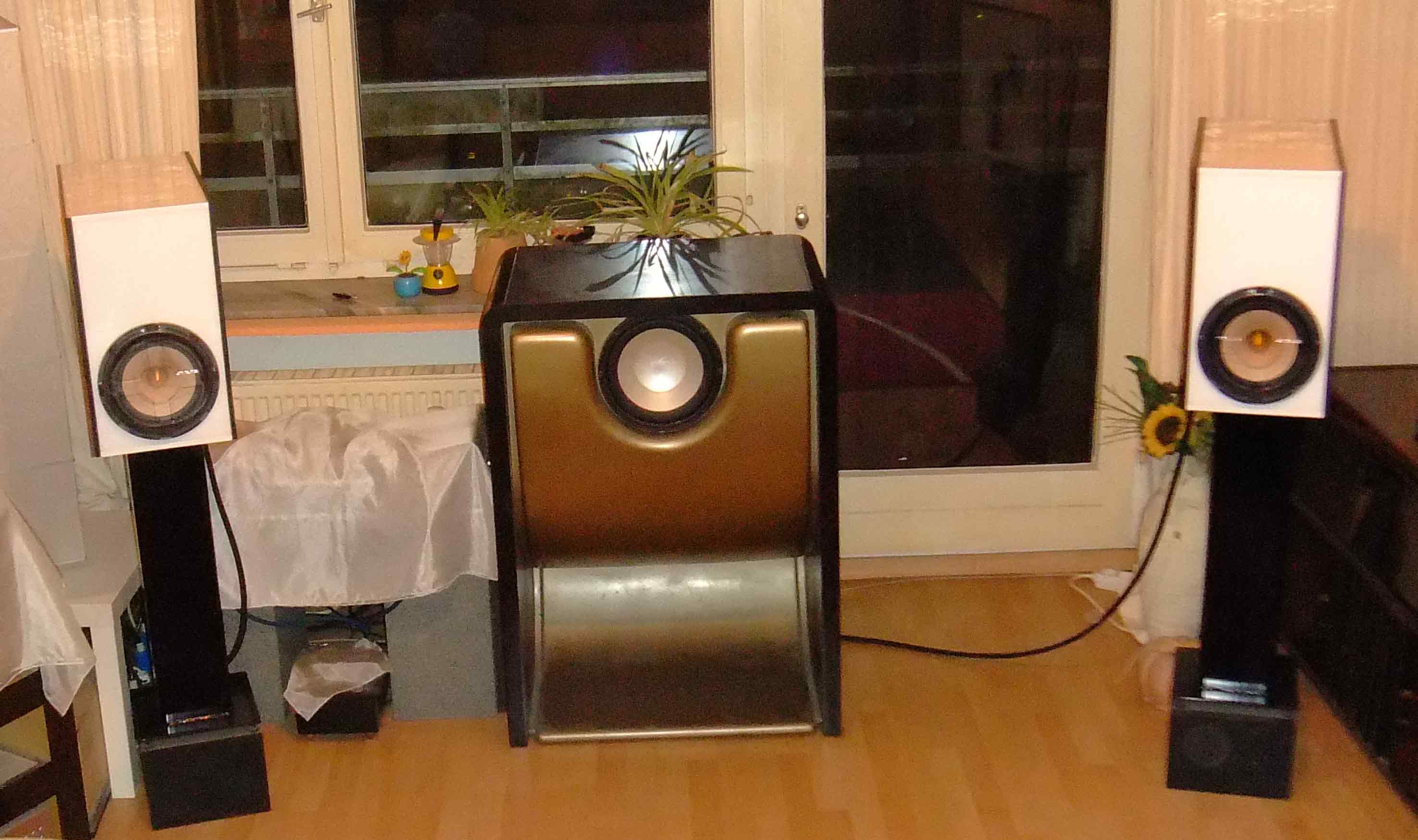

hello,
look my HP a lot of horns for the 1772,
SCHALMEI, SAXOPHON, RDH20, or: Horn, Posaune XL, trumpet
