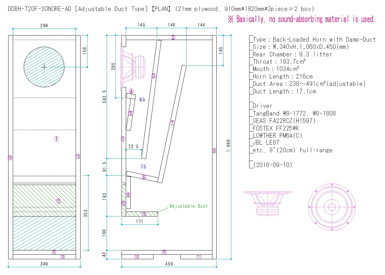

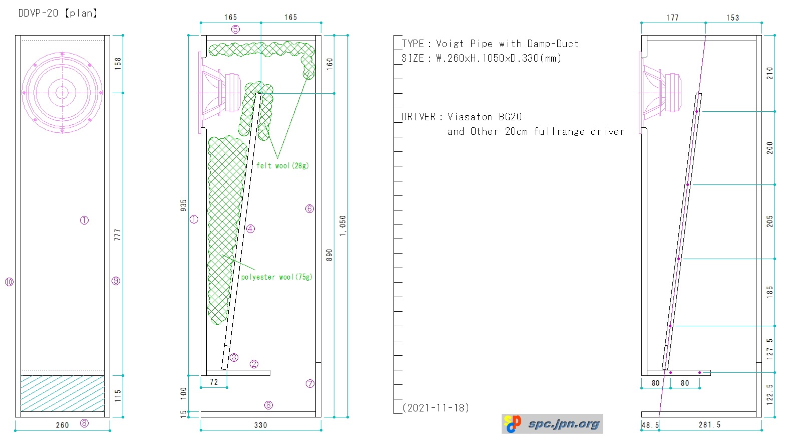

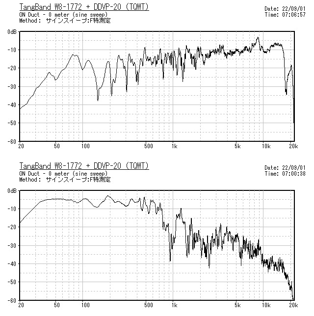

I use W8-1772 installed in TQWT, and the frequency response is rising to the right.
It may be more enjoyable to listen, if it is corrected with a filter or graphic equalizer.
My friend used to have W8-1772 installed in a ducted BH, and it sounded well balanced. Now he is using W8-1808.
W8-1772+TQWT - YouTube

And as others said, the 1772 is not “just drop in a box and listen”.
it will need at least two major notches to be listenable.

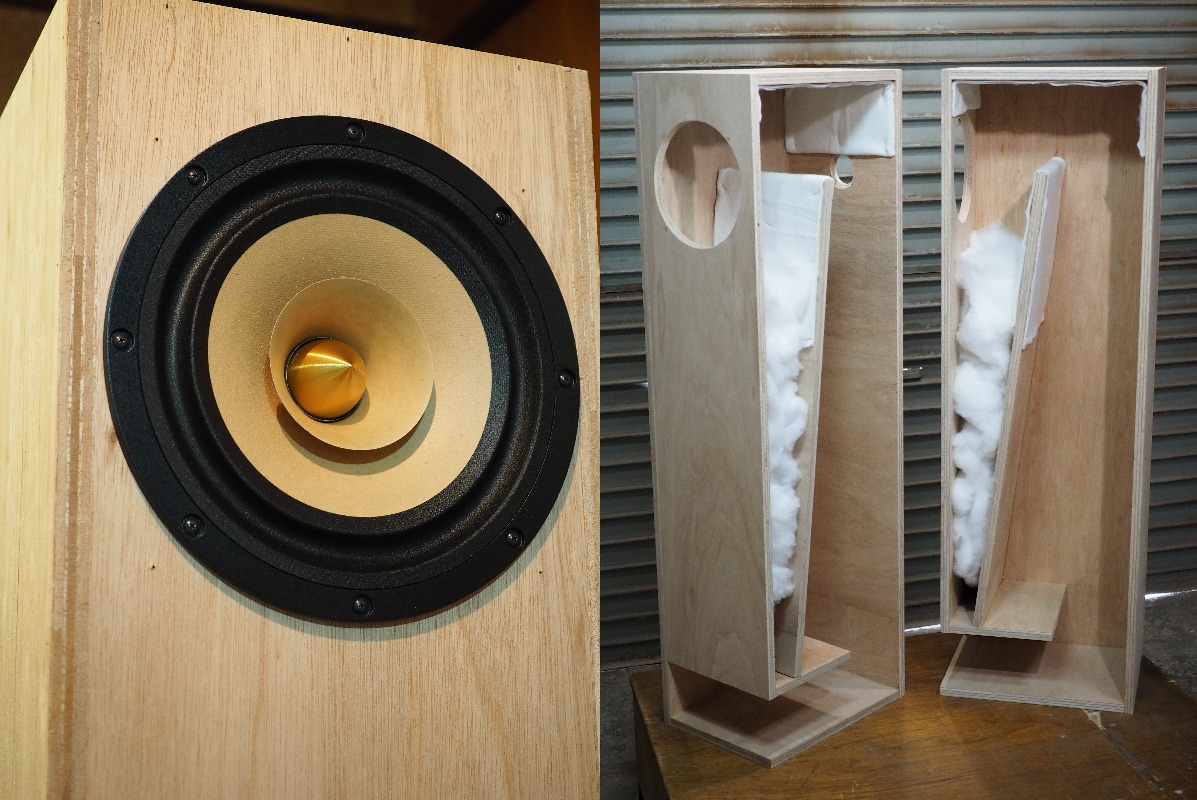

Nandappe, those don’t look like they have much mass loading
Dear Dave,
My box is maybe Low Mass-Loaded Voigt Pipe.
I like less sound absorbing material, but more is better when using W8-1772.

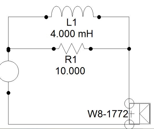

yea, with the climb of the 1772, didn't bob brines have about 10db of baffle step ?
I think larry's (10" x 10" x 44") has 8db (4mH + 10ohm).

from bob brines
"No, it is the 90dB at 100Hz minus the baffle step. Now you see where the 8dB BSC comes from. The ||RC filter tames the high end rising response. So....
The W8-1772 is an 87dB driver if you want a balanced bass and midrange."
Can't help you with the vertical standing waves.
1129 / [(44” / 12”) x 2] = 153hz
from bob brines
