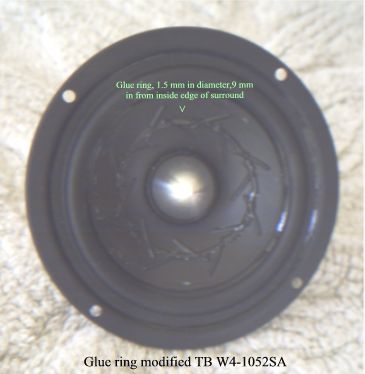

MarkMcK's mods don't seem to be on his website anymore, but i am interested in trying them out also. I was curious as to why the Onken calc wasn't working with these drivers since their parameters are similar to FR125s and Fe127s, so I asked Dave about the MiniOnkens and Fonkens. So i have decided to build a pair of Onken style enclosures as well. I've been doing some designing and if all goes well, i will try to get to the workshop this weekend.

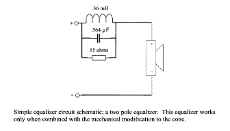

So, are you guys having good luck without any type of filter at all?
I wanted to build a mini me clone for portable audio with a $30 tamp, powered with just batteries.
It sounds like you guys might have a bit of trouble with treble break up. How bad is it, or has anyone made a filter to deal with it?
I've never modified a driver, and the directions to get 20K Hz out of these guys seem to be busted.

I'm running some without correction circuits or cone mods. Once broken in they sound great overall. I would like to try the mods but can no longer find any info on it. From a sound aspect I can't hear any significant peaks in the responce as the charts indicate. I have heard them break up 3 times(Reproducing piano) and they have been listened to a lot.
I'm have not tried the mod, but would like to. I have been pretty unimpressed with these drivers. The bass is very good, but other than that, I don't think these are particularly good. I am used to the forwardness of the Fostex drivers and this driver cannot offer what I'm looking for. The sparkle in music is gone. John Mayer doesn't seem like he is sitting right infront of me, it sounds like he is 5+ meters back. Not sure about the circuit, but can definately try the cone mod. The circuit, I don't how that would work since I have wired the drivers in series. I find that I hear the distortion cause be the cone material quite often. When this happens I usually end up swearing at these speakers. These were in my dorm room and I was having a lot of trouble the past 2 months or so with audio equipment problems.

Re: More info W4-1052SA
All the pics are missing, and it didn't have the .zip extension.
For the use I have, I probably won't bother, but others might want/need the info.
tommyo said:Here is the correct file

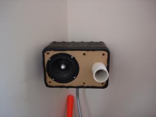

Wow, it's nice living so close to parts express.
I ordered a pair and a t-amp yesterday. I got the stuff in today.
I wanted to hear what they would sound like, and I'm already working on a project, and a little sick and tired of MDF at the moment.
I stuck then in boxes for Blows 101s and they sound freaken great!!! I think these drivers and the t-amp were made for each other. BTW, I'm just running off of batteries.
I can't wait to see what they will sound like once broken in.
I wouldn't go so far as to recommend the Bose 101s boxes as being optimal, but if your in a hurry, and just want some portable audio like I did, then I think they can be found used on e-bay for around $20. It might just be worth it for the boxes. They are nice and rugged and work rather well. It's going to take a LOT of motivation for me to go out of my way to make custom boxes, cause I like the way they sound as is.

Well, I played with win ISD a little and I'm going to make a new baffle for it.
I modeled the blows 101s box. Not 100% optimal, but with a 6" port (it will stick about 2") it will be tunned to 57hz. The graph shows 70hz -3db. I think that is more realistic. It will have a very mild mid range peak, but for my overall goal to beat the sound quality of any portable boom box, or desk system, I've already succeeded in that.
