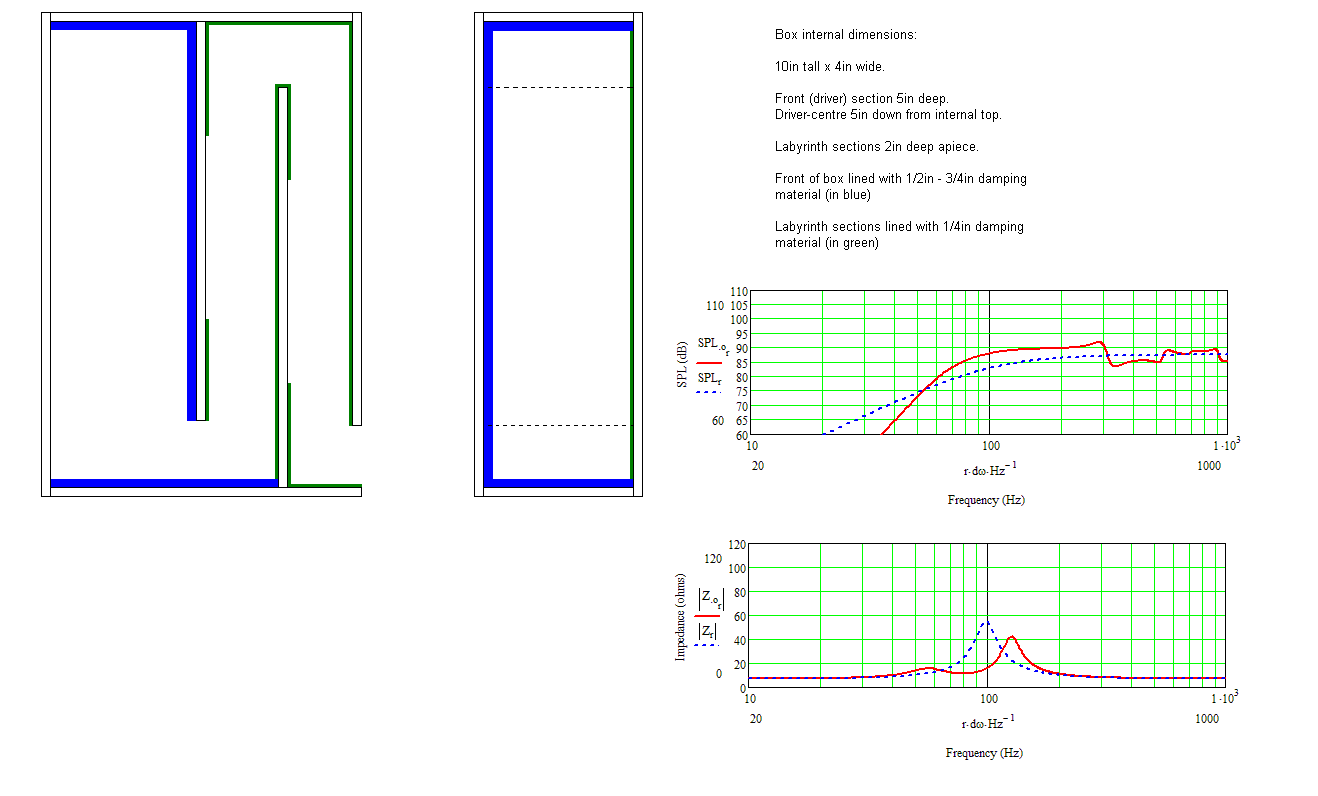

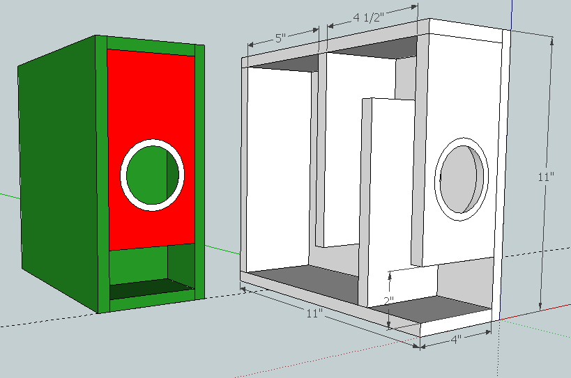

TB W3-881SI, which cabinet?
Spot on. 🙂
I should stress, this box is not a bass monster (these things are relative of course -we're talking about 3in wideband drivers) -I wasn't aiming for maximum extension, but to provide something closer to a TL in terms of the load presented. If used near a front wall, you should get a reasonably balanced response down to about 80Hz since it does provide some modest broadband gain.
thanks for your help. I may have to experiment with damping materials, I have some polyfil etc... I understand bass is limited due to size.
