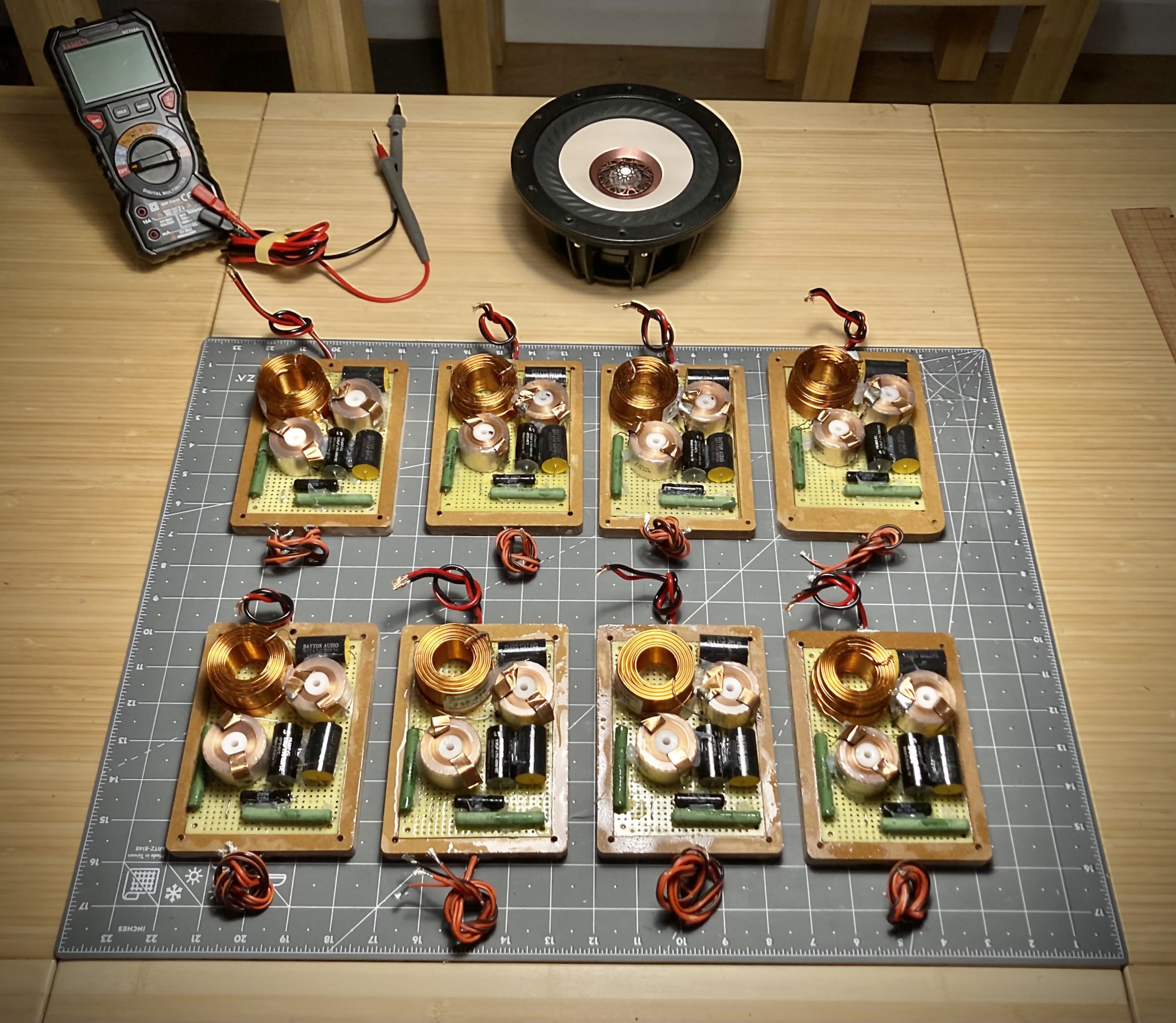

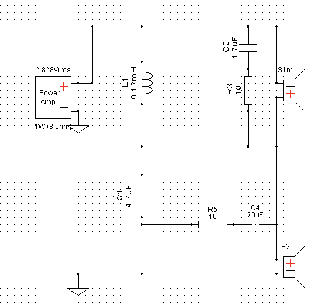

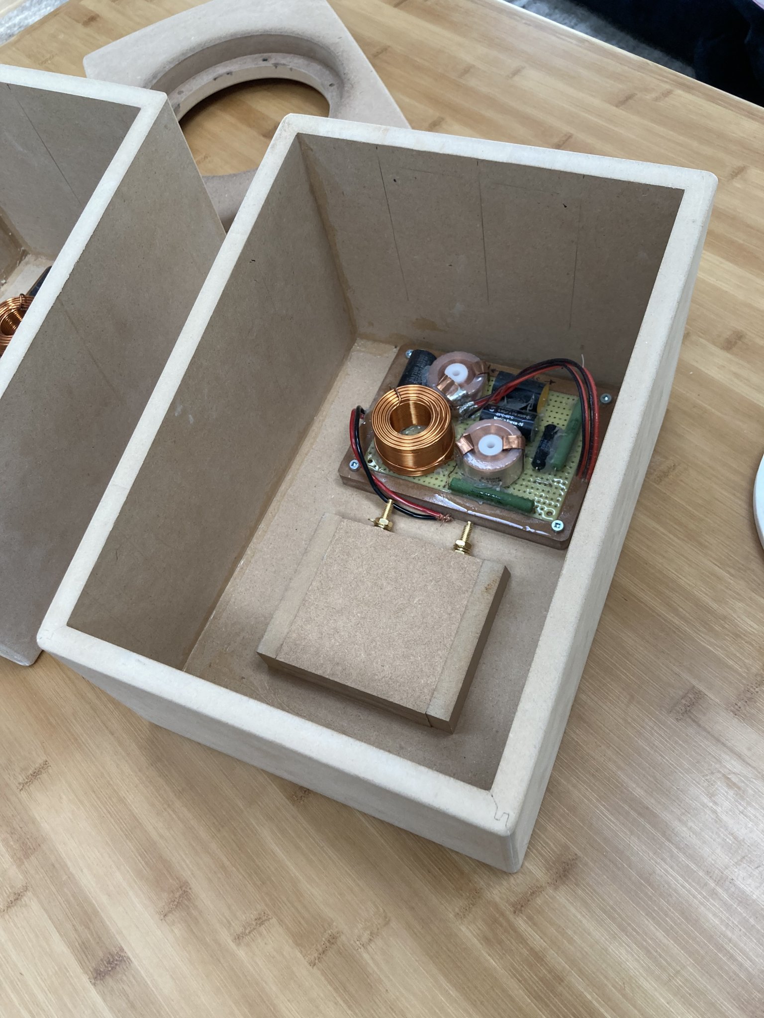

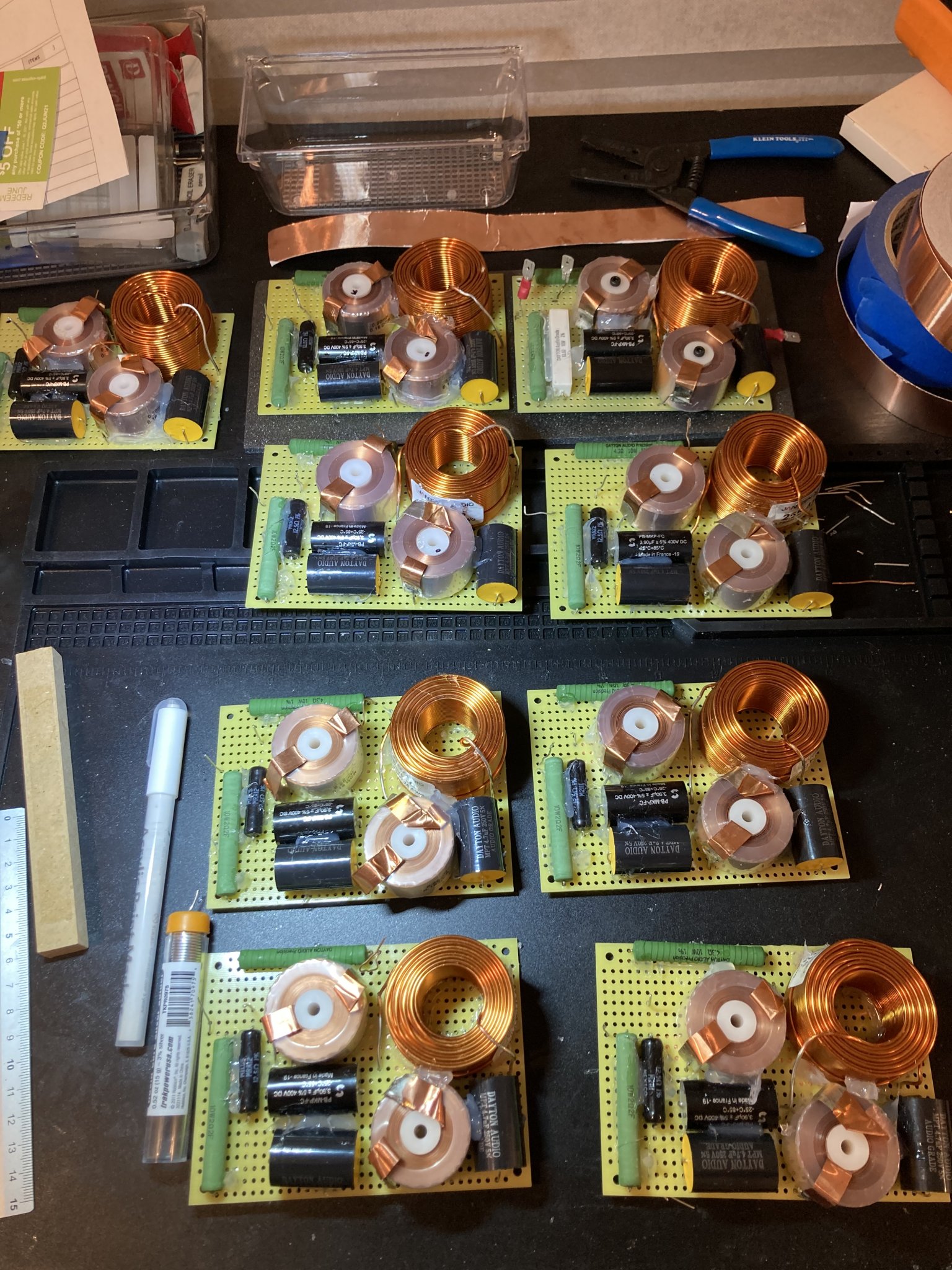

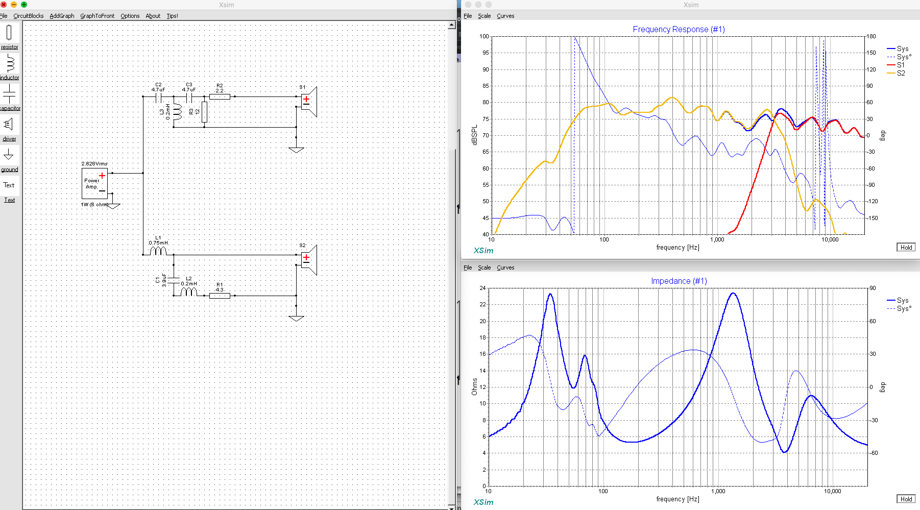

I was not happy with the TB suggested xover, so I decided to try my own.
I made 8 of these for 4 surrounds and 4 heights for a HT system I'm building for a client.
I like the sound a lot better now: there was a harshness around 5khz that took me a while to get rid of: luckily the bamboo cone performs quite well at higher frequencies: drivers are cut at 3.5Khz.

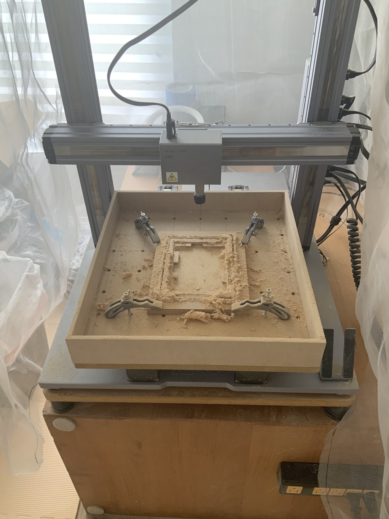

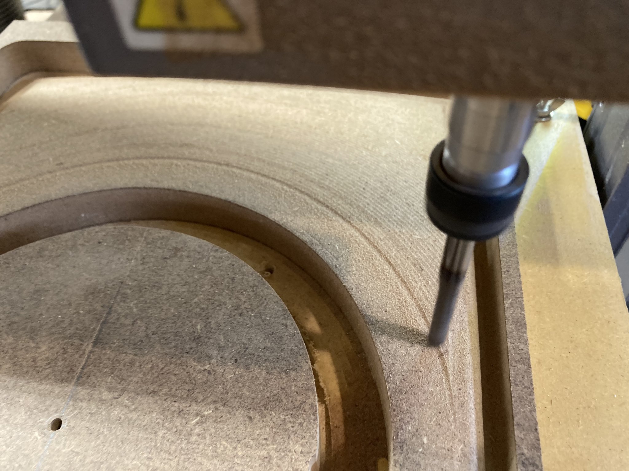

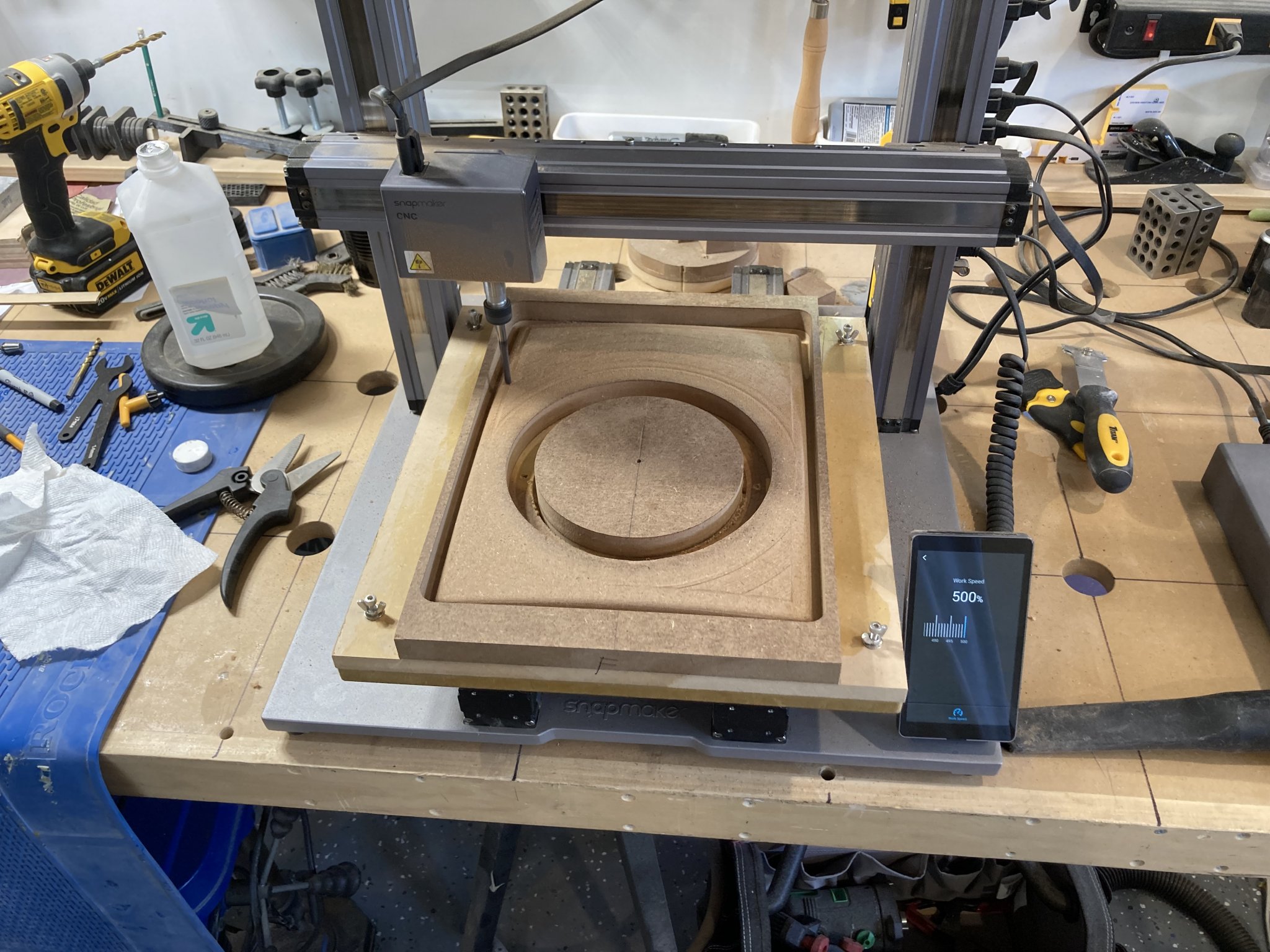

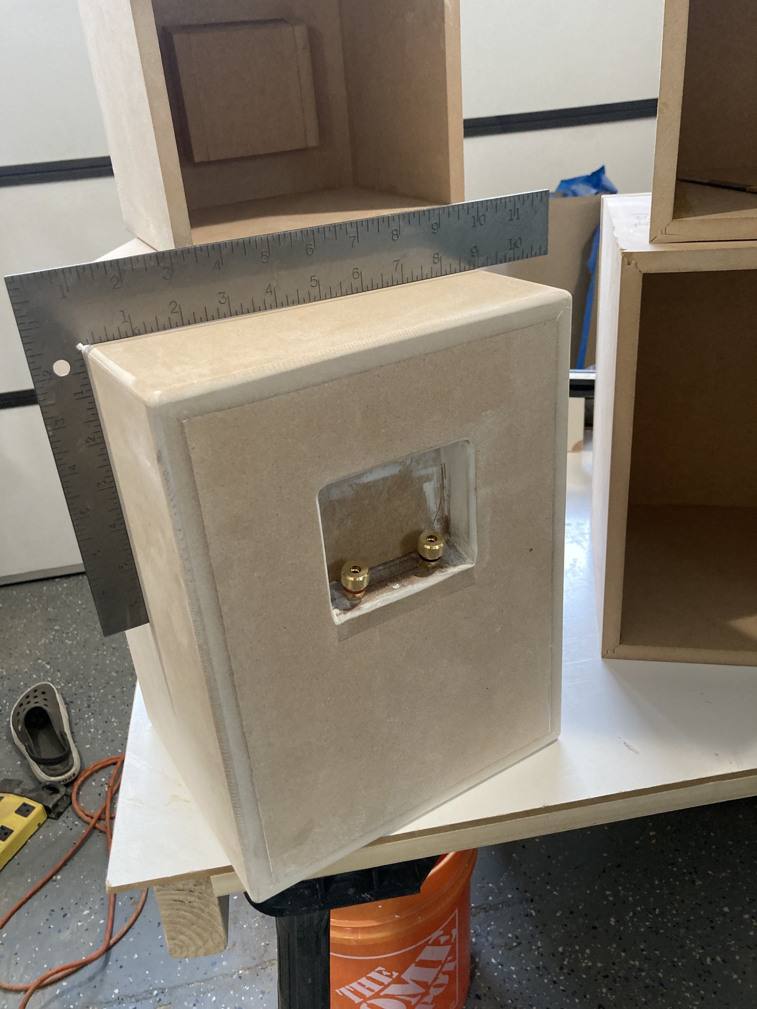

I decided early on that I would 3d print the baffles with PETG: I wish I knew better... The quite expensive Snapmaker cannot print such a large model with PETG. However the Snapmaker can also do CNC, which was my contingency plan, and the baffles came out great that way. I may paint them today.
The last pic is a CG render illustrating what we are aiming for: the side surrounds will "swivel" down from the ceiling to meet demanding WAF.

Hey perceval I've been following this thread since 2020 and it has been a huge help in my speaker building journey so far. It sounds like you physically built this crossover already beyond the schematics, would you be willing to share a picture of what it ended up looking like? This is my second crossover so I am very novice and I would love to be able to copy your layout. I'm using Parts Express to source my parts and it looks like the only 4.7 uF foil capacitor they have is by Jantzen Audio and is 86 dollars a pop. Should I be expecting do drop big money like this on a single capacitor or is there an alternative that is obvious to someone more experienced. Thanks again for putting out just about the only thread on the W6-2313 Tang Band crossovers. If I get all of my questions answered then this will help me finish my very first speaker/crossover build!! I'm really looking forward to the enclosure build part of this process, i've got a carpentry background and electrical engineering is very intimidating. Look forward to hearing from you!

I did build two XO and listened to them in prototype enclosures. The XO is a mess due to using Wago connectors, so a picture would not help. I do plan to do a serious build of them, but the timing is a bit off. We just sold our house! Now I have 1.5 months to clean up and find another temporary place, as I will also be spending the summer away.

Here's a page of caps, you don't need to spend $86 if you don't want to! 🙂
https://www.parts-express.com/speak...ylene-crossover-capacitors/capacitance/4.7-uF
You could always use a film cap in parallel by-pass, like a small 0.1uF to get the sparkle of the film cap, using the metalized cap for the value. That's the easy way to save money, and still get good sound.

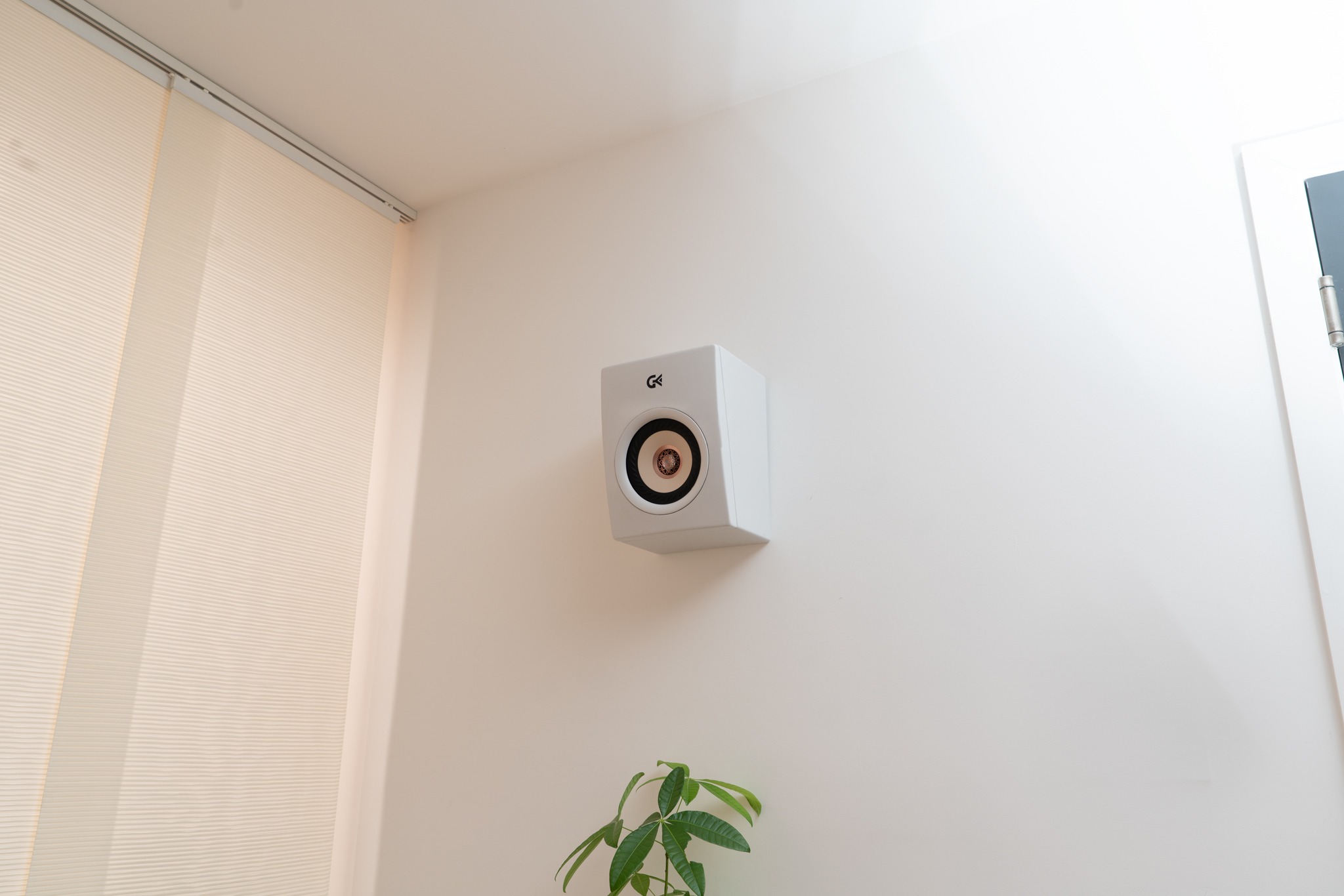

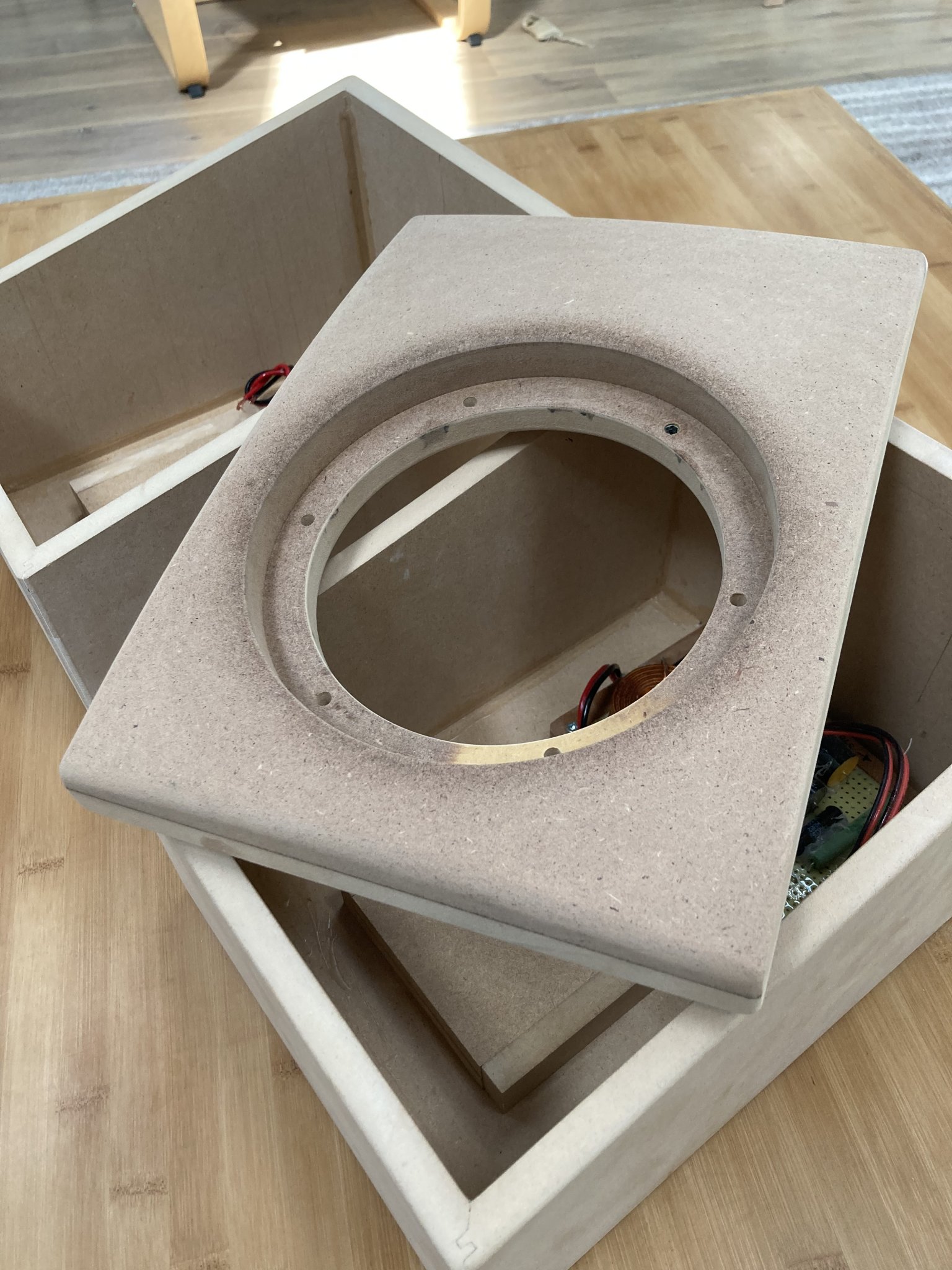

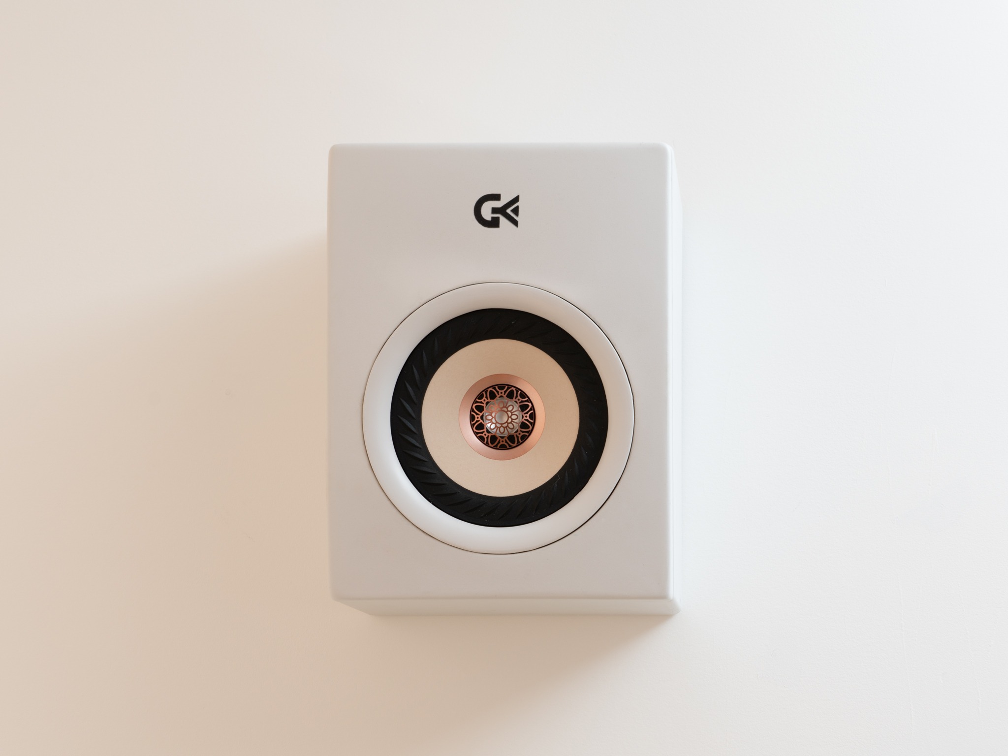

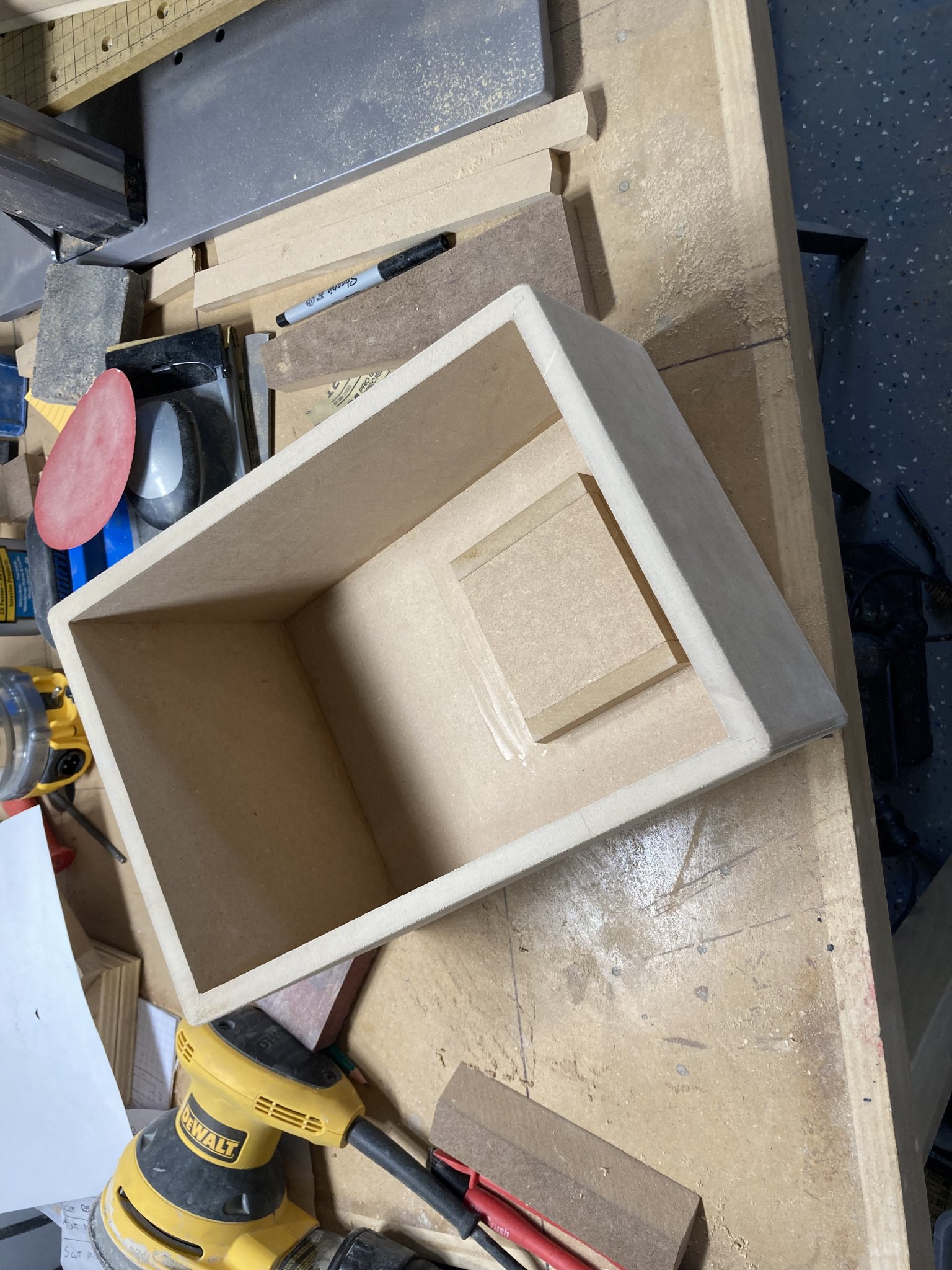

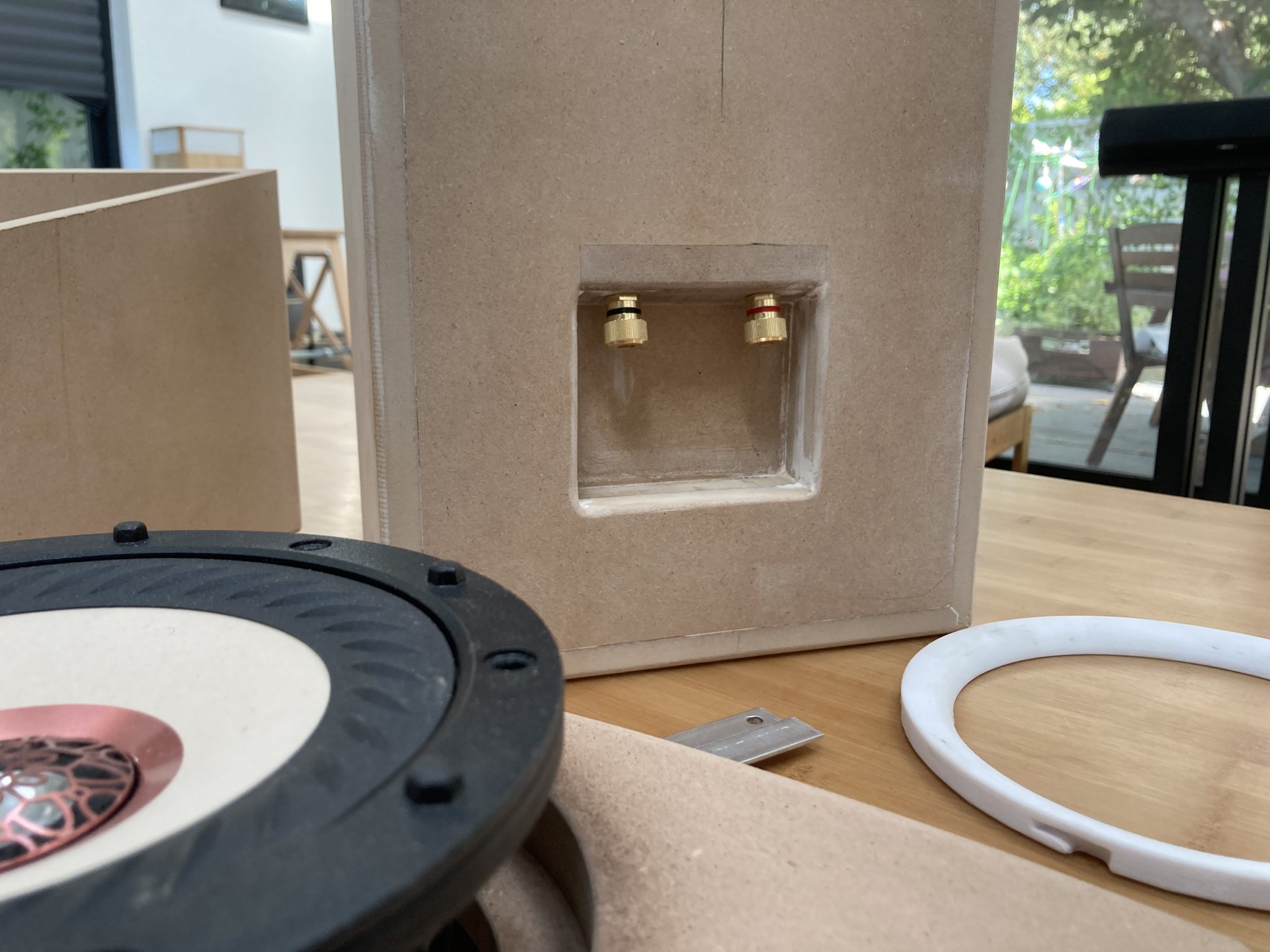

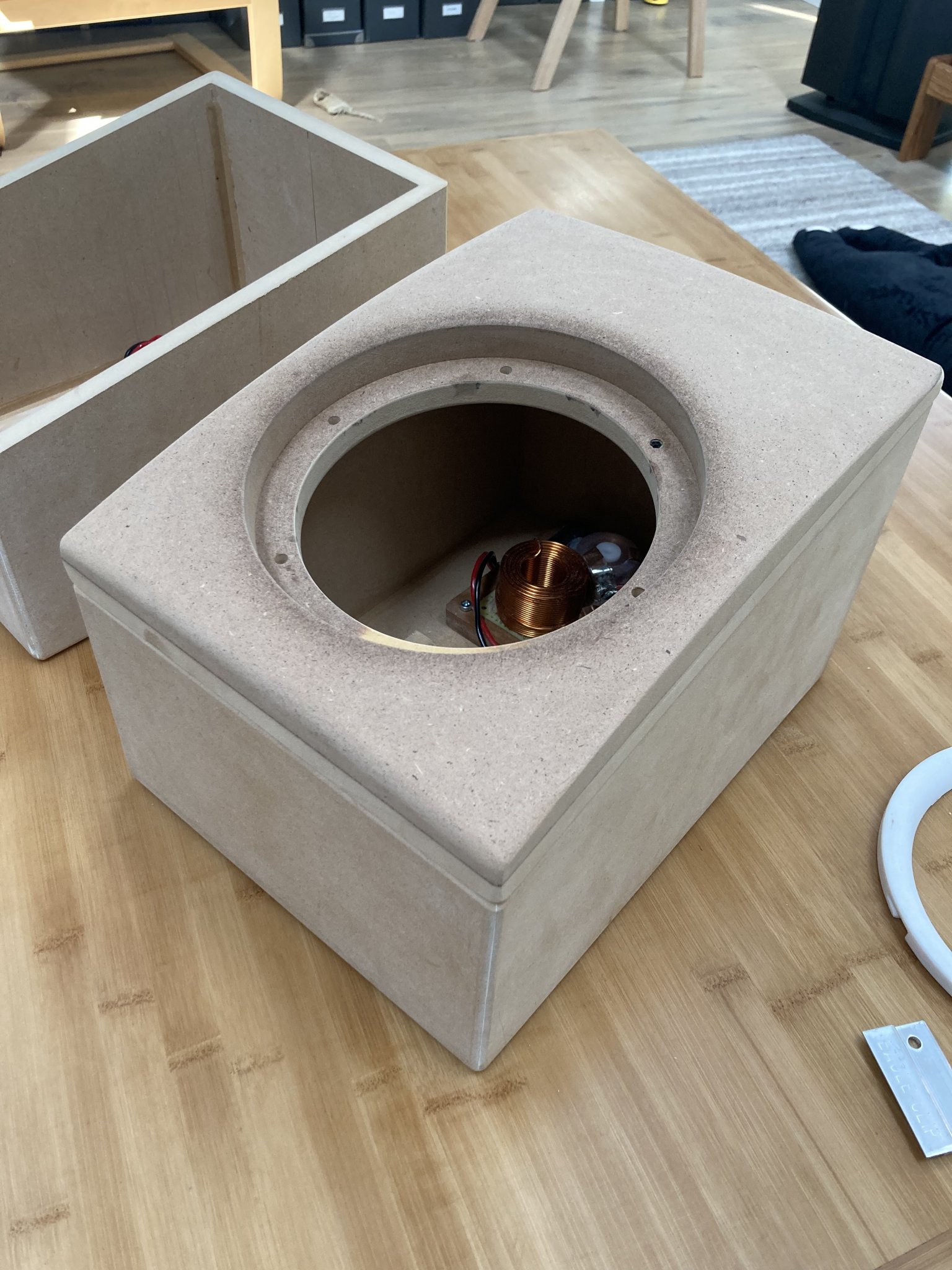

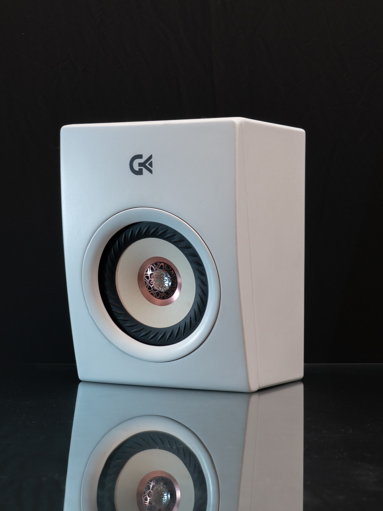

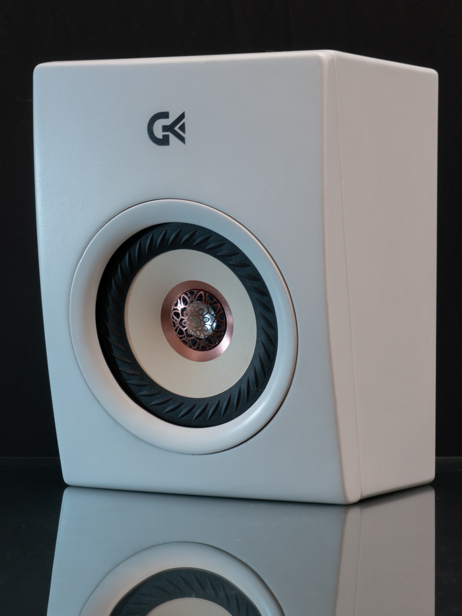

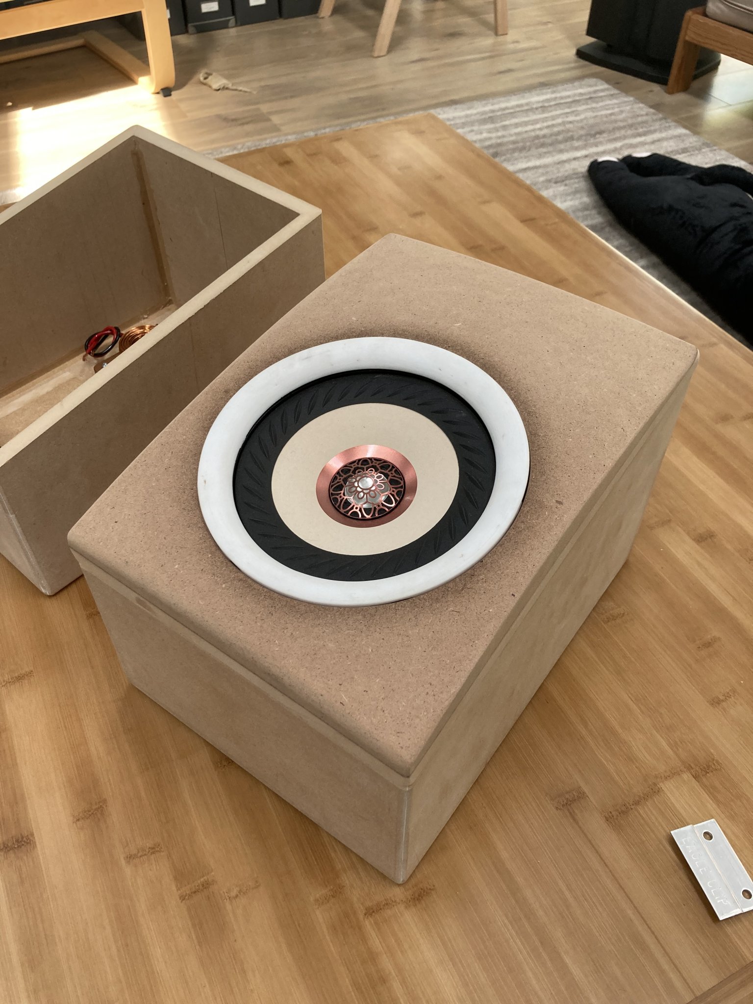

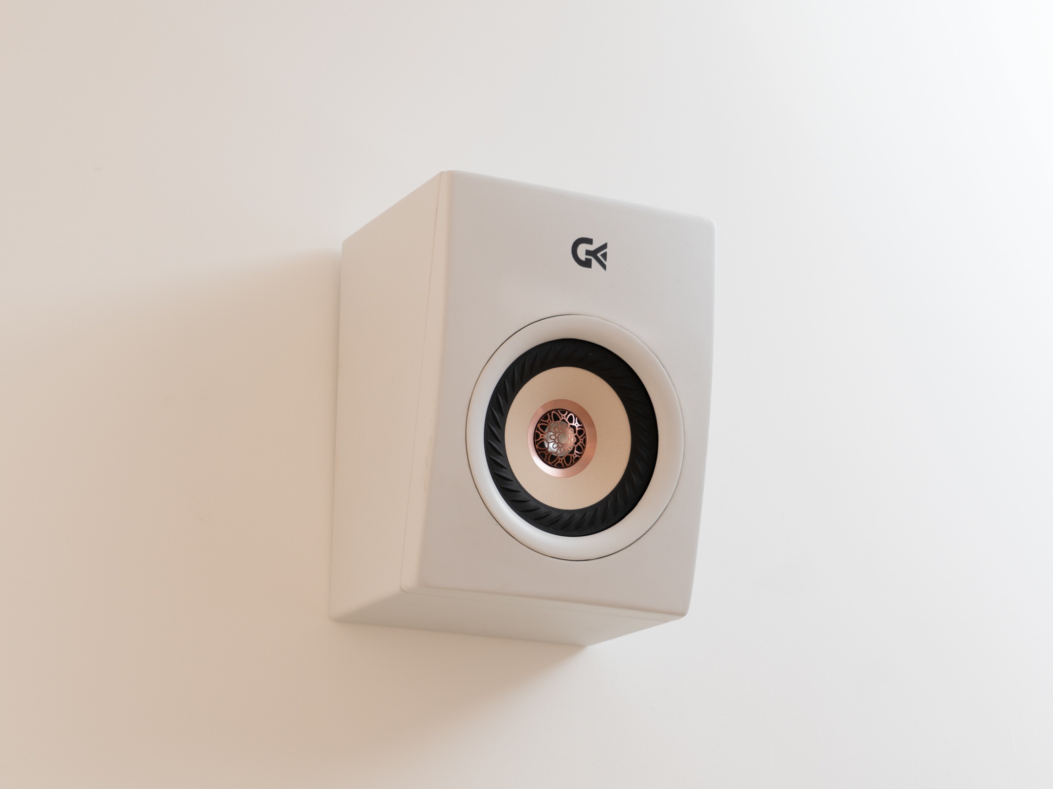

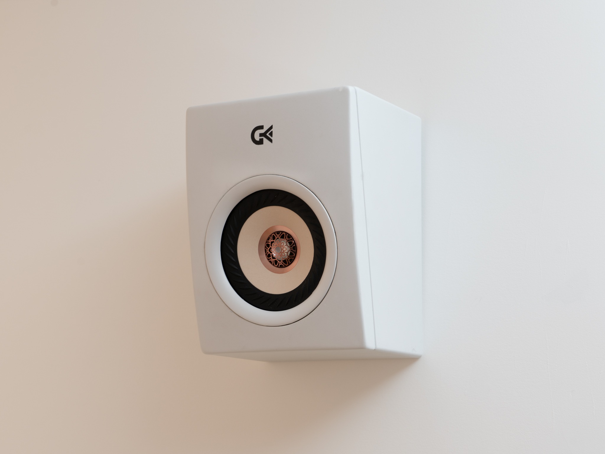

Here are the finished TB surround speakers, ready to be installed on the wall.
The cabinet is made of fiber resin reinforced MDF, with a baffle made of a MDF sandwich carved with a cnc and coated with uv resin before finish.
Pretty happy within the result: the only issue is a boomy peak caused by the proximity to the wall. That is expected and easily corrected later with EQ.

Thank you! The ring is 3D printed with a UV resin printer, and I mounted it on the baffle with a strong double side tape. Originally it was supposed to be mounted with a bayonet system, but when I failed to 3d print the baffle I had to scrap that. I did test it for spurious resonances and it seems ok (for a surround): but we are doing science here so I’m sure you want to see responses… I got to do two more so if you are interested I’ll post responses with and without the ring at various angles. That said, the ring is there mostly to satisfy WAF and only secondly to minimize diffractions to improve imaging.Very nicely done! What is the ring trim material made of, and how is it mounted/attached?
Yes, it is done very very well, looks commercially made 🙂
Seeing some responses with and without the 3D ring is also very interesting. Good job
